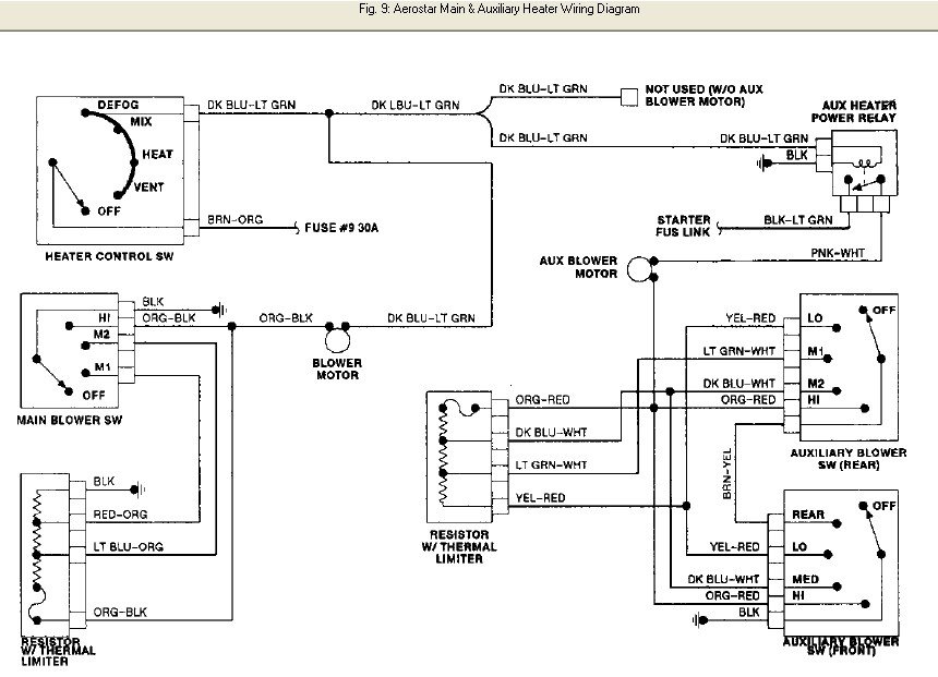

Fan works no power going to fan checked. Resistor limiter could it starter fuse link or aux power relay. Where the located. I have a diagram. Where should I start test back on power.

I would check for power at the aux blower motor relay.

Where the aux fan relay be located

I found the relay in the back and was burnt out
