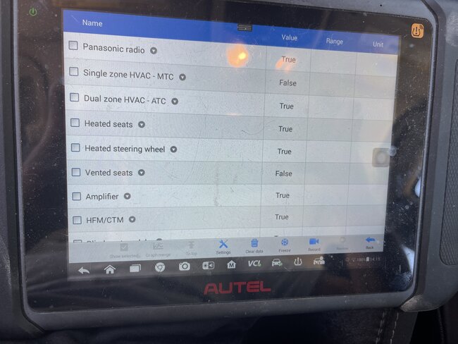

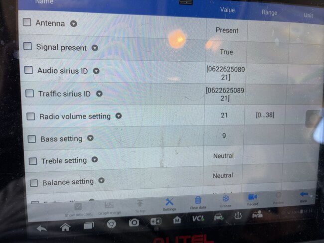

BHAMDOC1973
  • 2,007 POSTS
I tested amp and it was fine. But here are some codes and data.
Jun 8, 2024 at 8:20 AM

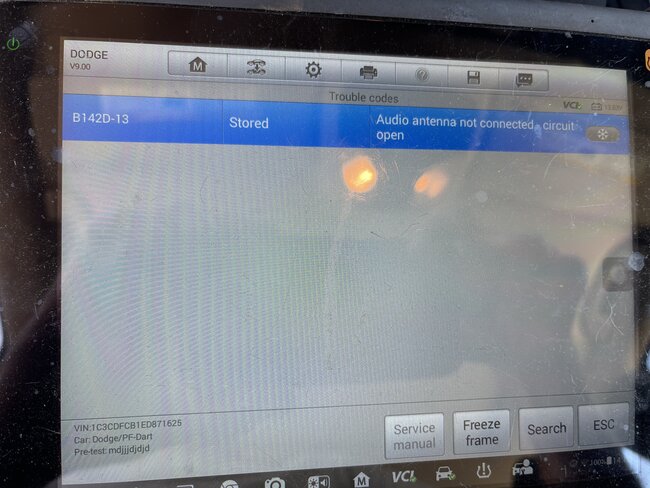

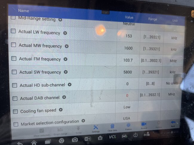

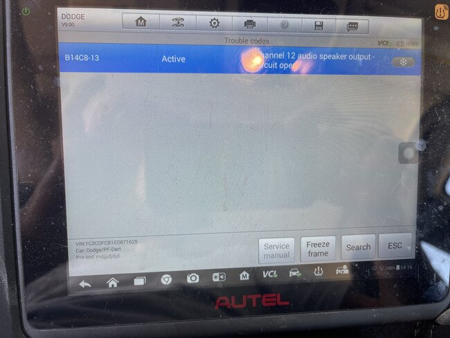

BHAMDOC1973
  • 2,007 POSTS
These codes and data under radio or frequency.
Jun 8, 2024 at 8:23 AM
AL514
  • 5,659 POSTS
okay, pretty interesting the radio sees an open on the antenna, at least we know the issue now, the trouble is finding one of these connectors to test if it's the actual antenna or wiring.
