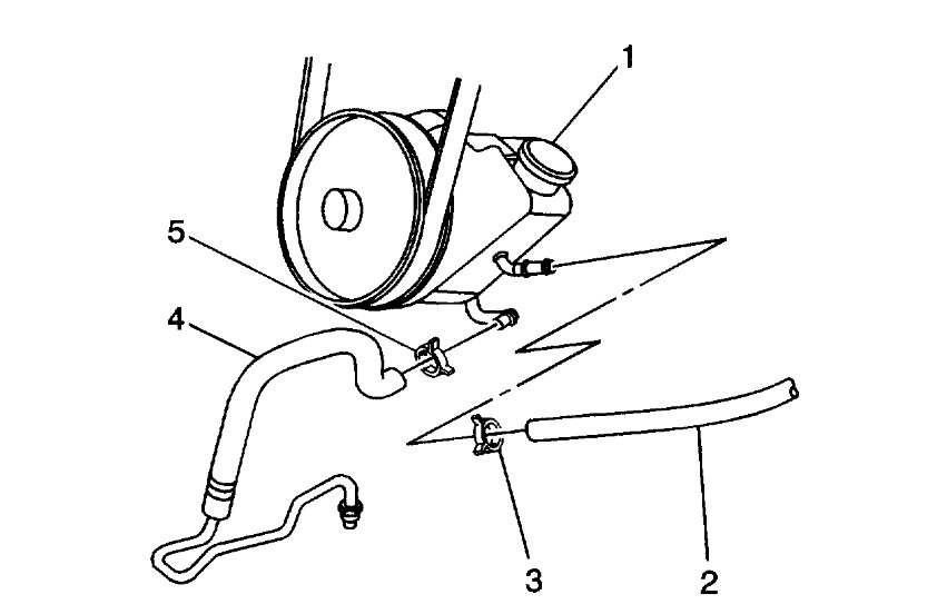

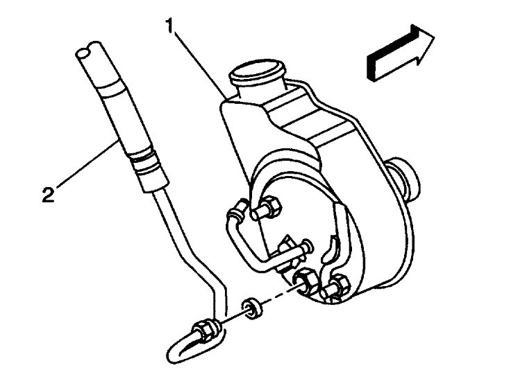

I have no power steering and no brakes. Does the power steering develop the vacuum for the hydraulic assist brake?
Jun 25, 2018 at 2:11 AM
Good morning.
Do you have a diesel engine?
The power steering pump provides pressure to the hydro boost and the steering gear. If the pump fails, you will lose both.
The first thing I would do is to flush the system completely with at least a gallon of fluid to get any debris out of the system. If that does not work, then it may be the pump.

5. Place a drain pan under the vehicle.
6. Remove the power steering pressure hose (2) from the power steering pump from underneath the vehicle.
7. Lower the vehicle.
imageZoom/Print
8. Remove the clamps (3,5) retaining the power steering return hoses to the power steering pump and remove the hoses.
