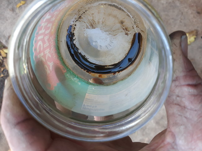

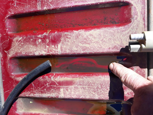

I changed the throttle body and MAF still no power. It will idle but you press the gas there is nothing it has a new alternator putting out 14 volts. battery is good. thank for any help.
Oct 26, 2019 at 4:48 PM
MIKE H R
  • 3,094 POSTS
have you checked the fuel filter? on most cars now a days have it in the gas tank, with the ethenal they have now it could clog up. see if you can hear the fuel pump run when you turn the key on.
Oct 27, 2019 at 1:59 AM
TEXASME1
That's what I come to this morning. I pulled fuel pump it was bad when I blow it out it looked like mud. here pictures of how bad it was. I ordered new fuel pump be here tomorrow. let you know how it goes. thanks
