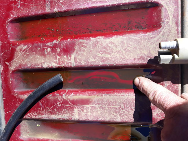

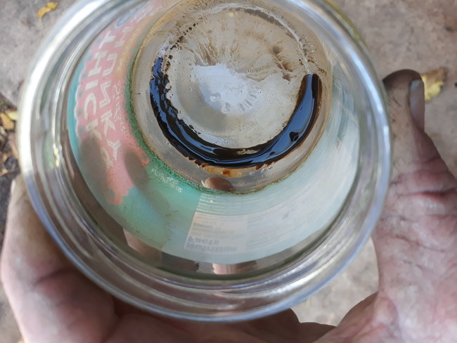

TEXASME1
That's what I come to this morning. I pulled fuel pump it was bad when I blow it out it looked like mud. here pictures of how bad it was. I ordered new fuel pump be here tomorrow. let you know how it goes. thanks
