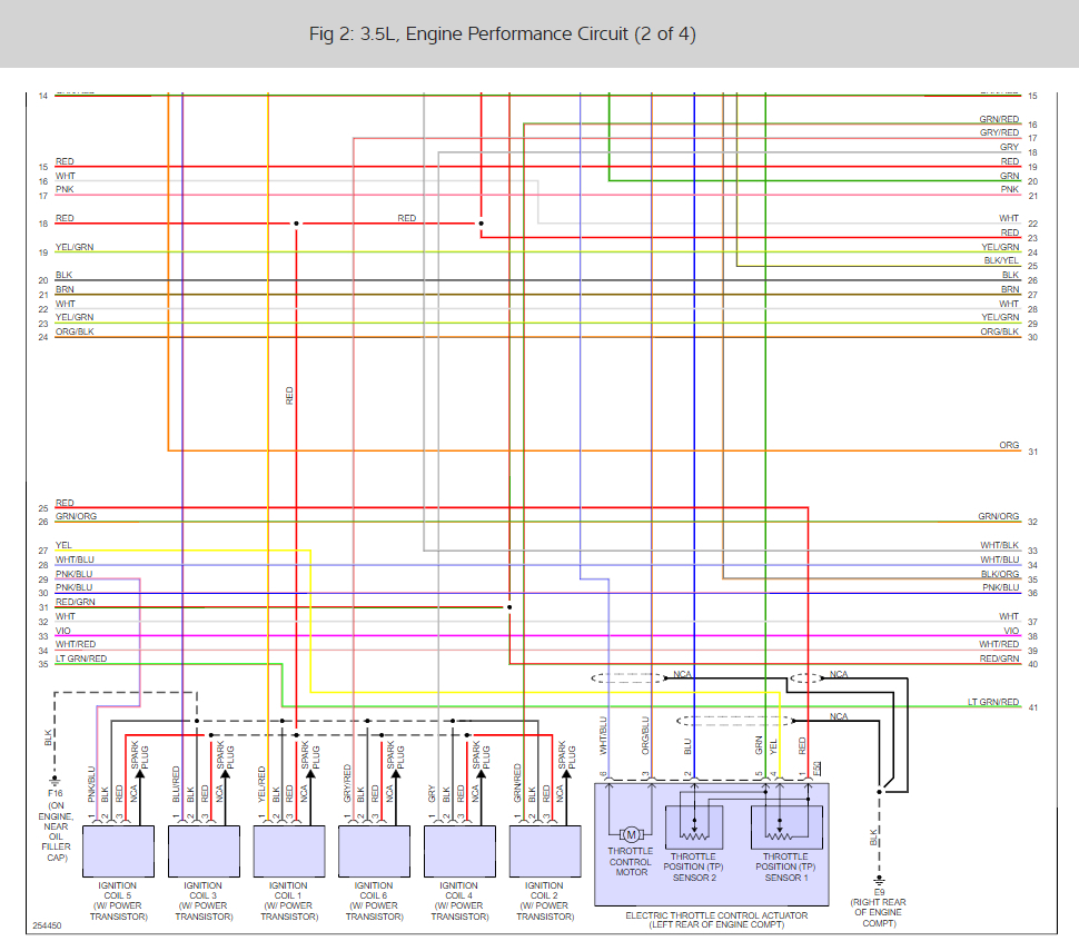

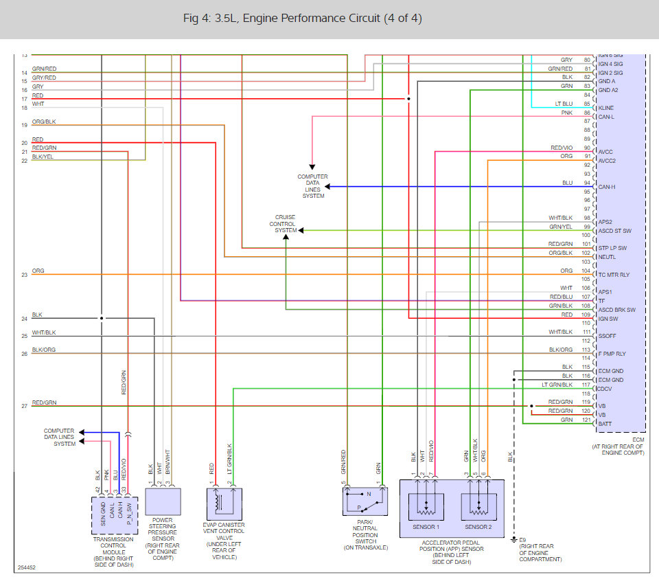

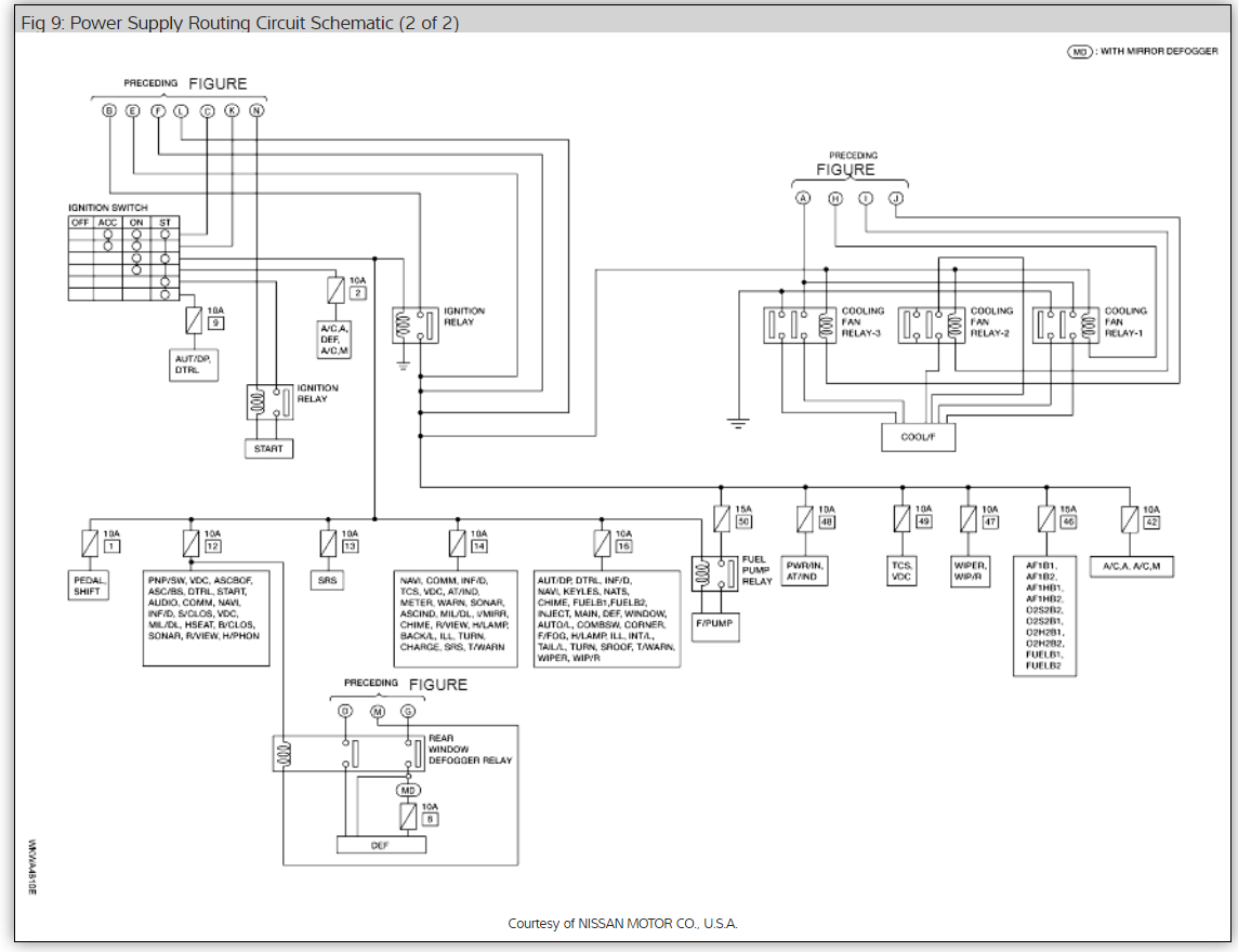

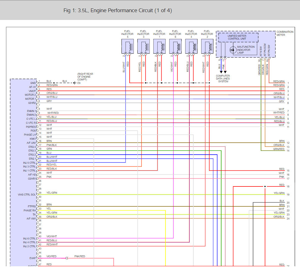

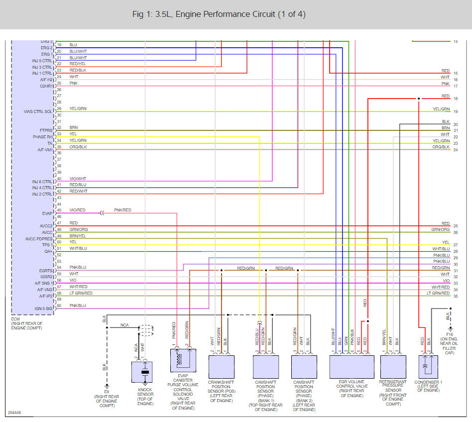

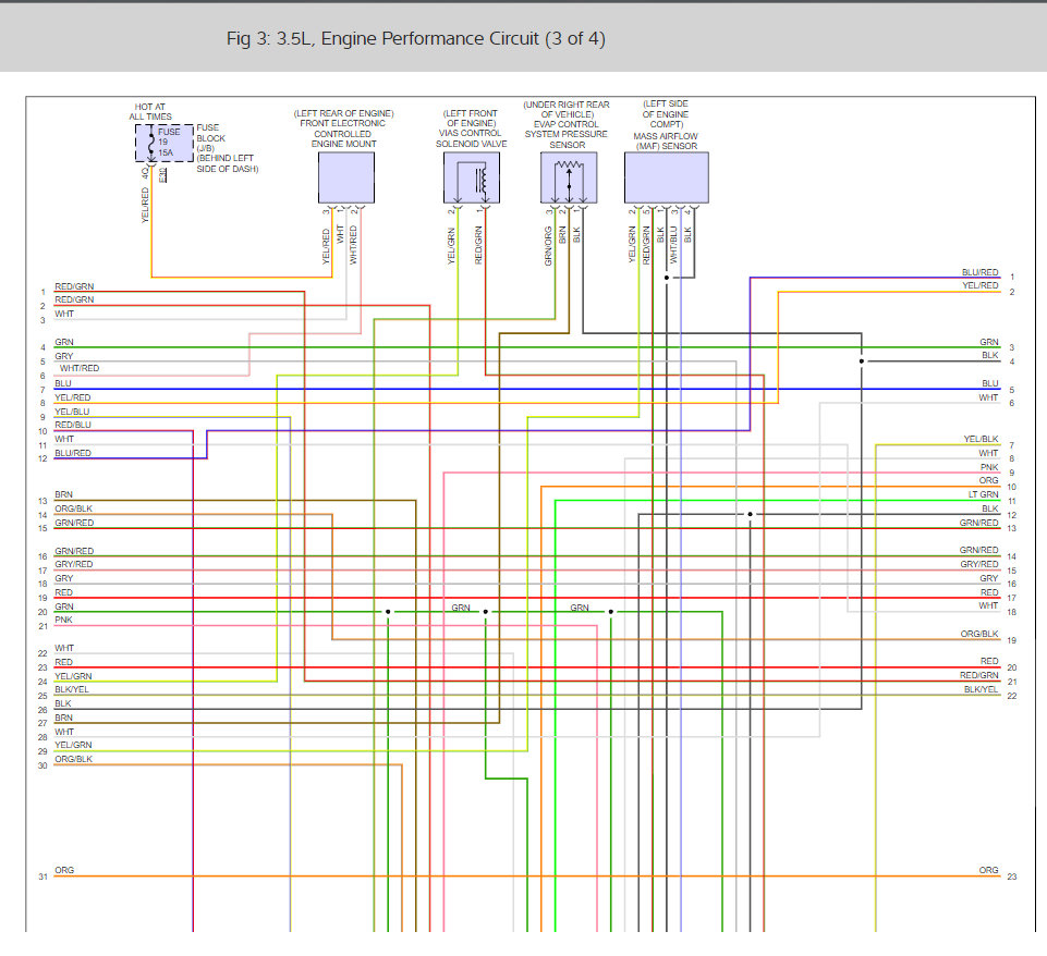

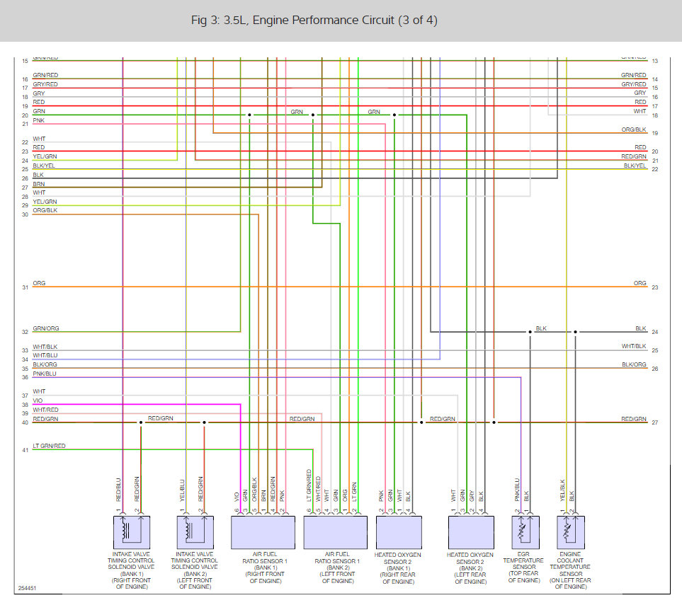

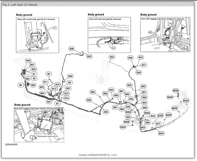

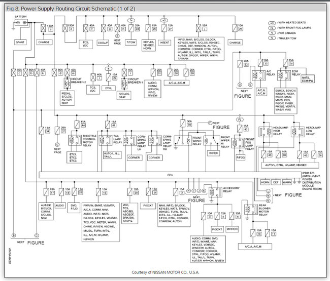

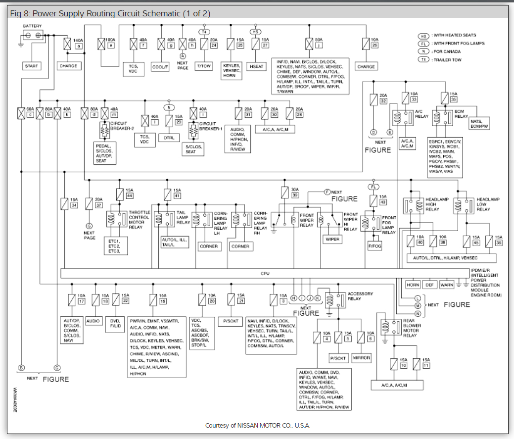

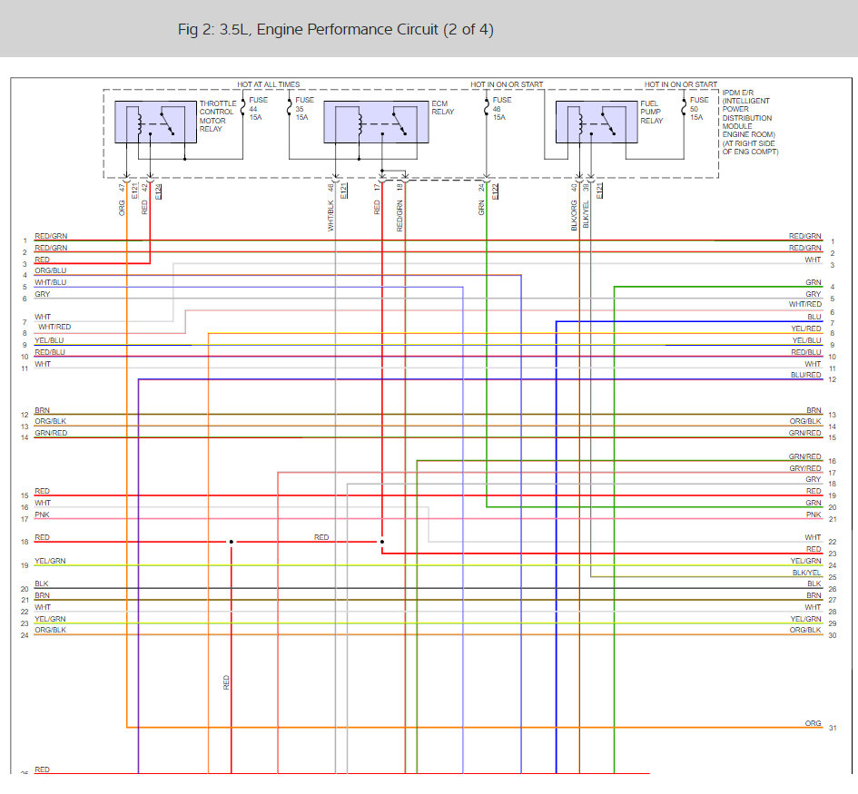

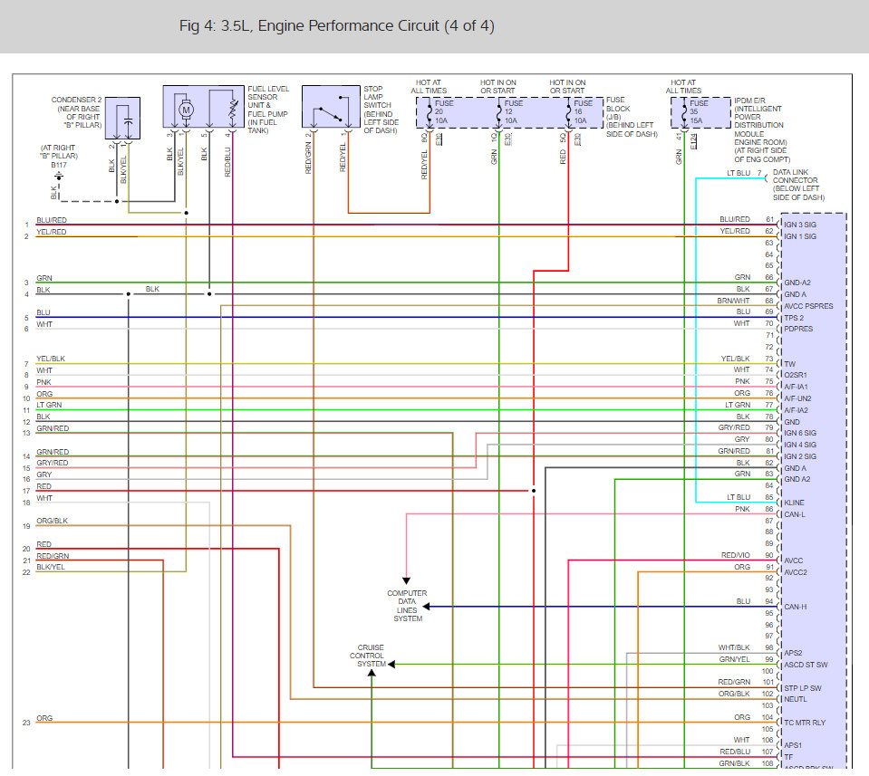

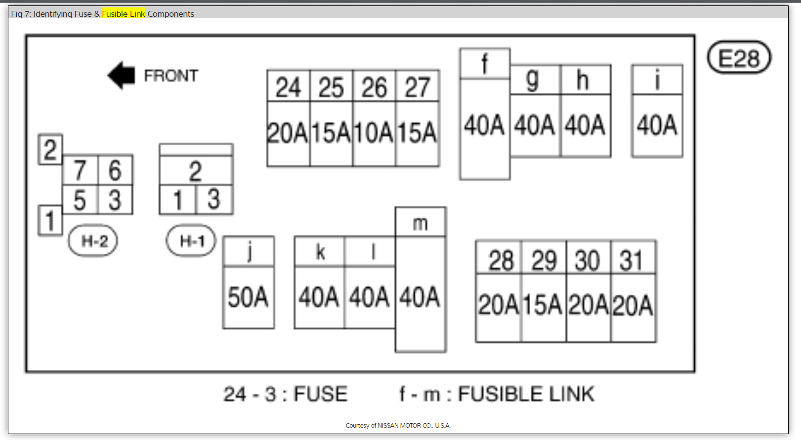

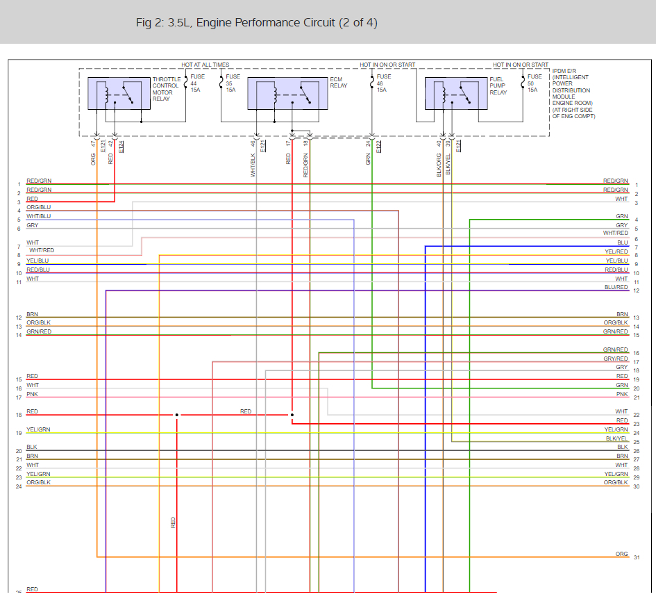

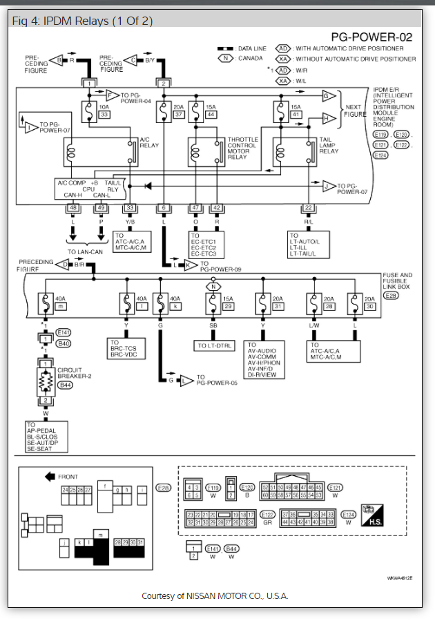

My vehicle is not getting pulse reading on all injectors therefor not starting. Cam's and crank sensor are good. Any ideas or opinions? All fuses are good. Anyway that I can get a wiring diagram of ecm, engine fuse box and fuel injectors?
Sep 29, 2017 at 3:25 AM
  • 55,418 POSTS

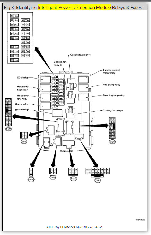

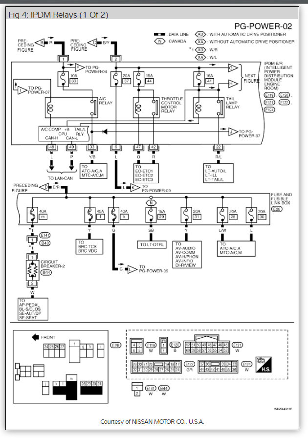

There is an ECM relay I would check along with the fuses.

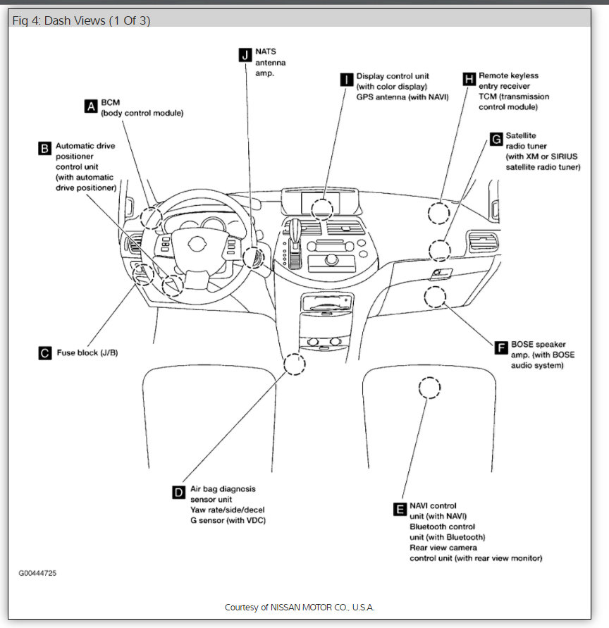

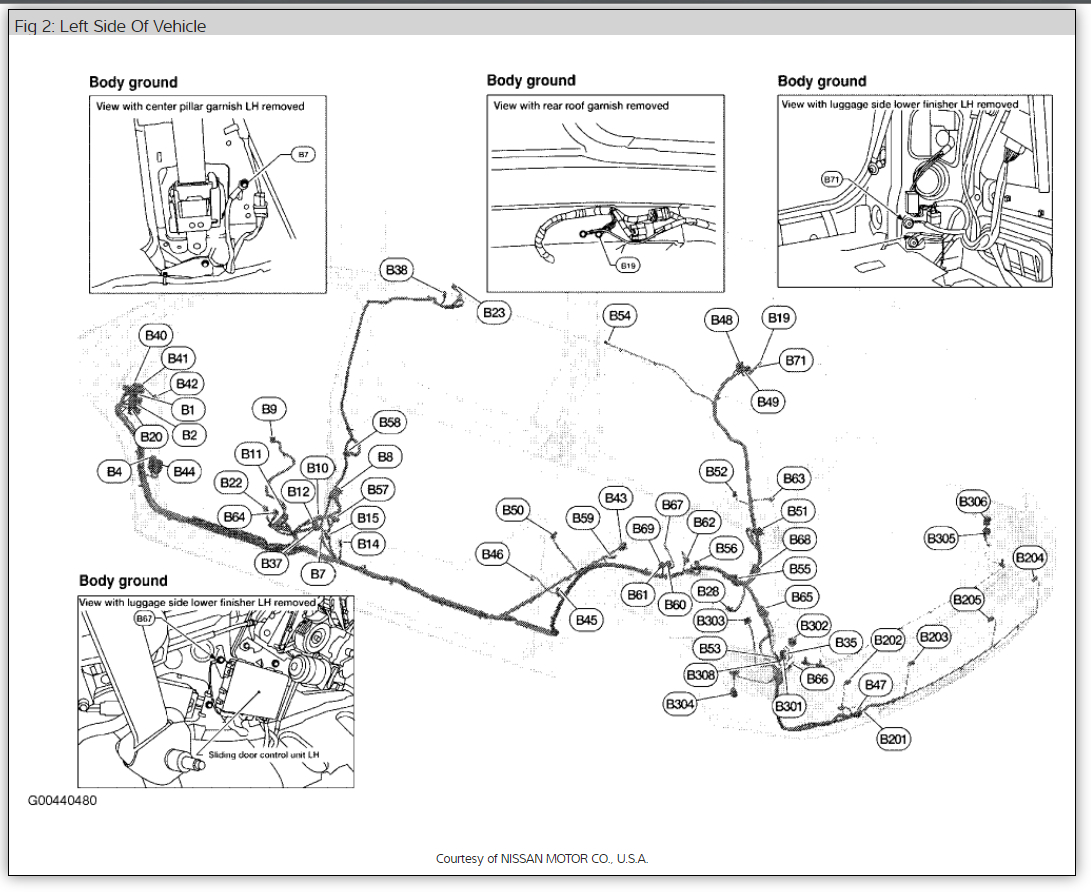

Here are some guides with the diagrams you needed (below) so we can get started testing to fix the problem:
and
Please let us know what happens and upload pictures or videos of the problem.

ecm relay is good but still not getting pulse to injectors
Oct 3, 2017 at 8:41 AM
MECANICO3
  • 32 POSTS

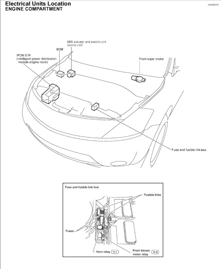

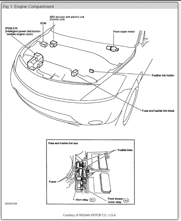

there is voltage on injectors but not getting the pulse on all six injecs.....since i do not possess a diagnostic tool with live data i can not check ECM or why its not sending ground to signal wire......so to me it has to be the Ecm and nothinh else...
Oct 3, 2017 at 8:59 AM
  • 55,418 POSTS
If all of the wiring and connection are good then yep I agree, you will need it programmed here is the location.
Let us know what happens
