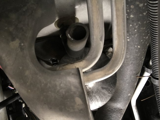

So I ran the truck for 20-30 mins and it formed a puddle underneath and a steady drip. It was coming from the hose in the pic I attached which is off the bottom of what I believe to be the evaporator. Is this just a condensate drain? Could it be more than normal because the coolant system has more water than coolant right now? Once I confirm there is no leak I'm gonna drain it and refill with 50/50. (If I can get the airlift to pull vacuum)

From what I can see that does appear to be just a condensation drain. In the future I'd say don't run the A.C. when checking for a cooling system leak. You could see extra drainage there if its unusually humid where you are. In my opinion, make sure its full and check it for leaks again. If you don't see anything leaking, drive it a few days, cautiously at that, and then check it again. Let us know.
