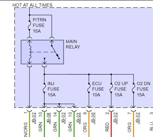

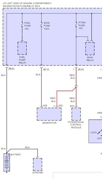

No power to injector fuse box or to main fuse relay.

Check for a blown P/TRN fuse engine room fuse/relay box, located under hood left side.

There is fire in the coil but is not sparking. Please help me find the problem.

What do you mean there is fire "in" the coil? Plus, are there not three coils?
