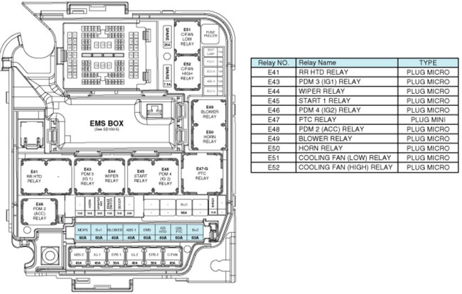

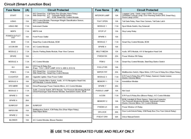

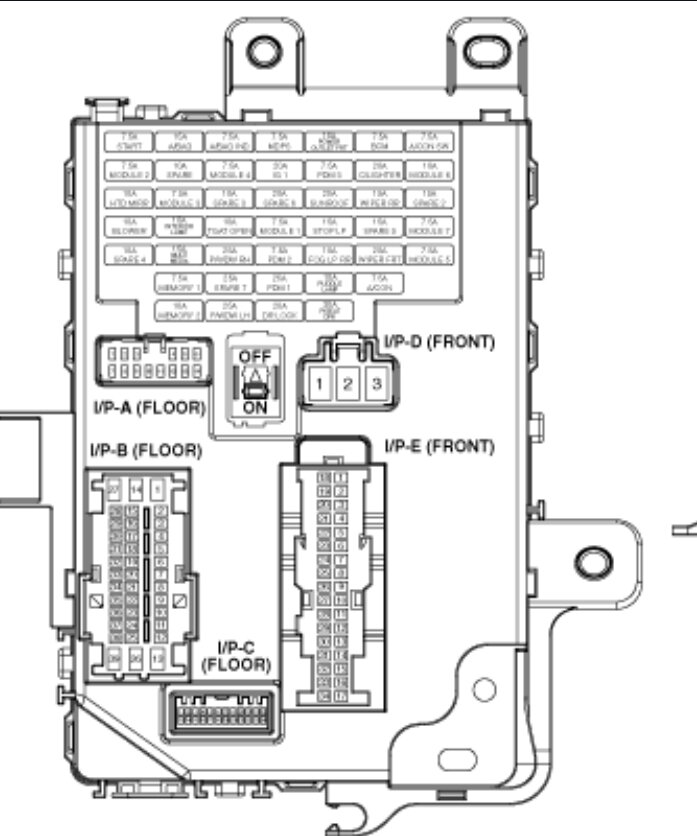

No power windows work on any switch and the door locks don't work on the master switch.
Jul 20, 2023 at 6:27 AM
  • 55,432 POSTS
Chances are the main window switch control module has gone out but to be sure let's check the fuses. here is a guide to help and how to change out the switch:
