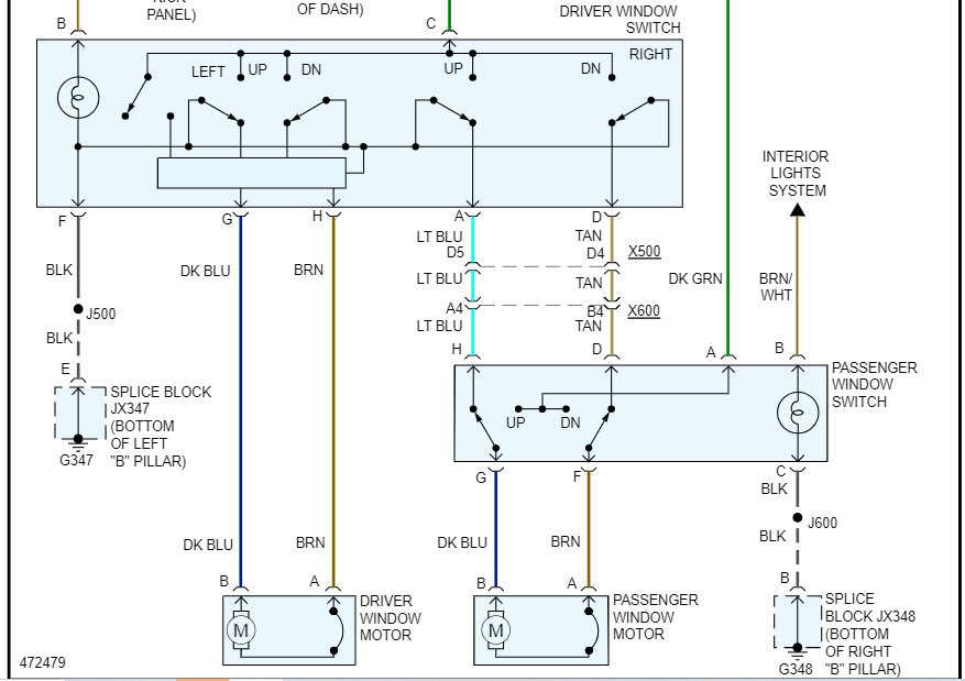

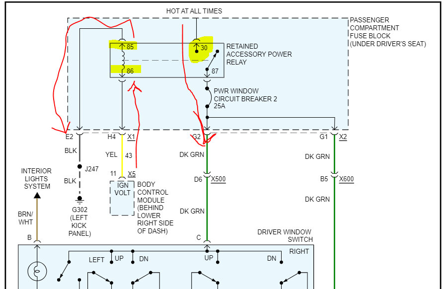

First, I attached the wiring schematic below so that you have a reference. The first thing I noticed is a relay, retained an accessory power relay. We need to check if that is working correctly.
Here is what I need you to do. First, note that in the schematic, each connector pin is numbered. On your relay, the pins will have the same numbers. I need you to check if power is present where pin 30 on the relay would attach to the box.
Do this and let me know.
See pics below. Note: I had to cut the schematic in two, so it was readable. I did overlap the two so you can follow from one to the next.

Is the RAP relay integrated into the BCM under the driver seat (non-replaceable)?
There are multiple sockets for the numerous vehicle plugs coming out of the BCM itself, but the fuse box looks like it's sitting on top of the BCM. Is that where the pin 30 is?
If I don't have the seat off to find pin 30, would probing one leg (hot side) of the relay socket for the 25amp relay give me the same results?

I verified zero volts on the dark green line going into the driver and passenger switch. I tried to probe the relay under the seat and was unable (until I take the seat out).
I injected 12v to the dark green line on the drivers switch, and both windows are functional.
I do not see a fuse in either box for Power Windows, and "CB2" looks like a relay (does that have continuity just like a fuse?)
So, what does this tell me? Bad BCM? My next step was going to be to remove the seat, unplug everything and look for any corrosion. If that does not result in the windows working, then I need to find a BCM and a shop to flash it for me, correct?

Don't you love how they make these vehicles? The need to remove a seat to check a relay is beyond frustrating.
As far as the issue is concerned, I have a feeling it is a wiring issue and the BCM. We need to check the relay circuit to see what is happening.
Take a look at this link, it explains how a relay works and how to test one:
As far as the circuit breaker is concerned, yes it works just like a fuse. There should be power in and out from it. The only difference is it will reset itself if it trips.

I traced the Dk.Grn wire from the Driver side switch to the fuse box under the driver seat. I had continuity between the switch and fuse box. I checked the door boot, moved as many wires, open/closed doors, moved fuse box/BCM to make sure there were no intermittent connections/broken wires, and there were none. There is no voltage coming from the fusebox output to the Dk.Grn wire terminal. Confirmed zero voltage at CB2 as well.
Looking at the schematic, there is nothing else that Dk.Grn wire powers except the driver and passenger main pwr window switches? I don't know if there is anything else internal in the fuse box (MicroRelays?) going on, but I think there may be. So, I jumped a fused 12v ign. source to the Dk.Green wire and am good to go, for now. Not ideal, I get it, but if it's an issue internal to the box, and the only thing I'm providing power to is windows, I'm good until I absolutely have to replace something.
Jul 10, 2023 at 6:28 AM
  • 110,244 POSTS
That works. As far as relays are concerned, the only one I see is the accessory relay. That needs to be completed for the circuit breaker to get power. You do have the power supply fused, correct?
