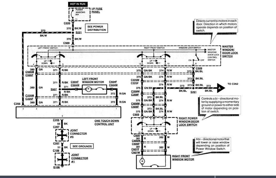

Bought the car listed above. The car runs fine but none of the power windows operate. Lock button on passenger side unlocks. Driver side does not. I switched the passenger side and it does not work on drivers side. I am stumped.

Good morning.
I attached a wiring diagram for you to view. Check the fuse listed for power on both sides. Then check for power to the master switch to verify it is getting power.
