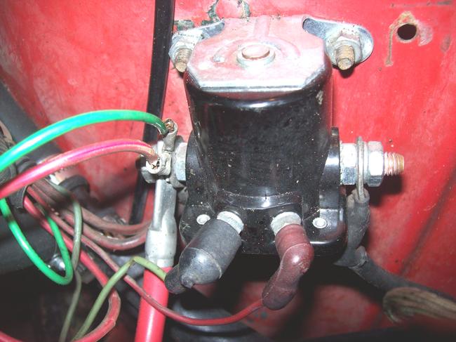

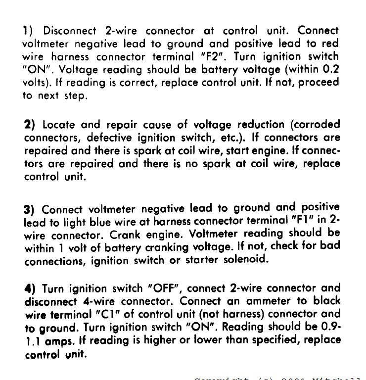

YOU SHOULD HAVE A SOLENOID LIKE JUST LIKE THIS (SEE PIC 1) ....IF YOU DON'T, THE JEEP HAS BEEN MODIFIED IN SOME MANNER..............SEEN US SOME PICS OF WHAT YOU DO HAVE

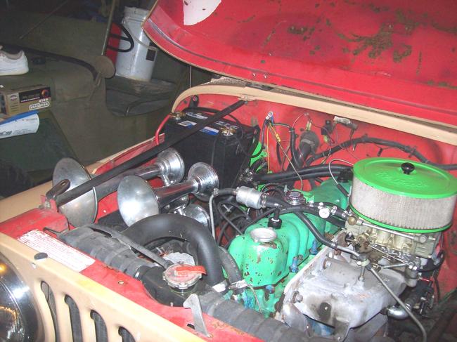

When I replaced switch it was just unplug and unbolt, put new one back on top of colum and bolt down then plug back in. With the module, same thing, unplug and unbolt and replace. No wires got messed with or changed. Regardless of no power at coil, I need to know why I have no power at all. Im assuming it would have to be in my ignition. Is there any wiring that goes to the ignition itself on a straight column, no horn just blinkers and hazzards

Mine is way different and smaller. Got good juice at it though. But im not getting any to my coil. That would not keep me from getting power at all would it?

First you say you have no power to coil now you say you do which is it? Check resistance of pickupcoil in dist it should be 400-600 ohms violet and orange wire leads. Follow the things I've sent in pics. I have no further suggestions. One other thing the cars when made by American motors had the crappiest systems andwere always failing also check for a bad ground as AM had a huge ground problem which is why there would be no power but you say you have. I have no further suggestions you might try he jeep guy on here if I thinkabout it i'll send this to him.

Have you still even bothered to check your fusible links? I bet not even cj isn't getting any answers and he also sent you the correct soleonoid pic an like I figure this jeep has been modified and hard telling what has been done to it. Send cj the pics you want help fine we can't fix it over the computer for you.

Sorry fellas, gave up for the day, getting to mad. The coil being bad is secondary now. I need to know why I dont have power at all. No wy to send pics at the moment or I would. After everything ive done, ive come to the conclusion that I have a bad ground somewhere, thats the only rason I can come up with for not having any power at all. If this helps, like I said before when key is off I have lights coming on in stereo but it wont turn on, with key in on position those lights turn off but still nothing. Electrical is not my strong point. Mechanical no problem, but u have to learn somewhere
