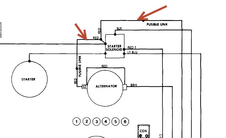

my jeep died and when i went to restart it i had no power. battery is good , starter is good. i replaced the ignition switch and module but still no power. some lights stay on in the stereo when key is off but when u turn on the lights go off

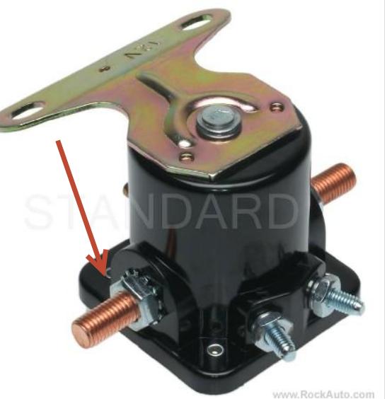

HMAC300
  • 48,601 POSTS
checkthe fusible links off of starter relay seepic

HMAC300
  • 48,601 POSTS
pic enclosed. fusible link shold be attached where arrow is.

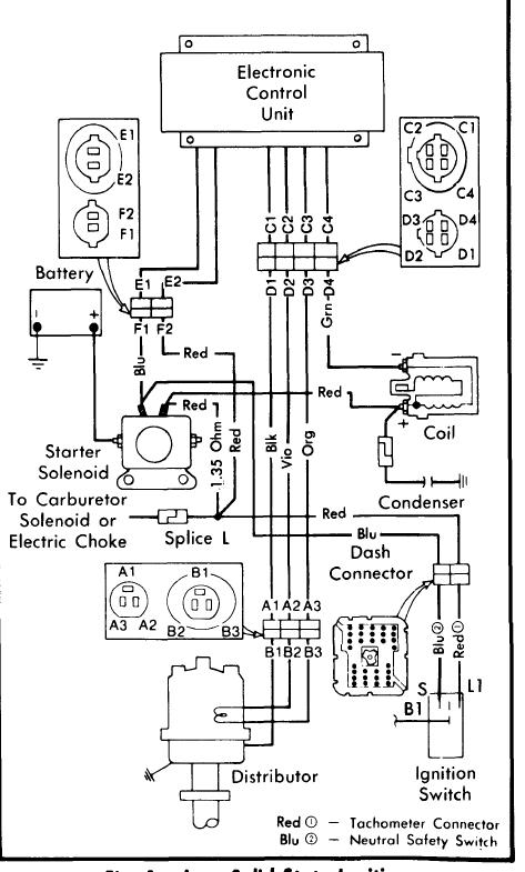

just probe the wire where they connect then follow it down to where they connect on wire and if you have power at both ends then they are good. what engine do you have cause I looked up your year and that is what is supposed tobe there unless you have the solenoid on the starter. or has been changed. if the test light is bright at both ends or if volt meter shows same reading at both ends then links are good and yes it could cause no power to coil. if you look at diagram you shold have power to coil form relay on red t wire when cranking it can be a module problem as well though but you need to check this out and return with engine size if not able to get coil power.

HMAC300
  • 48,601 POSTS
heres a diagram for your system recheck your work we have no idea what you did to this when you replaced parts so can't give a good answer. this is the way it's supposed to b e hooked up.

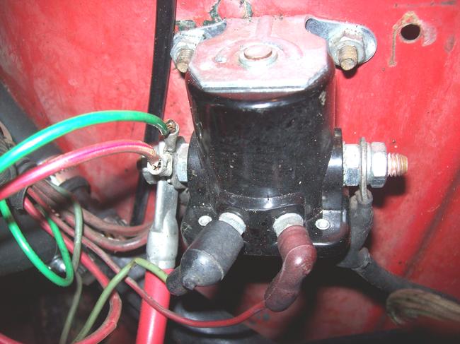

DO YOU HAVE A VOLTMETER?
YOU SHOULD HAVE A SOLENOID LIKE JUST LIKE THIS (SEE PIC 1) ....IF YOU DON'T, THE JEEP HAS BEEN MODIFIED IN SOME MANNER..............SEEN US SOME PICS OF WHAT YOU DO HAVE

obviously you arenot understanding what i's suggested the first few times. I first said to check your fusible links, if you don 'tdo that then how can we help? if a fusible link is burnt you don't get power even if youget it one other place. you have made NOTHING as far as SAYING THE LINKis ok . My suggestion to you is to take this vehicle to someone who knows what they are doing so they will have it right there instead of contstant emails back and forth. with one person doing something and another not knowing what the heck you did. take it to a pro and quit screwing around with it as you are completely lost.

first you say you have no power to coil now you say you do which is it? check resistance of pickupcoil in dist it should be 400-600 ohms violet and orange wire leads. follow the things I've sent in pics. I have no further suggestions.one other thing the cars when made by American motors had the crappiest systems andwere always failing also check for a bad ground as AM had a huge ground problem which is why there would be no power but you say you have . I have no further suggestions you might try he jeep guy on here if I thinkabout it i'll send this to him.......
