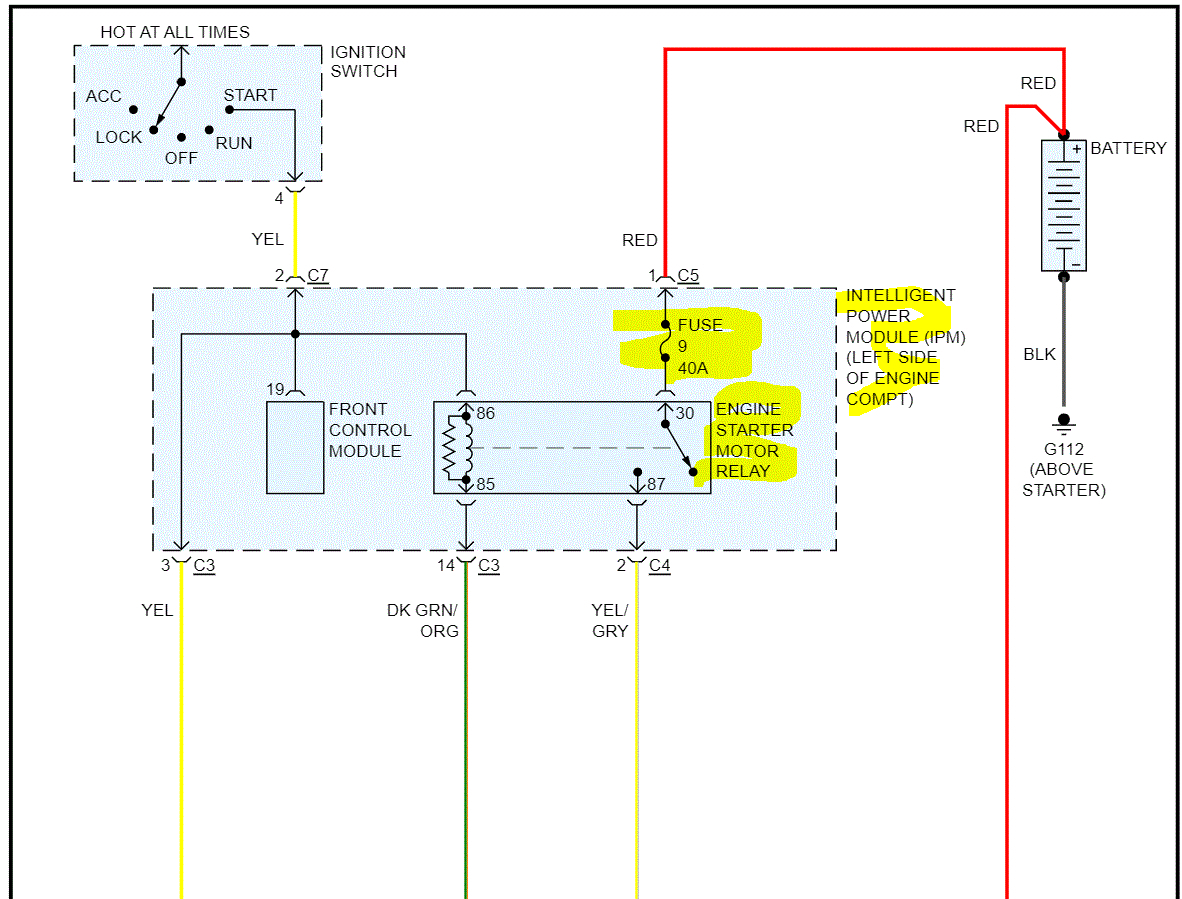

When i tried to start my listed above van Sport yesterday morning, nothing was left on overnight and the key wasn't even left in it, but the battery was completely drained. The battery is only 2 months old. I've charged the battery, checked the power to fuse box and power to starter which all seem good but when i turn the ignition it still does absolutely nothing. Any ideas? Please

Did the battery drain again overnight after being recharged?
As far as the starter, check to make sure fuse 9 in the power distribution box under the hood is good. Additionally, confirm there is power to and from it. Here is a link you may find helpful:
If it is good, then I need you to check the starter relay. Switch it with a different relay having the same part number. If there isn't one, here is a link that explains how to check.

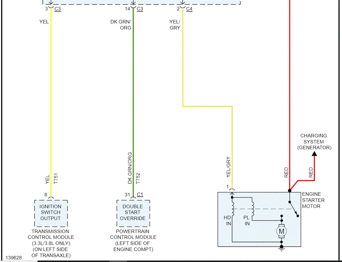

If the relay checks good, have a helper turn the key to the start position while you check for power at the yellow wire with a red tracer on the starter. It will be the smaller wire. If there is power, replace the starter. Note: That wire will only have 12v with the key in the start position. The larger wire will have power at all times.
I attached the wiring schematic below for your review.
Let me know what you find or if you have questions.
