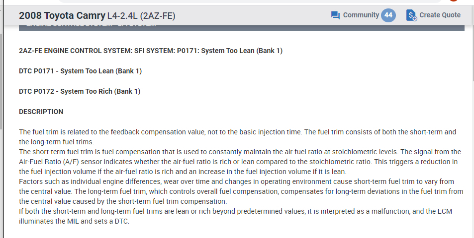

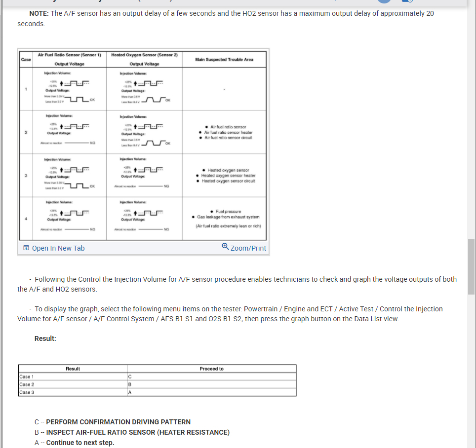

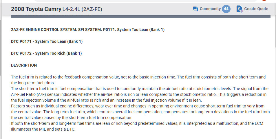

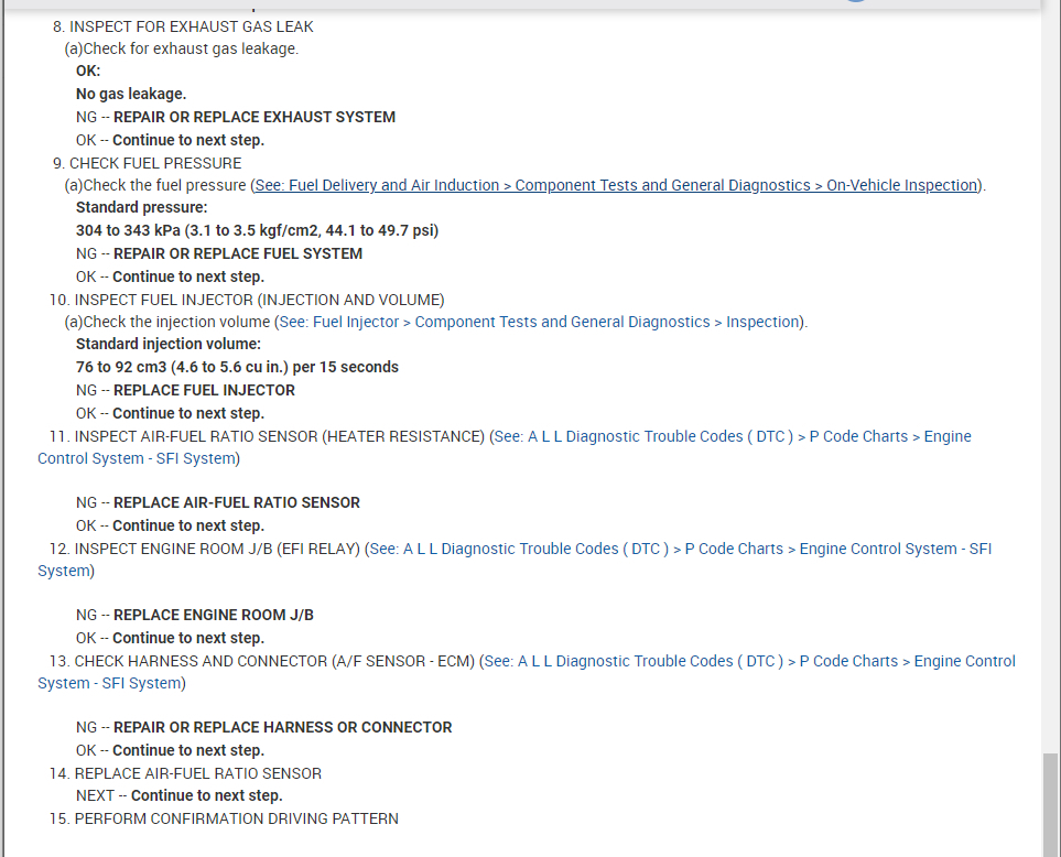

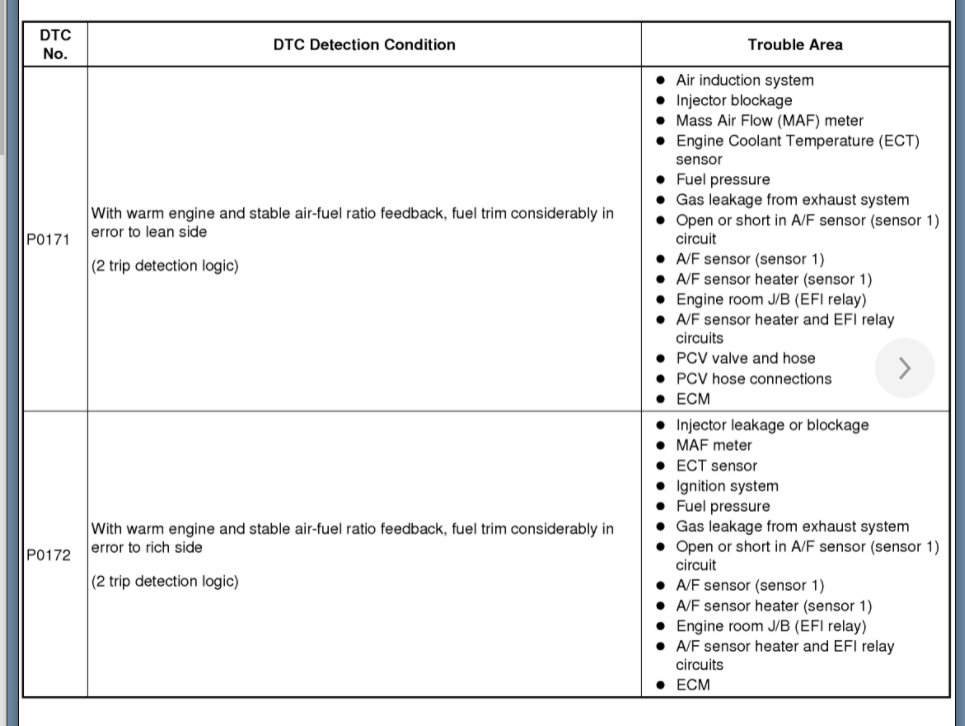

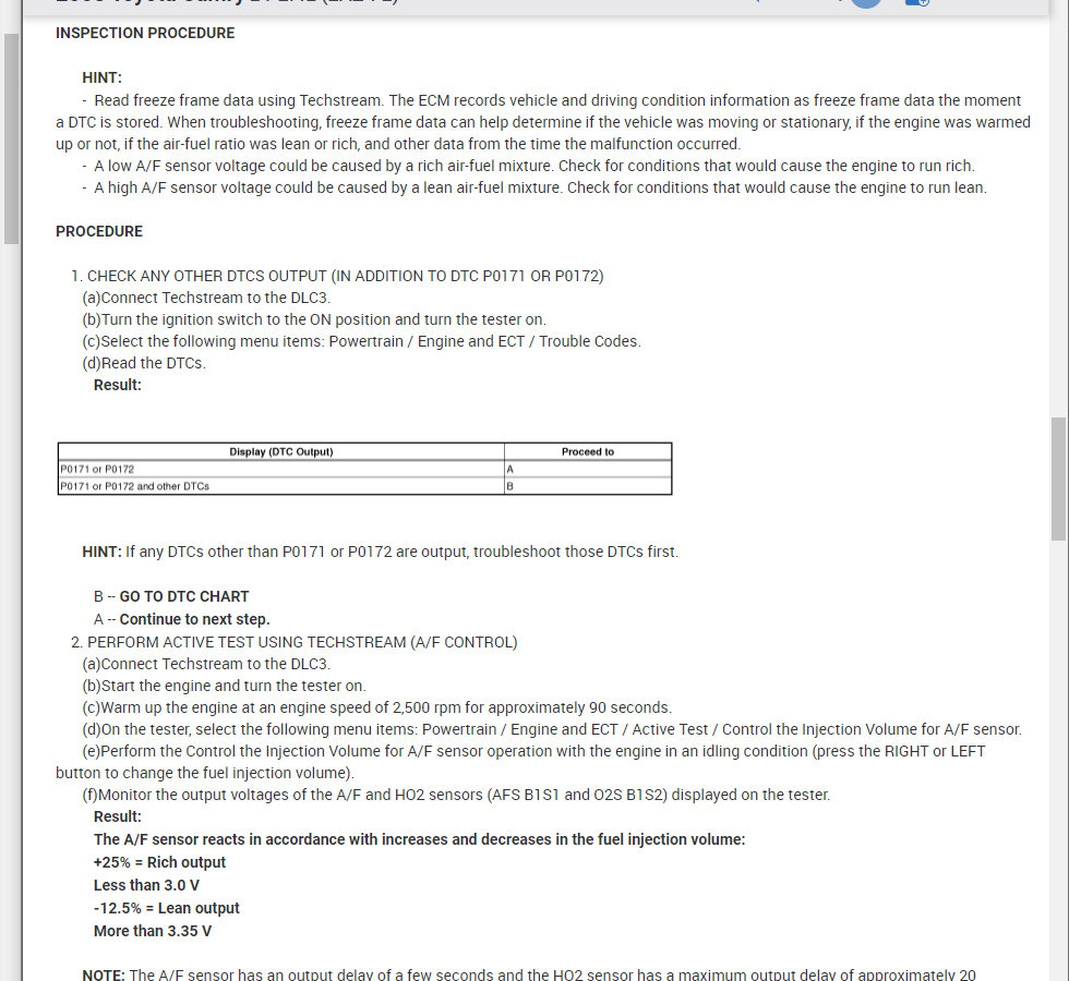

More than likely you have an issue with the MAF sensor but we need to run through this testing to find out what the actual issue is.

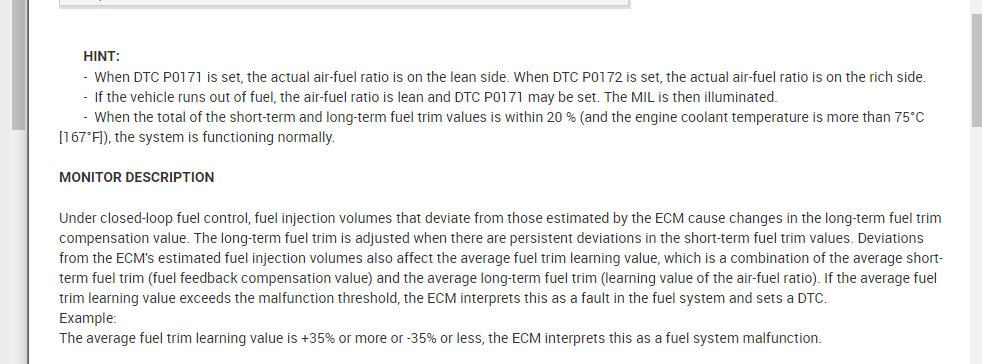

The P0172 is actually telling you that the system is rich so more then likely the MAF is reading low voltage which is telling the PCM that there is more air coming in then there actually is so it is dumping more fuel to compensate for the additional air.
It dumps too much fuel which throws off the air fuel mixture and you get a lack of power or a lag.
Here is a guide that will help with this but with a lean mixture. The idea is the same but it is rich instead.
https://www.2carpros.com/articles/repair-lean-mixture-codes-p0171-or-p0174-on-some-manufacturers

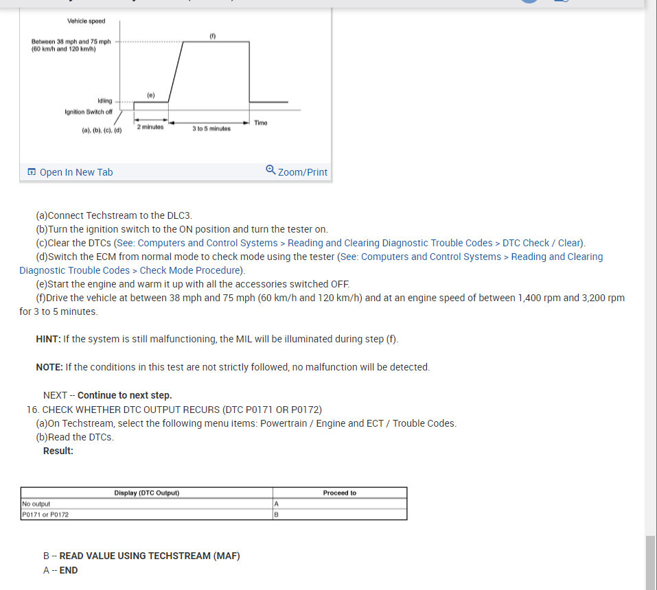

Below you will find the testing that we need to run through to figure out what the issue is.
Please let us know if you have other questions. Thanks

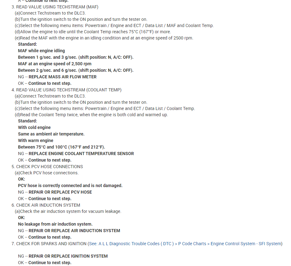

ANDREW MEAKES

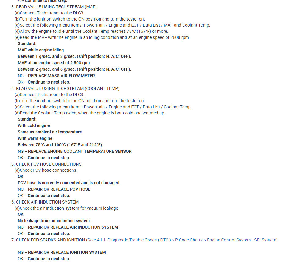

Just a follow up I cleaned the MAF sensor and the reading shows 2.6 (2.4 Ltr vehicle) and goes up proportionally on rpm. O2S11 seems normal 0.00mA at 2,000 RPMs. But when I start the vehicle from a cold start the choke kicks in but then seems to stop and the engine RPMs fall to 400 and nearly stalls or does stall then kicks back in again. The hesitation from acceleration from a complete stop to the time the car returns to normal is 2 seconds.

Do you still have the same code?
This sounds like a possible vacuum leak so we need to check for that and see what comes back.
Here is a guide that will help to this test:
Also, if you have a vacuum gauge let's hook that to the engine on a vacuum line and see what the gauge does when this is acting up.
