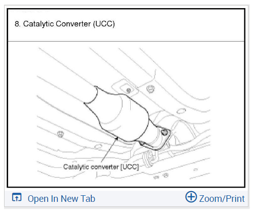

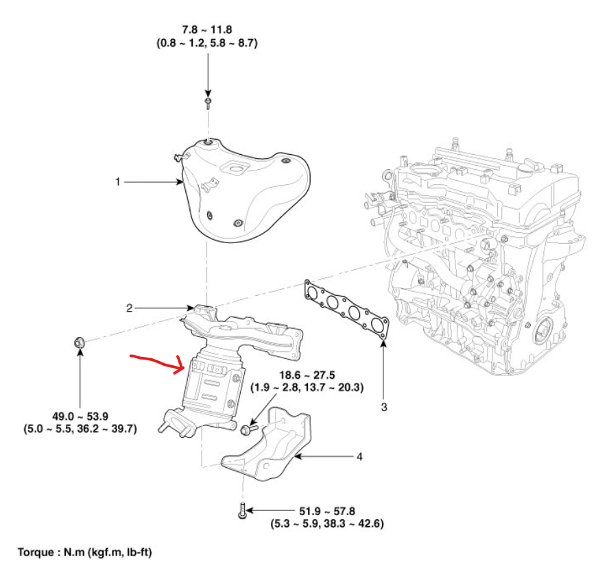

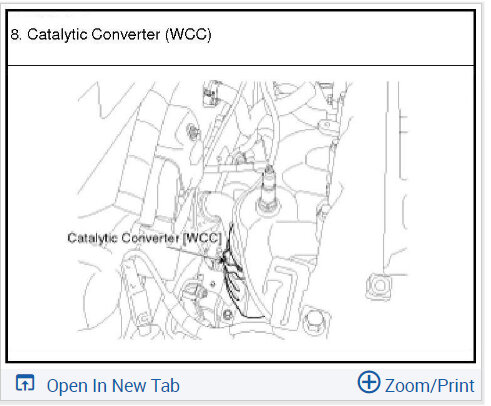

Yep, the air noise is telling us you may have a clogged catalytic converter. But to be sure this guide may help but the best way is to remove it for inspection. You have a primary cat which is inside the exhaust manifold, and you have a secondary unit under the car.
and
The primary cat have a history of going out and plug the outlet FYI. Check out the images (below). Please upload pictures or videos in your response of any problems so we can see what to help you with.
