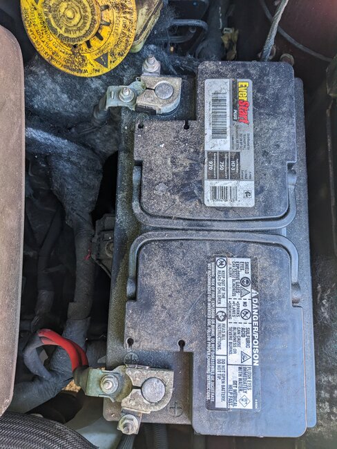

I have a problem with my car (2017 Dodge Grand Caravan).
It doesn't have absolutely any power whatsoever (no ignition, no lights, no doors, no windows, no nothing). The battery is OK, reads 12.8, is less than a year old. I have a portable jump battery, it doesn't give any power either when I connect it. The OBD-II scanner doesn't show anything when I connect it to the port under the steering wheel.
I've tested the battery wires for continuity. There's continuity from the negative to the frame, and from the positive to the TIPM. I've checked all the fuses too, they're good. Most of them read the battery voltage or close to it between the fuse and the ground.
I disconnected and reconnected all the cables that go out of the TIPM. They don't show too much corrosion.
I'm inclined to think that either the TIPM is toast, or there's some faulty cable or connector I missed.
Is there any way to tell for sure before I try to replace the TIPM?

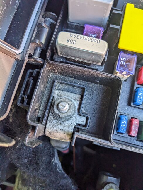

Can you please upload an image of the battery and cables so I can see it? Does the cables have an aftermarket terminal end on either of them? Please check for power at these fuses in the image below. If the TIPM is bad it wont affect this test. Please go over this guide.

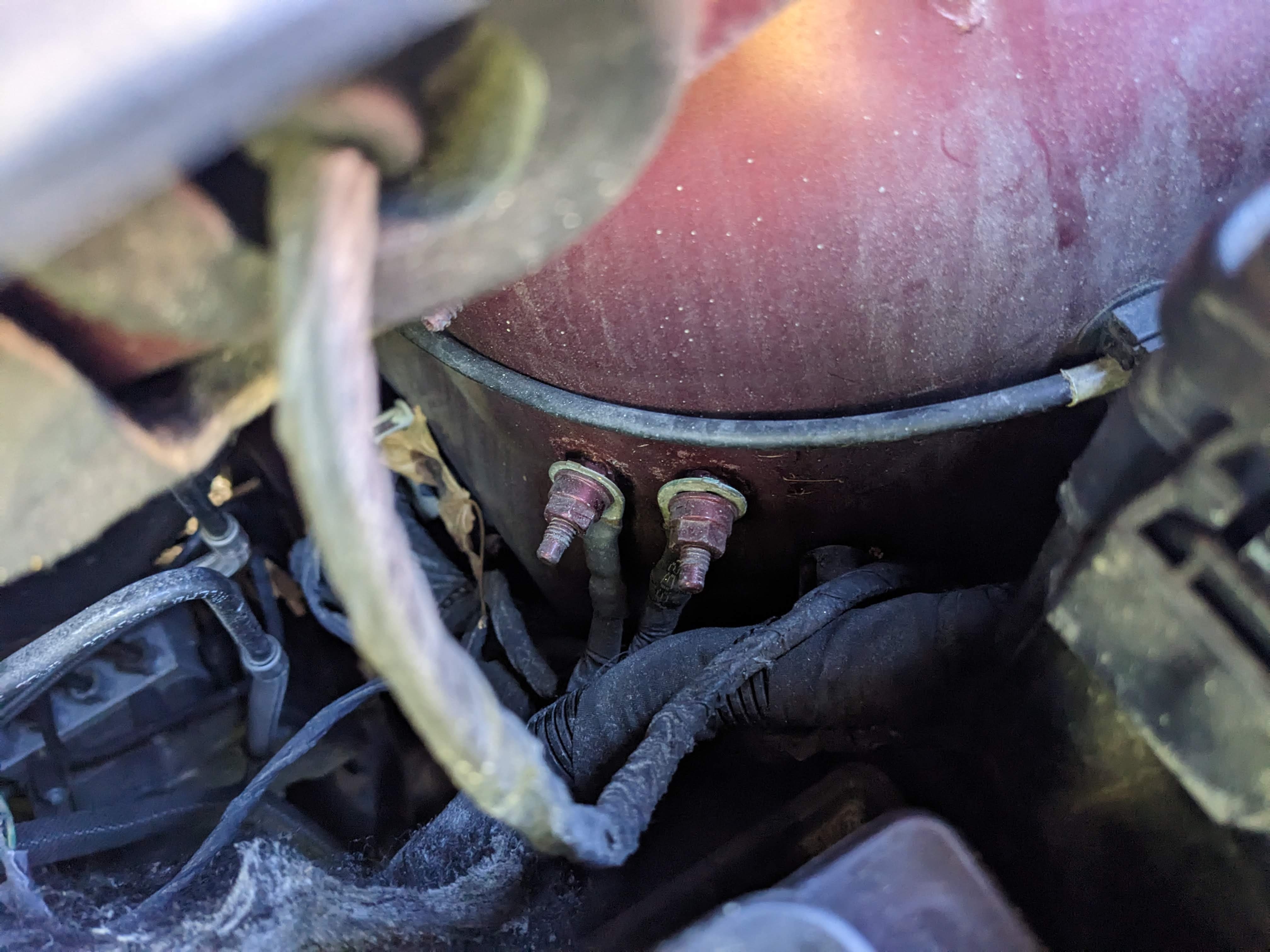

It was corroded battery terminals.
They were the ones that came with the car, nine years old. I've cleaned them with baking soda, put them back, and the power went back on.
Apparently, not even the jump start battery alligator clips were able to bite through the corrosion, or maybe it was at the point of contact with the wire.
