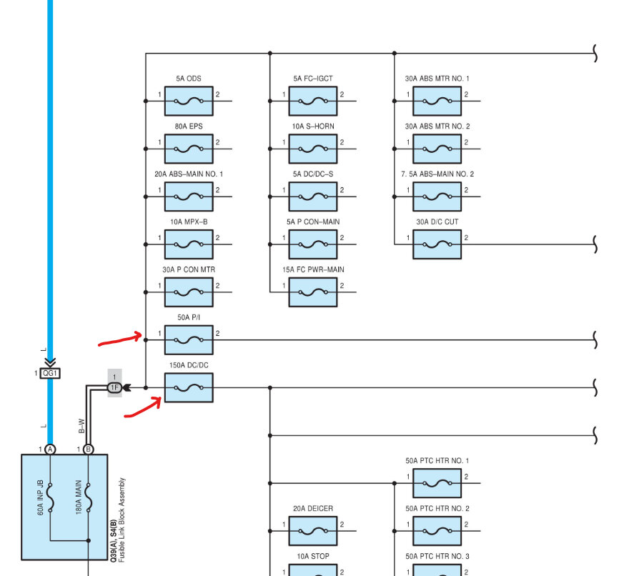

Battery was dead in my 2017 Mirai, so I removed the battery and charged it outside the vehicle. Reinstalled the battery and when I hooked the battery cables, the alarm went off, indicating power. While tightening the connections, ratchet was on the negative terminal and the wrench slipped and hit the positive terminal creating a quick arc. Now I have no power to anything - a 2017 paperweight. I have scoured the web, but there is very little info on the Mirai and the owners manual is of no help. The fuse block diagram is abbreviated, so of very little help. Any thoughts would be greatly appreciated.

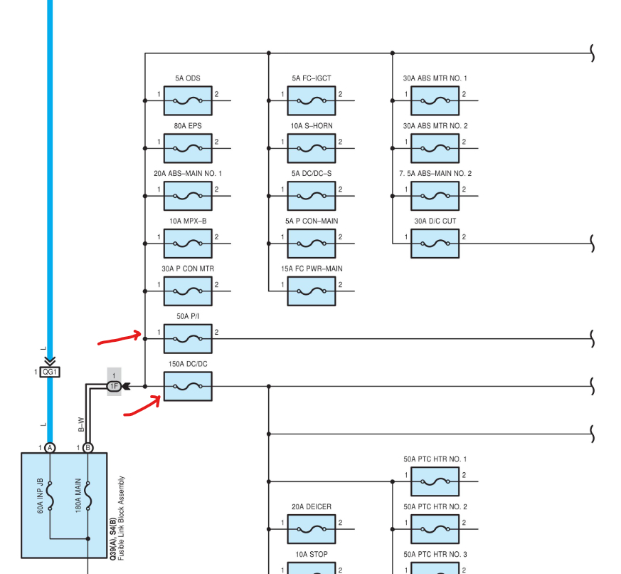

Yep, that is a bummer, you almost certainly blew a high-amp main fuse or fusible link that sits between the 12V battery and the car's electrical bus. Here is a guide to help test the fuses
Here are the fuses that need to be checked. Check out the images (below). Please upload pictures or videos

Thanks for your prompt response. I have checked any fuse that by the abbreviations on the inside of the block cover seemed to pertain. How do I test the 60Amp or 180 amp fuse.? I have already replaced a relay but that did nothing. Are the images general or vehicle specific?

These images are for your vehicle, I would use a test light to test the maxi fuses, you might be able to see them as well, if you upload an image of the fuses I can tell you more.

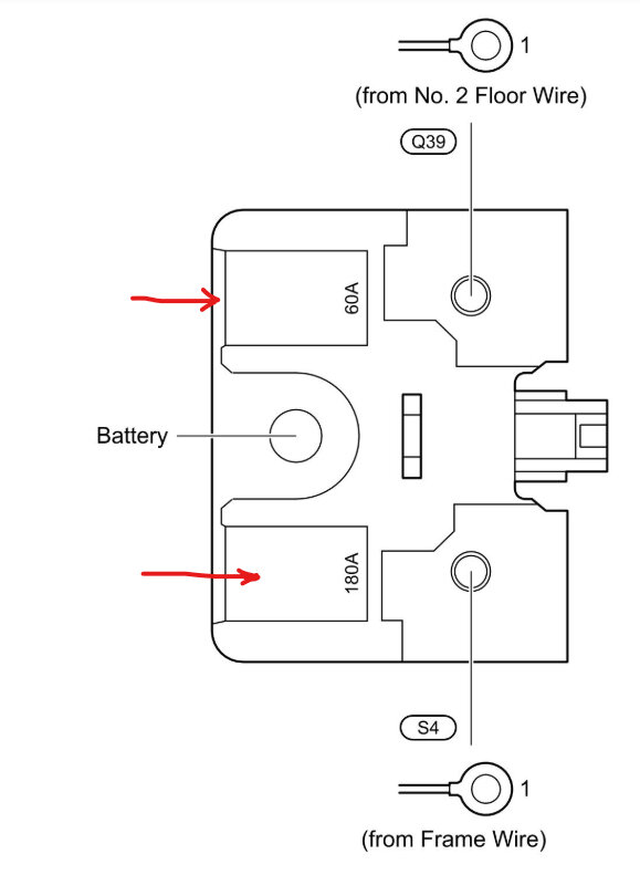

Finally had a chance to check out the fuses with the diagram that you sent and it was the H830 180A fuse that blew. Now I can't figure out how to remove it to replace it. Any thoughts? And thank you for the diagram, it took we a little while to figure it out...

You are welcome, that is all they show. Can you upload an image of the fuse so I can see what to do?

First off - thank you so much for you and the other mechanics that take the time to help on these forums. I tried to find the part online, but didn't see anything similar, so I called the parts department at Toyota and that part (that shows the blown 180A fuse) comes as a complete unit, and not that pricey - under $40. They are ordering it and I should be able to pick it up tomorrow...

Nice work! . That should fix it :)
