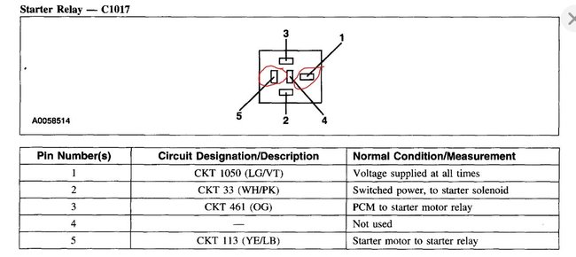

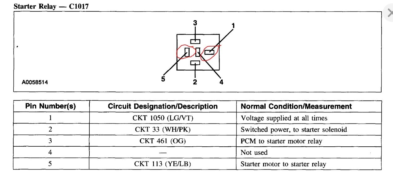

Okay, I definitely need help. we have changed the starter, the starter relay, ignition switch, ignition relay and battery. And the fuses all look good but we have power to everything else just the starter. no codes are coming up on it. I have no clue. Where to look now!!! Definitely need help!!!

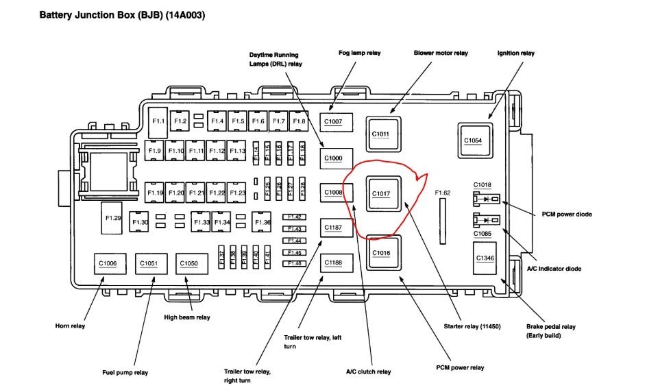

I attached a diagram of the system for you to view.

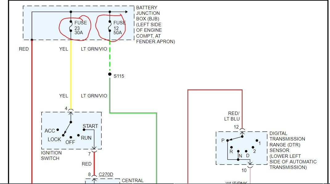

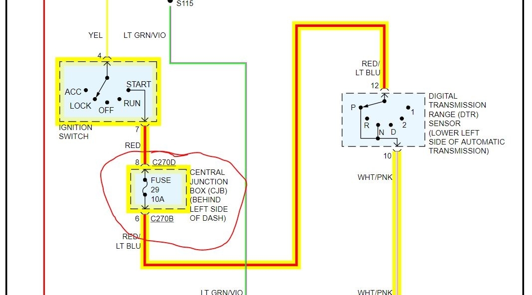

Check the fuses I circled for power in the on position. The one marked crank will only have voltage in the start position.
I also circled some terminals. If you jump those terminals together at the fuse block, the starter should crank. That will tell me if the wiring is good to the starter solenoid.

Okay, you need to test the fuses I circled with a test light for power. This is not a visual test it is a voltage test.

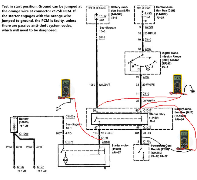

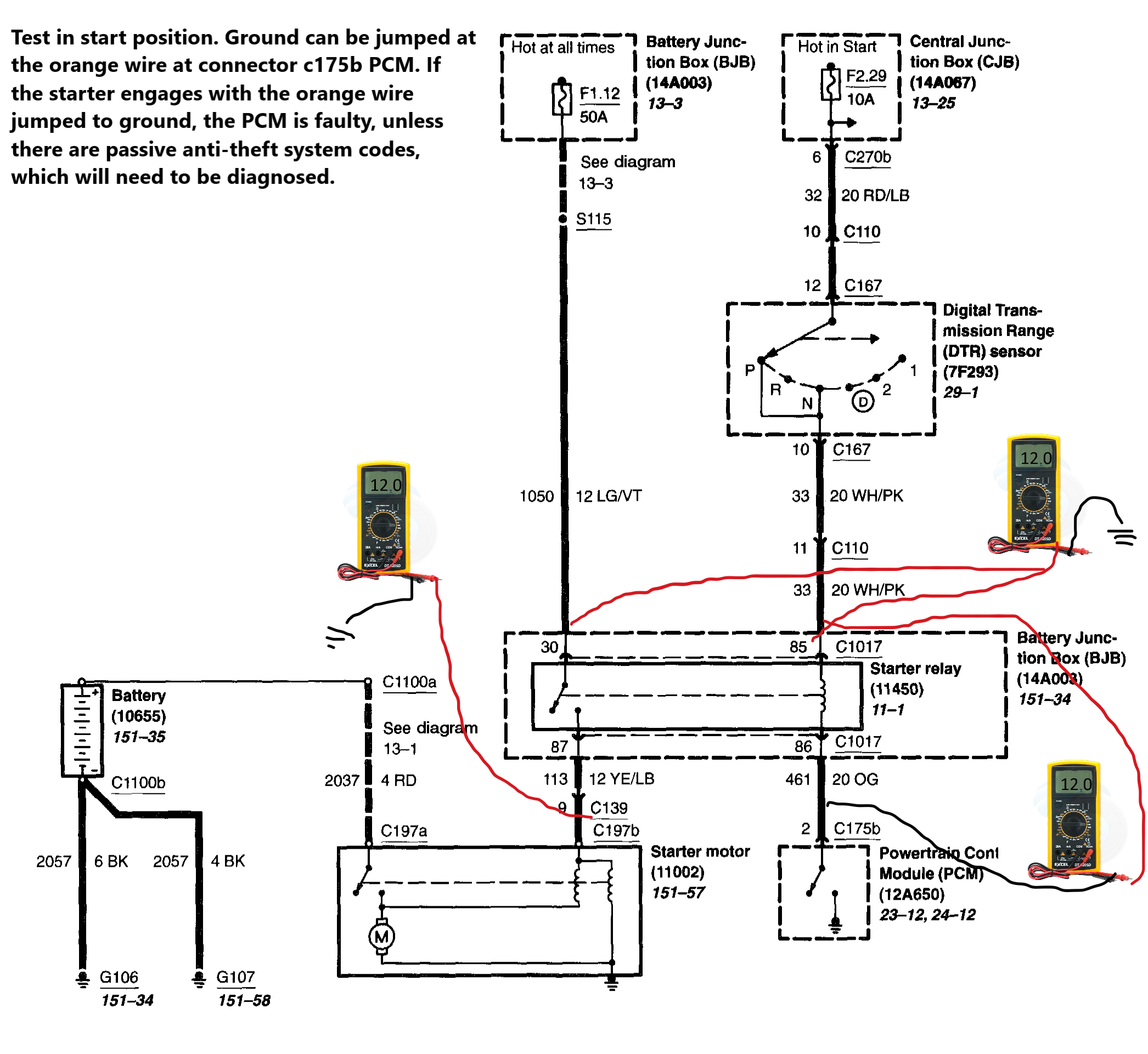

If there are no pats system codes, I have attached an illustrated set of quick voltage tests to verify correct input voltage and grounds necessary for proper starter relay operation.

Okay, my uncle said he's not getting power to the starter solenoid trigger wire. What do I do for that?
Jan 20, 2020 at 8:08 AM
Okay, that is why I attached the diagrams and told you to do the voltage checks at the fuses to make sure you have the proper voltage.

If you have 2 powers at the relay then ground the orange wire at the relay while someone turns the key to the start position, you should get power at the solenoid and the engine should crank. If it doesn't you need to verify continuity between the PCM and the relay orange wire, and also between the solenoid and the relay yellow/lb wire. If the engine does crank and there are no trouble codes, PCM is at fault.

If you have access to a scan tool that can view pids as well would be helpful. Specifically the pid starter_enable, which should read yes or no. If it reads yes and the orange wire to the relay does not get grounded, circuit is good, then the PCM will be at fault.
