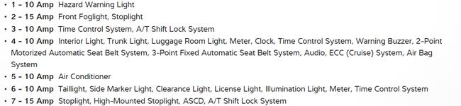

My husband has a 1994 nissan sentra it had an older pioneer cd unit in it that finally gave out so i got him a kenwood and put it in but nothing happened. Ive installed atleast 10 stereos in my life its pretty self explanatory. The fuses were all still good, i had the deck tested and it was still good. So im wondering if the wiring is bad because the other stereo would lose connection sometimes i figured it was just old.
Since then someone cut the plug out of the car so i hard wired it and still nothing. Please help
Mar 26, 2015 at 11:51 PM
HMAC300
  • 48,601 POSTS

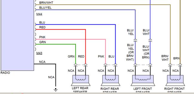

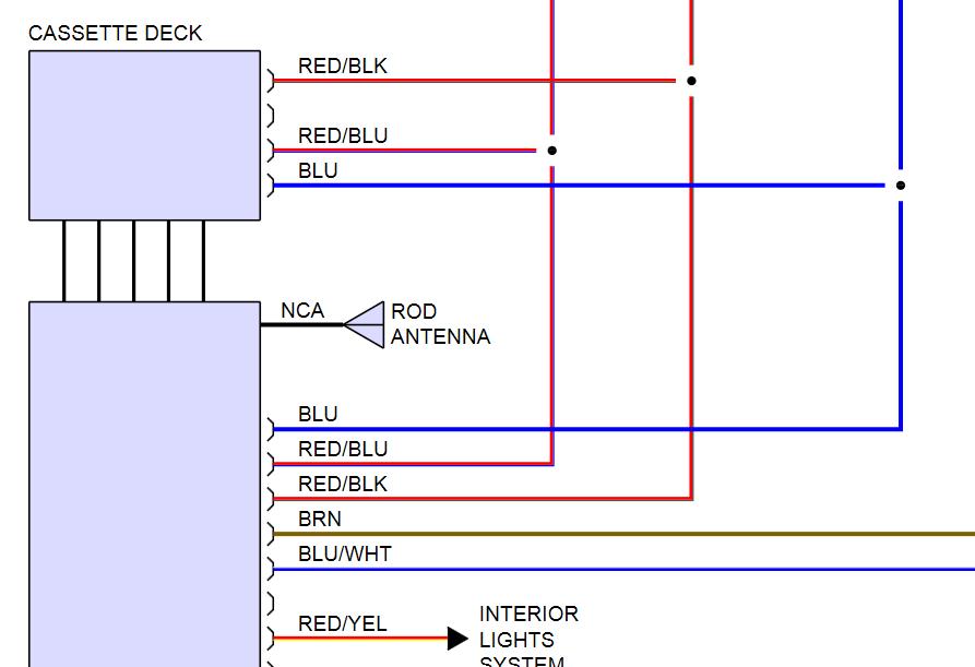

fuse h and O for radios see pic for wiring diagrams

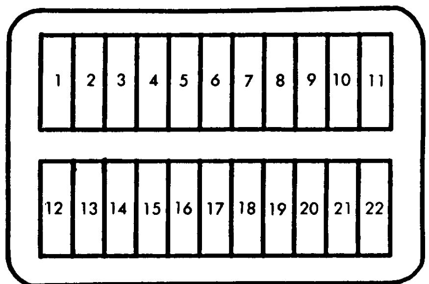

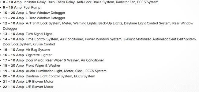

Thank you :) Ill give that a try when he gets home. You would happen to have diagrams of both fuse boxes too?
Mar 27, 2015 at 2:43 AM
HMAC300
  • 48,601 POSTS
see pics
