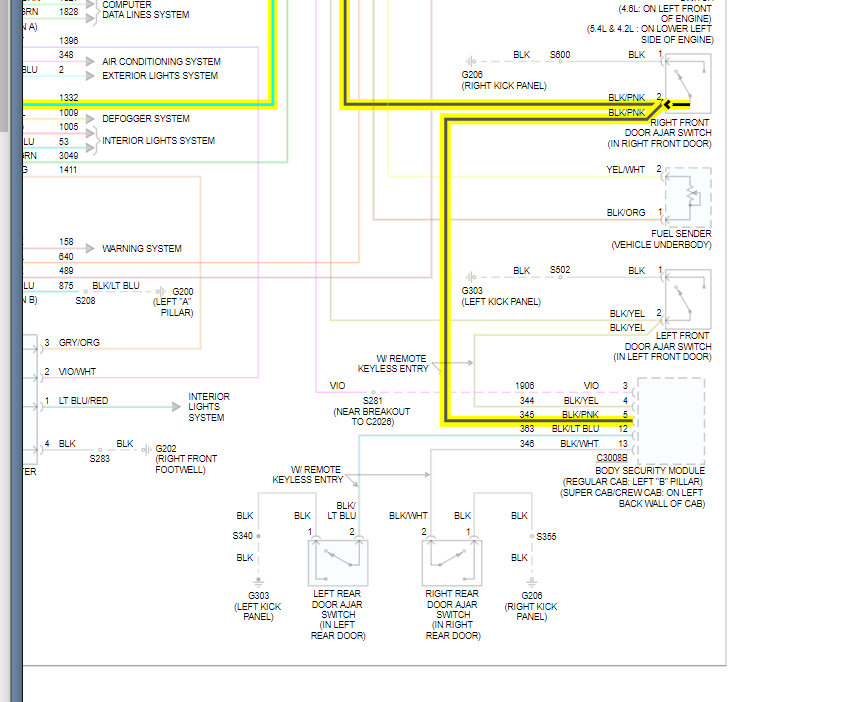

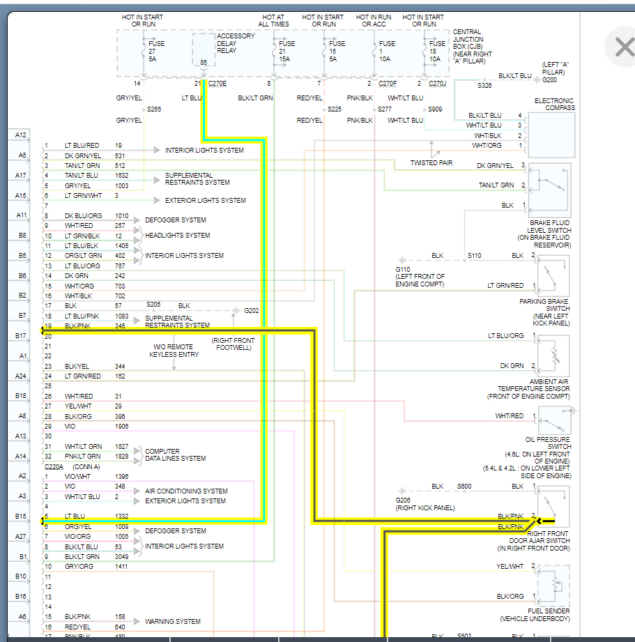

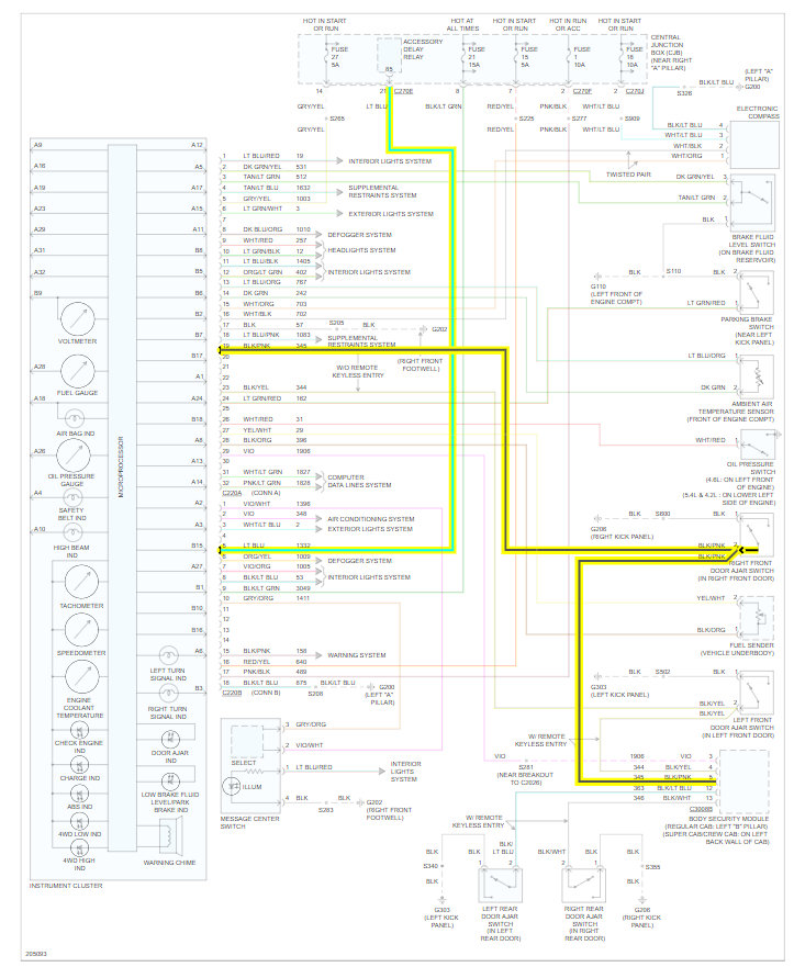

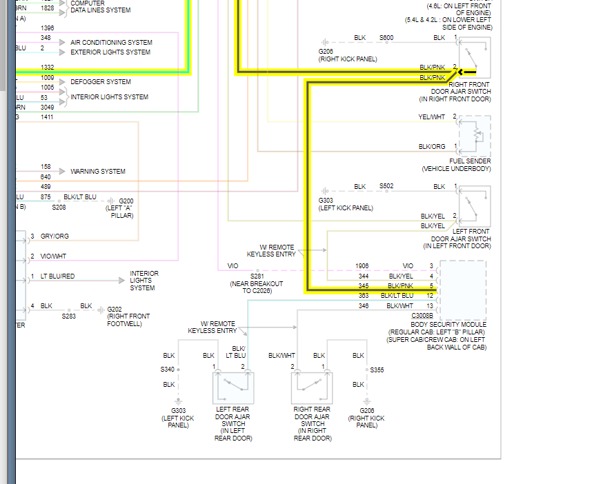

My truck listed above has no power to the gauges and anything else interior related. Truck still drives but no interior power.
Jul 18, 2021 at 7:20 AM

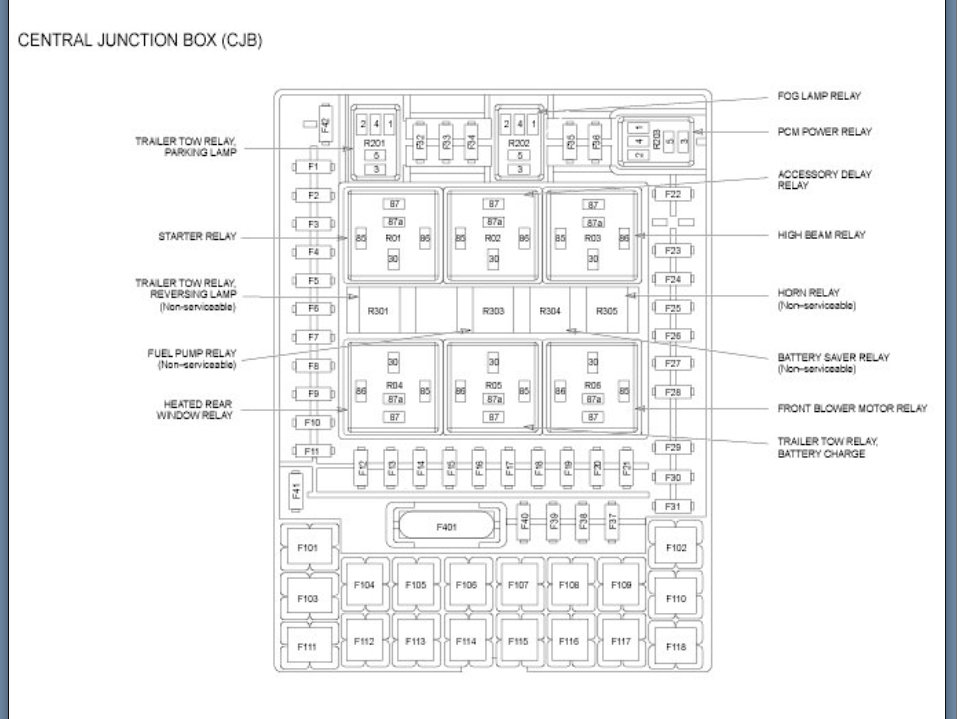

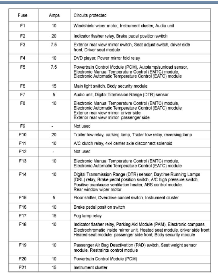

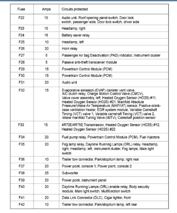

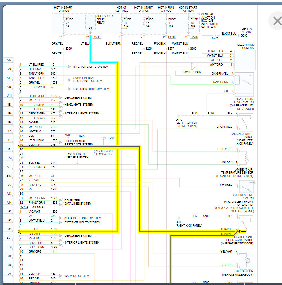

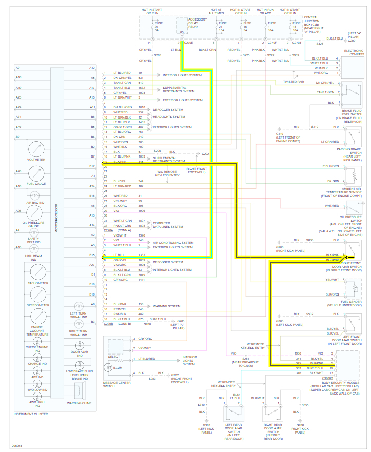

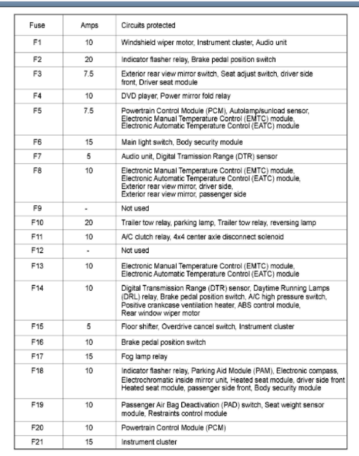

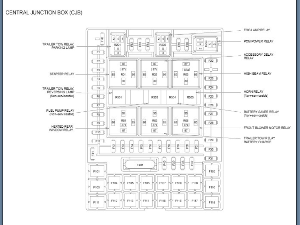

This could be a number of things so we need to start at the basics. Let's run through the fuses and the accessory relay and make sure we don't have blown fuses and the relay works.
Here are a couple guides that will help with this:

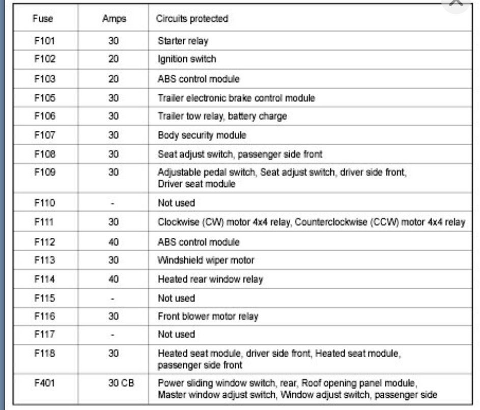

While this could be the issue I am thinking that we have an issue with the body control module. This basically controls the lighting and door lock function on the interior. So do the door locks work? Do the window controls work?
I am also attaching the info on the fuse layout and description so we need to check the couple of fuses for the BCM as well.
Let me know what you find with this and we can go from there. Thanks
