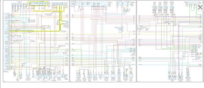

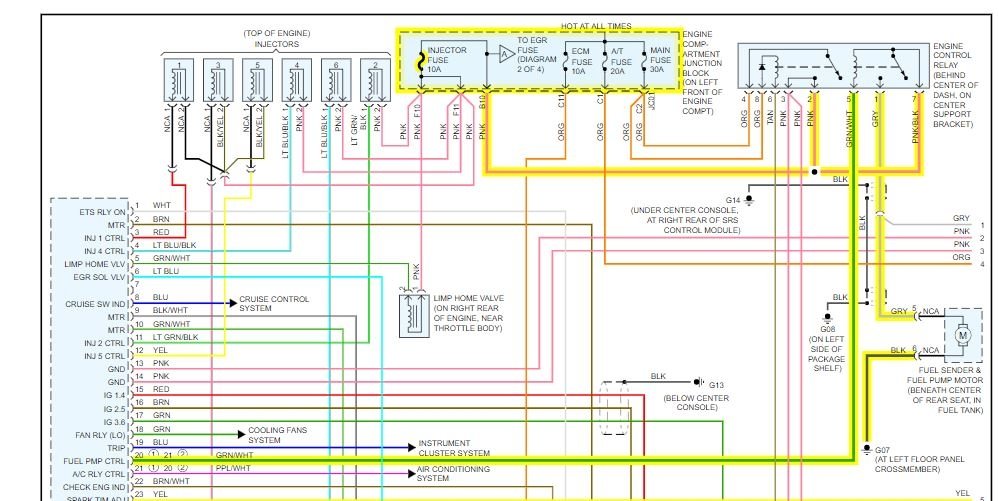

Car was stalling out and not starting for a few minutes, then just stalled and wouldn’t start. changed fuel pump still not starting. What should I be looking for?
Aug 2, 2019 at 5:57 PM
Good morning,
You need to check the actual fuel pressure to be sure the pump is working.
You also need to test for spark to see if it is spark related.
Are there any codes set?
