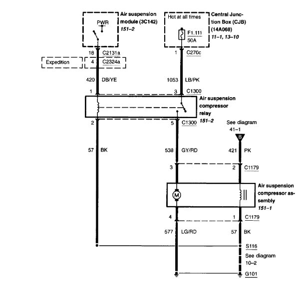

Good afternoon,

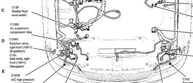

The relay is by the compressor. I attached a picture of the location.
There are some that are bolted on the frame rail, on the right front.

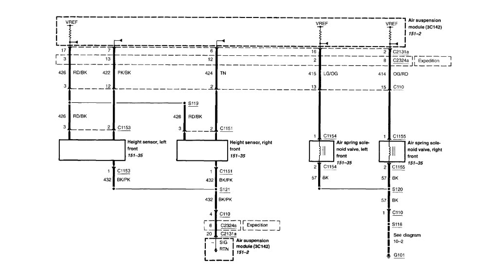

When you turn on the key, the compressor should come on for about ten seconds as a test for the system. If it does not then you need to check the fuses listed in the diagrams for power on both sides. It may be the suspension module itself.

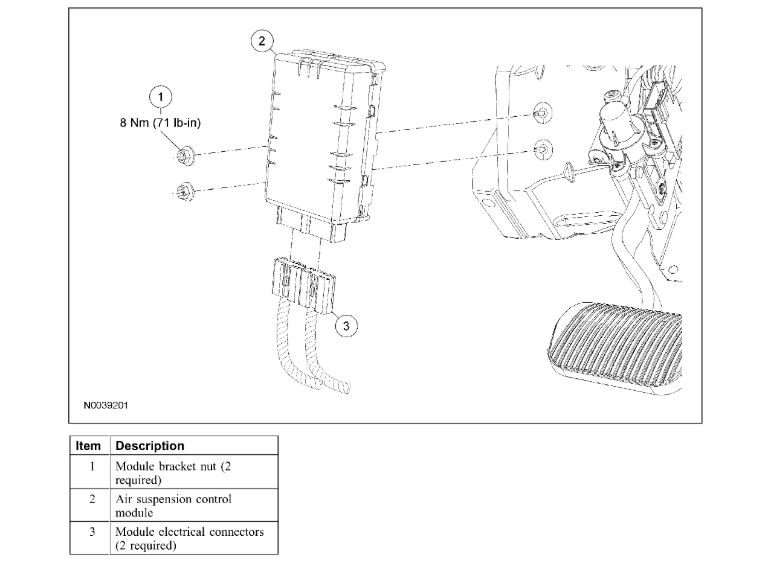

Note: The air suspension control module is mounted to the lower left side of the dash above the parking brake control.
In order to test it, you will need an advanced scan tool to monitor the system and see if it is sending signals to the relay and the compressor for pumping up the bags.
I would verify power to the module to be sure it has power.

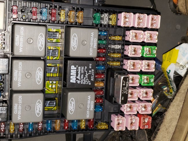

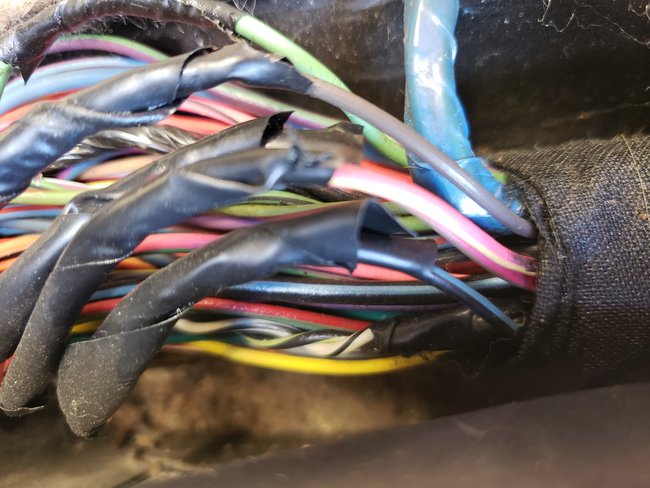

I Just sent another letter as I never noticed the factory box and mine look different, as I have an extra relay that is not factory and on the left side it appears that someone has cut or fixed a few wires and left them wide open. I will add the pictures. factory box and if you look where the blank relay is empty, I have a relay fuse in mine. I have no clue if I don't have a stock SUV. Please help.
the wires on the left kick are a brown, green, pink and red.
Jan 12, 2019 at 8:11 AM
Hard to say what the relay is for but whoever did that wire job did a butcher job.
Those wires should be solder and shrink wrapped.

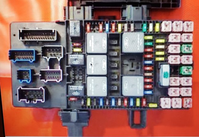

You are correct, I think the ladies son might be the culprit to whom I bought it. I learned one thing for sure! Ask to drive it and tear it apart before you sink ten grand in one. Don't get me wrong in the west where it's hot no rain, it was great. Now, for the other purpose of this link is, there are some fuse boxes on eBay and some state for 2003 - 2006 and when I look at mine it shows I should not have the extra relay in mine as I do. I found out that all Lincoln is not 2003-2006. It is crazy Ford.
I also read today that the top left wire set the goes through the firewall has had issues as well. Some boxes have them with the sell and some not. What is your opinion on this? I would love my air shocks to rise again. I love the beautiful ride it gives.
One more great question, what is the difference between an ultimate and luxury style? I have the longest one they made it has Limited on the back right side. The pictured one is on eBay and states it belongs in my SUV.

The difference is most likely accessories.
I would call the dealer and get the correct part number from Ford. Then compare it to the one you have.

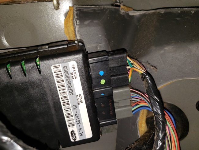

Hello Roy, I am asking a much more challenging question now. I did a parasitic draw test and 1 10 amp fuse showed drag, then i waited a bit longer and all fuses are okay. I found my suspension module and want to know,if there is anyway possible to test it? I watched a man trace his to the blue dot plug that also runs the wire cluster to the lower back of the junction box (fuse box). He said he tested, but does not give a way to test the module.
I did figure out how to omit the rear switch for anyone who is concerned.
I put my Lincoln to sleep for about 1.5 hours (turn switch off) then I did the parasitic draw test. After this is completed unlatch all doors and hood back to normal. Turn the key one and this will tell you all items that are low or not working. I seen the suspension off switch show me it needed to be turned back on. I just stumbled upon this way to test. I hope it helps someone. Here is my module for the suspension under the drivers side towards the left. It is on the firewall. FYI

I want to know if there is a way to test the suspension module. It looks like I will need to make a ground to remove it as it is grounded on the firewall wall.
Jan 20, 2019 at 2:34 AM
No, not without special equipment. Most shops cannot as well. We used to send them out to rebuilders and have them check them for us.
