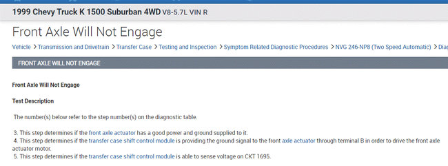

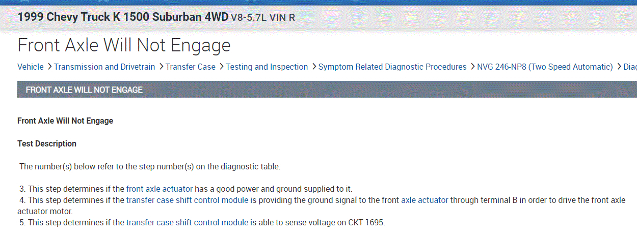

Having a hard time diagnosing issues related to my 4x4. Both the front axle actuator and encoder motor on side of transfer case have been replaced and as far as I can tell my listening to them are functioning. I’ve got the electronic buttons for 4 wheel drive and they appear to be working as they should. When I put the truck into 4 hi it sounds like it engages but the front two wheels have to power to them. Same thing happens in 4 low. Is there maybe something I could check on the transfer case itself? Any helps appreciated.
Sep 6, 2021 at 3:12 AM
  • 110,244 POSTS

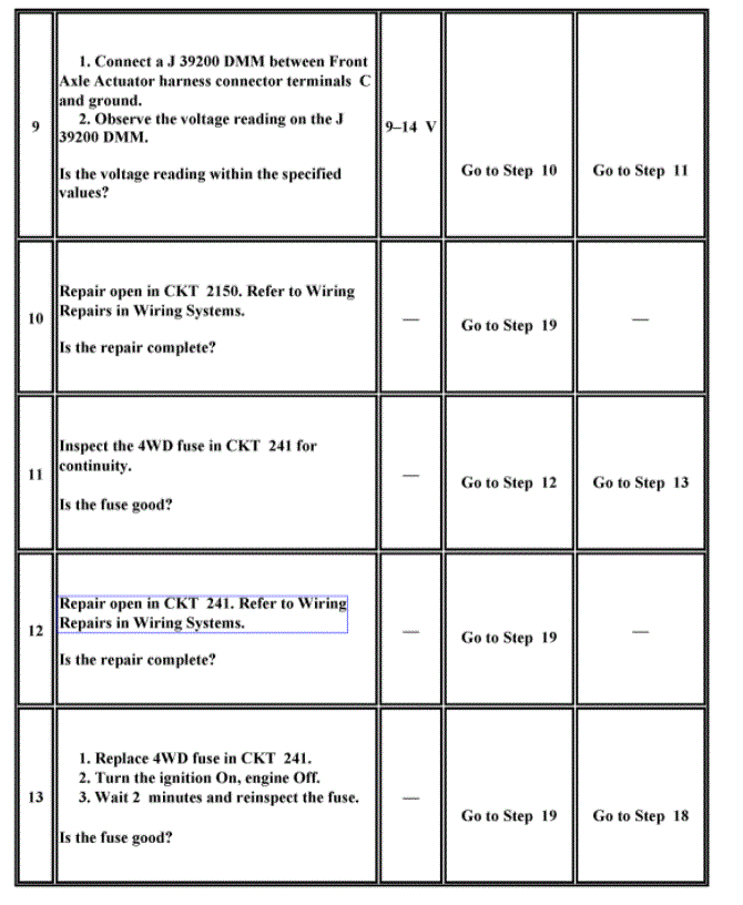

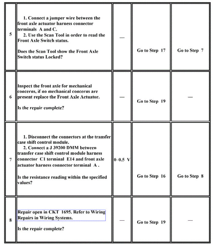

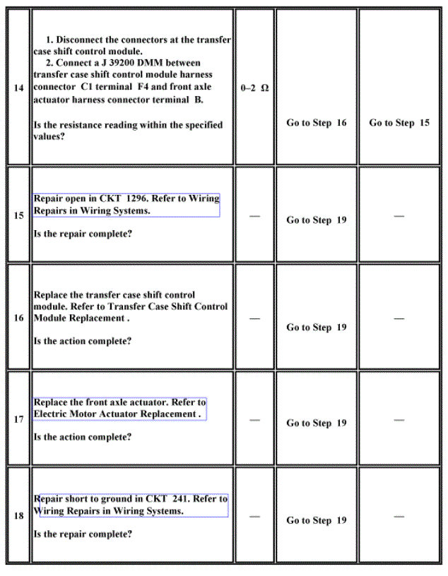

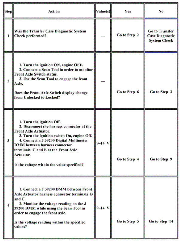

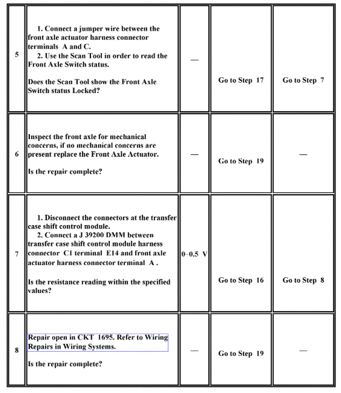

Have you confirmed there is power to the front axle actuator? If so, there is a chance the transfer case control module isn't providing a ground path for the actuator.

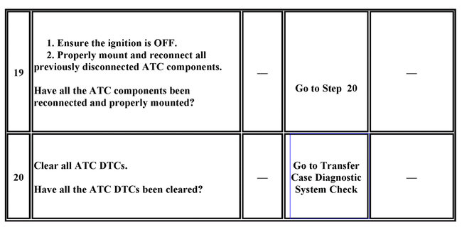

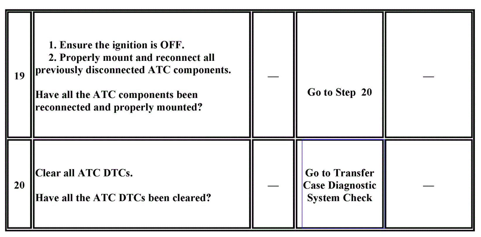

Do me a favor. I attached diagnostics related to a front axle actuator not working. Take a look through them and let me know if it is something you are comfortable doing.
