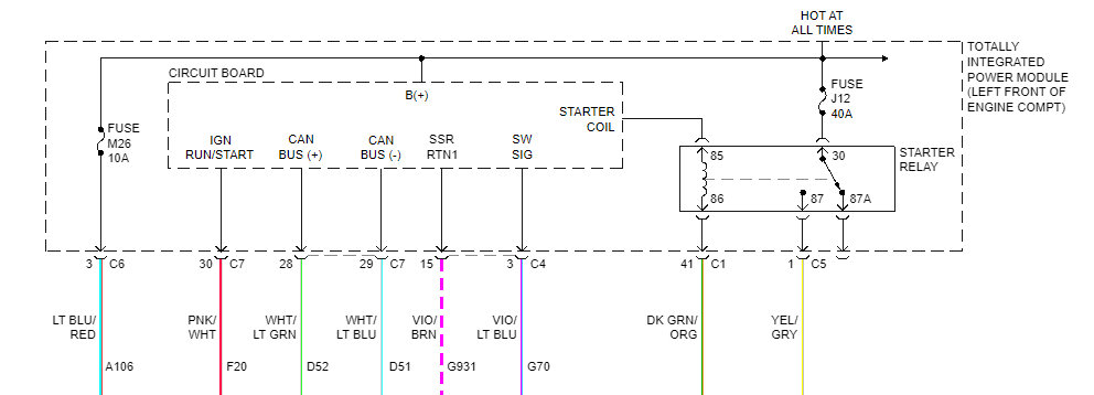

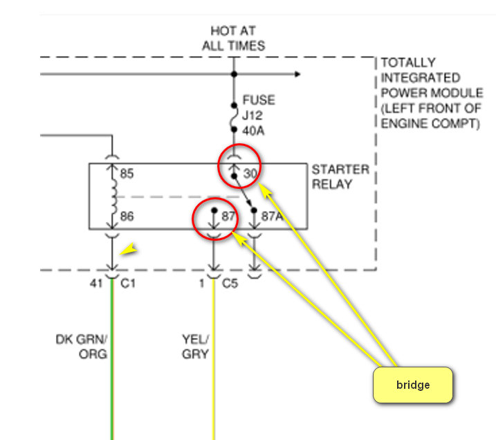

I'm a little stumped as electrical is not my strong subject. My truck listed above is a 1500. The truck will not start. The TIPM Starter Relay is a 4-Pin design and I have verified that power is getting to the correct relay cavity. However, when I have someone try and crank the engine, there is no power going from the starter relay to the starter solenoid. The starter is in good working order. I have verified the relay is good and even tried a new relay in the socket, and no go? I'm looking for any advice to point me in the correct direction to fix this. Thanks for your time.

The first thing to check is if the relay is being activated when trying to crank the engine?
There should be an audible click from the relay.
Have you tried starting the engine in neutral and park?
If there is a click from the relay then the next thing to check is if there is 12V being transmitted out of the TIPM on connector C5(brown) pin 1, yellow/grey wire. See diagram attached.
This check can be done by using a test light or a voltmeter.
or
If there is 12V at this pin and still nothing at the starter solenoid, then next check the wire between the TIPM and the solenoid.
Hope this helps.
Cheers, Boris

Thank for the info Boris. I'll do the checks and get back to you with the findings. It might be a couple days due to rain in the area. Thanks-

I had a tiny break in the rain and did one test using a tool similar to a Power Probe and probed the 4 pin cavities of the Starter Relay- (KOEO). Here's what I got:
1 pin had constant 12V
2 other pins had no voltage
1 pin (pin that supplies power to starter solenoid) showed ground/green (0 Volts)? Is this normal for this pin? I'm no expert, but if its showing ground, then there must be a short somewhere on that wire? Please advise if I'm wrong or in the right direction. Thanks Again and have a good weekend.

You should start with the quick test described by Boris K. Feel if the starter relay clicks when a helper turns the ignition switch to "crank". If it does, that eliminates 90 percent of the circuitry as suspects.
With older starter systems, they can be broken down into four parts, each with a corresponding terminal in the starter relay's socket. In this case at least two computers were added so some tests aren't possible. The constant 12 volts you found on the supply circuit is correct. The ground you found on the circuit going to the starter solenoid is also correct. The apparent ground your probe is finding is the extremely low resistance of the starter solenoid. When we do these tests with a standard test light with a simple bulb inside, we find 12 volts all the time on terminal 30, and 12 volts on terminal 86 only with the ignition switch in the "crank" position.
For the other two terminals, we're looking for ground, so the test light's clip lead must be moved to the battery's positive post. In older vehicles, terminal 85 reads continuity to ground through the neutral safety switch. Terminal 87 will read to ground, (very low resistance), as I mentioned, through the starter solenoid.
In 2010 through 2022 models, the tests for terminals 85 and 86 are not valid because there's all kinds of electronic switching circuitry we can't activate manually.
The way to diagnose this system is with a scanner to see what the various computers are seeing. Most problems are caused by the Totally Integrated Power Module, (TIPM), (under-hood fuse box), which isn't actually a computer module. I had some apart recently for a 2015 model, which is the same, and found it's full of miniature relays that can't be taken apart to clean the contacts. Before you get all "wrapped around the axle" with complicated tests, you might consider substituting a good used TIPM as a test. Boris K will be back shortly to continue helping you.

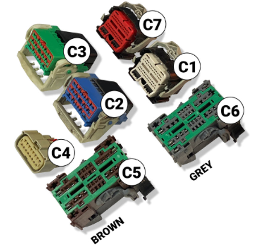

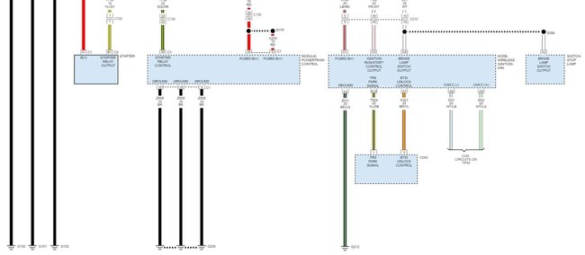

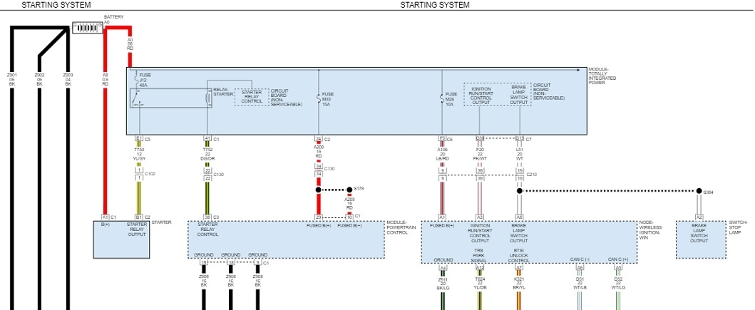

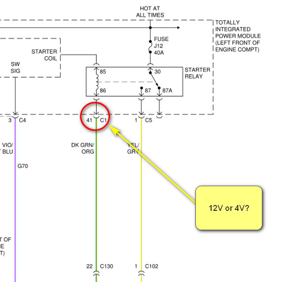

I know this is confusing because there's over a dozen small relays built into the TIPM that can't be repaired or even accessed to take readings. One of them is a "Start / Run" relay. From what I remember on the 2015 I was helping with, we figured out the ignition switch sends a digital signal to the "Radio Frequency Hub", "Wireless Ignition Node" on your diagram. That module sends a digital signal to the Body Computer. That BCM sends a voltage to the TIPM to turn on the "Start / Run" relay. Once turned on, it sends a confirmation voltage back to the Body Computer which then sends another 12 volts out on a different line to the TIPM to activate the starter relay. That last one, the starter relay, is the only one that plugs in on the top of the TIPM / fuse box.
You could be feeling the Start / Run relay or any of the other internal relays clicking. If it's actually the starter relay that's clicking, it will have a definite feel that is usually easy to sense with your fingertip. At that point the proper test would involve flipping the TIPM over to access the giant plugs on the bottom, and back-probing the wire coming out from the starter relay and going down to the starter solenoid. I expanded that part of the diagram to show that wire. It's a yellow / light gray wire as shown with my nifty orange arrow.
Now that I shared that wondrous information, I'm not going to pursue that direction of diagnosis because I have a suspicion we're looking in the wrong direction. Your observation of the gear indicator lights on the dash not displaying correctly suggests the Transmission Computer either thinks the gear shift is not in "park" or "neutral", or the range sensor is sending an incorrect set of voltages from its multiple switches. That would inhibit the starter system.
Research shows the TIPM is the same from 2010 through 2022 models, but your diagram shows no involvement with the Body Computer. Also, the relays shown inside the TIPM are only for reference to help understand how the circuits work. They aren't actual circuits that we can troubleshoot. While the TIPM can be the same, the functions of the Body Computer may have been handled in the Engine Computer in your model.
We'll have to wait for Boris K to return to continue this line of questioning. My intent was to fill in with clarification on the relays and share what little information I could. I would ignore code P750 for now. A problem in that circuit shouldn't affect the starter circuit unless that is the reason for the incorrect dash lights. I'll be in the background waiting to see how this turns out.

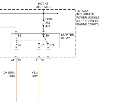

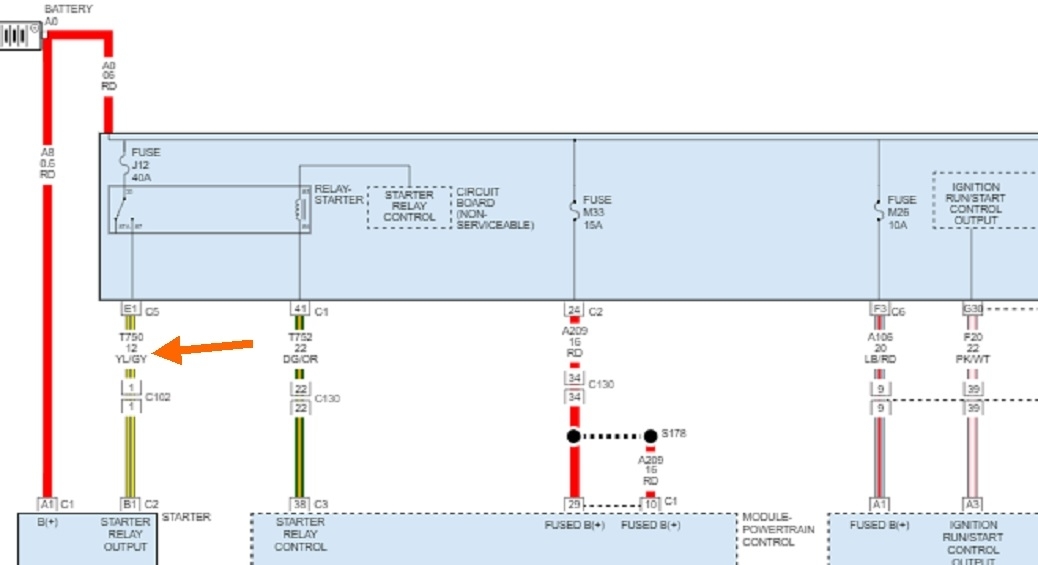

Next, I would suggest checking the starter relay activation.
When the ignition key is turned to the cranking position two things happen.
1. The TIPM supplies 12V to terminal 85 at the relay.
2. The PCM (power train control module) supplies a ground at terminal 86.
If all starting commands have been received:
The PCM will send a switched ground via the dark green/orange wire to pin 41 at connector C1 to terminal 86. See image two of connectors below.
The dark green/orange wire is connected to the PCM at pin 41 connector C3.
The TIPM will switch 12V to terminal 85 internally, see diagram three below.
All these tests can be carried out with a test light.
This is the control side of the relay which in turn will pull in the internal contact to transmit 12V via the yellow/grey wire to the starter.
The above tests will show which module, TIPM or PCM, is potentially faulty.
Code P0750 will not cause a no start situation.
Cheers, Boris

Hello Boris and Randy-
Here are the following description/results of my starter relay testing:
RELAY PINS: (30-85=Coil Side) (86-87=Load Side)
30 (12V Batt Source)
85 (Ground)
86 (Switch source)
87 (Power to load)
KEY OFF/ENG OFF:
30 (11.96V)
85 (.006V)
86 (.000V)
87 (.000V)
KEY ON/ENG OFF:
30 (11.86V)
85 (.648V)
86 (4.30V)
87 (.000V)
KEY IN START/RUN POSITION (with relay in and small wires out for testing)
30 (11.75V)
85 (4.11V)
86 (4.11V)
87 (.001V)
Thats what I got. Keep in bind that I have been operating the windows up and down during the past few days for ventilation- probably why pin 30 shows voltage lowering and I did not perform the tests at the same time. If Im looking at this correctly, pin 85 is ground, but its reading 4.11 Volts when key is in start/run position? This seems like a red flag to me? Looking forward to what you both say about this. Thanks both of you. Have a good day-

Normally these relay coils need 12 volts, but in other applications including the TIPM, they may run on 5 volts. Regardless, the voltage is applied to terminal 86. Terminal 85 has to be grounded, typically by the neutral safety switch, but now by a computer module when it sees the neutral safety switch in "park" or "neutral".
When the ground side is "open", the voltage applied to terminal 86 is "seen" on terminal 85 through the coil. That means the relay has to be plugged into its socket when those readings are taken. If you're finding these voltages with the relay out of the socket, it's due to the computer applying the small voltages to see what happens to it. That's part of its strategy in determining when to set a fault code and which one to set. You'll find those test voltages all over the vehicle where there seems to be no way for them to be there.
Another way to explain this, (or make it more complicated), is to compare it to water flow in a garden hose. For the relay to activate, 12 volts has to be applied to 86. That causes current to flow through the coil as long as the ground path is there. The entire 12 volts is used up across the coil, leaving 0 volts remaining by the time you get to 85. In electronics training, the saying is, "the sum of the voltage rises equals the sum of the voltage drops". In our story we have just one voltage rise, or supply. That's the 12 volt battery. Ideally there's just one voltage drop. That's the relay coil. Undesired voltage drops appear in the form of corrosion and other bad connections. If a corroded relay terminal "drops", or uses up one volt, that leaves just 11 volts to run the coil.

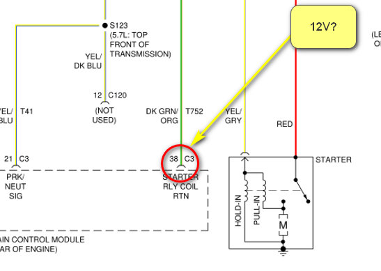

Thanks for the feedback. So, to understand you correctly, in order for the relay to work does there need to be power at 86? Why does the schematic above show 86 as ground then? So, pins 85 and 86 is actually the control side and pins 30 and 87 is the load side? I always thought constant power was on pin 30. As far as the ground goes and the 4.11 volts found; I've always thought that anything over 0.2V on a ground is bad? Maybe I'm just overthinking this and it's something very simple. Do the above results raise any concerns and are they normal? Thanks very much Randy.

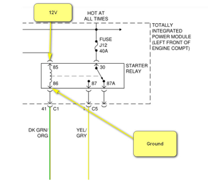

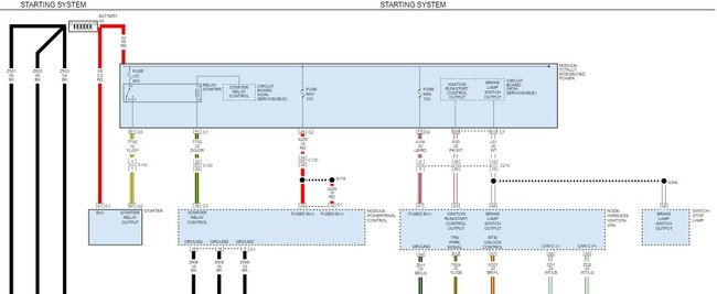

The last diagram is backward. Remember, all relay coils develop a reverse voltage spike when they get turned off, and there's a diode in there to short those spikes out. It is common to not show the diodes as is the case here. Because of that diode, terminals 85 and 86 can't be switched. 12 volts has to come in on terminal 86, and terminal 85 has to get grounded for the relay to energize.
To add to the confusion, we typically draw diagrams to start with the power supplies on top, circuitry in the middle, and grounds at the bottom. Now, with all the computer circuitry, it isn't always practical to do it that way. The 12 volts used to come from the ignition switch. Now it comes from the Engine Computer, (Powertrain Control Module), on the dark green / orange wire. The ground side of the coil is shown at the top in the TIPM. It gets grounded by the "starter relay control" circuitry which takes the place of the neutral safety switch on older models. Once that circuit grounds the relay's coil, the coil is energized. Until that happens, you'll see the 12 volts there that came through the coil from the dark green / orange wire.

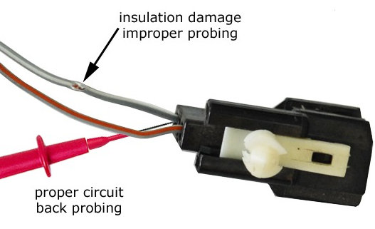

Adding wires to the socket so you can take readings with the relay plugged in is how I do it too. Most voltage readings are only valid when the circuit is "complete", meaning intact and current can flow through it. There are plenty of places where people get "wrapped around the axle" and go down the wrong diagnostic path after getting invalid readings from just part of a circuit. One word of warning though. Forcing a fat wire alongside a relay terminal can spread the female terminal in the socket to the point it makes poor or intermittent connection later. This is even more of a problem on GM vehicles. For those, it's better to wrap the wire around the terminal on the relay first, then install the relay that way. Doing it that way puts no wire alongside the terminals so those in the socket can't spread open.
To address your confusion about testing grounds, I added arrows to this diagram. In that ground circuit, ideally there must be no resistance, (0 ohms). In the real world there is always a very tiny amount of resistance in every wire. When current flows through that resistance, it causes some voltage to be "dropped" across it. Most of the time that voltage is too small to measure, and it has no effect on the performance of that circuit. Wire sizes are selected to be as small as possible to save cost, but big enough to not introduce excessive resistance. The voltage dropped is proportional to the current flowing through it, so as current increases, voltage dropped in that wire increases. Unless specified otherwise by the manufacturer, the industry standard is no more than 0.2 volts is allowed to be dropped in that wire.
One of the secrets to this test is the placement of the meter's probes. Wherever you place them, it's between them that is the part of the circuit you're testing. In this diagram, if one probe is placed at the pink arrow, the tiny area below it is not included in the test. That could equate to testing at the end of the ground wire, but not including the screw that attaches it to the body. If under that screw head is where the corrosion / high resistance exists, the voltage drop won't get included in the measurement, so it will be overlooked. For that reason, I like to put one meter probe right on the battery's negative post or cable clamp. If there's a high resistance problem in those other parts of the circuit, it would affect a lot more things with a lot more symptoms. Instead, we can assume those parts are okay, and every high resistance area will be included in the test.
So, if the meter's probe is on the battery's negative post, and the other one is at the blue arrow, the place we'd typically test at, corrosion and the resulting high resistance at the pink arrow will cause a voltage drop when the circuit is energized. That's the other key point I forgot to stress. Current has to be flowing through the resistance for the voltage drop to show up.
Think back to the garden hose. If you start with 50 psi and the nozzle is turned off, you'll have 50 psi all the way up to the nozzle. Now if you stand on the hose and pinch it off 99 percent, you'll still have 50 psi at the nozzle. 0 psi is dropped across the high resistance, (your foot), because no water is trying to flow through that restriction. It isn't until you open the nozzle, (turn on the electrical circuit), that water pressure is dropped across your foot. If 45 psi is dropped across your foot, that leaves just 5 psi to force water to dribble from the opened nozzle. Water flow, (current flow), is reduced to an unusable level by the excessive undesirable resistance.
The next point of confusion is understanding the difference in measuring a voltage "at a point" vs. "across" something. For this sad example, lets say there's corrosion above the pink arrow that results in a drop of one tenth of a volt. One meter probe is on the battery's negative post. With the other probe, measure at the blue arrow and find 12.0 volts. Next, measure at the pink arrow and find 11.9 volts. Calculating shows there's that 0.1 volt loss. The problem is the meter has a tolerance or accuracy issue where it can be off just a fuzz. With two measurements you have two fuzzes, so in reality you likely have slightly more or less than the 0.1 you calculated. The measurements are taken at two different times a few seconds apart when the battery is slowly running down, or things are turning on or off causing the amount of current to be different between the times the two readings were taken. All of these variables are eliminated when just one reading is taken with one probe at the blue arrow and the other at the pink arrow. Even if current changes or the battery is running down, the variables are eliminated. Just the one reading will show the true voltage drop. 0.1 volts is within the limit and is acceptable.
In the first tests, we took two voltage readings at two points in the circuit, then calculated the voltage drop. At the end, we took just one direct reading across the voltage drop. I should point out too these tests are done to locate areas of undesirable high resistance. Almost all digital meters also measure "Ohms", meaning resistance, directly. The problem is the resistance values can be way too low to measure accurately. It's much more accurate to use these voltage measurements to measure the results of that resistance. Typical meters can measure to the tenth of an ohm, but there can easily be five or more ohms of resistance just in the meter leads themselves. By contrast, a starter motor circuit can be rendered inoperative with as little as a few hundredths of an ohm resistance in the cables. That's way too small to measure, but we can measure the resulting voltage drop. It's with voltage drop tests we always troubleshoot those high-current circuits.
That entire story refers to ground circuits for items such as computer modules, relays, motors, and light bulbs. We want to always see as close to 0.00 volts as possible. Now, we finally get to a different version of grounds. Think back to where you found 4.41 volts on both sides of the relay's coil. We expect to see 12 volts on one side, give or take, and we expect to see 0 volts on the other side, give or take. Relays are pretty forgiving when it comes to that voltage it takes to flip the movable contact. Eight volts is often enough. That means we could have a good three or four volts dropped across undesirable resistances in the circuit and it would still function normally. On older Chrysler products a wire ran from what equates to terminal 85 down to the transmission and its neutral safety switch. The wire, switch, and connector terminals could have a total of a few ohms of resistance, but it wouldn't be enough to prevent the circuit from working. Now the job of the neutral safety switch is being done by the "starter relay control" circuit inside the TIPM, shown at the top of the starter diagram. I can tell you from recent experience that circuit consists of only a relay turned on and off by another computer module. However, a real lot of similar relays on other computers are turned on by their own computer circuits. Those circuits are electrically incapable of drawing the ground side all the way down to 0.00 volts. Most of the time we can't get in there to take measurements, but when we can, it's not uncommon to find well over that magic 0.2 volts. We could even find more than a volt under normal operation. One volt is totally unacceptable in ground wires discussed earlier, but in this case when we talk about ground circuits, we're only interested in whether it's the ground side or the supply side. The exact voltages are of little importance.
That brings me to my last point, finally. That's where you found the 4.41 volts on both sides of the relay's coil. I have a suspicion you found voltages you weren't meant to measure or even know about as they don't help with any diagnostics, and as you've seen, they lead to more confusion. Better to call voltages that low "0 volts" unless you know to expect something else. I think a computer is putting those voltages there, then watching to see if 12 volts shows up from somewhere else, or if one gets shorted to, or "pulled" to ground, meaning near 0 volts. This is better discussed in relation to sensors as it's easier to explain and see. I have diagrams to go further into this if you want me to. To simplify it for now, the computer applies a test voltage to a point, the relay's terminal(s), in this case, through a very large "pull-up" resistor. The resistor is so large electrically that it has almost no effect on the circuit, and it is completely overpowered by the 12 volts and ground when they're present. These pull-up, or test values only show up in a circuit that is not energized or one that has a defect. In this example, he computer knows when it should see 12 volts on one relay terminal and 0 volts on another one, but if it finds 4.41 volts instead, it uses that information to figure out what type of problem is preventing that circuit from working properly. That's how it comes up with such descriptive and helpful diagnostic fault codes. If I'm right, you should find 4.41 volts on terminals 85 and / or 86 with the relay out of the socket.
While much less common, those 4.41 volts could also be "floating" voltages that show up due to all the other interconnected circuitry. We can't actually do any work with those voltages, and of course they do add to the confusion, but proof would be to find the normal 12 volts and near 0 volts when the circuit is activated. Floating voltages are a bigger problem in sensor circuits. When there's a break in the signal wire, you'll still find the correct signal voltage right at the sensor, but not at the computer. The voltage at the computer will "float" to some random value from the other interconnected internal circuitry. If that random voltage falls within the acceptable range for that sensor, the computer will accept it and try to run the engine or circuit on that, but it won't run right. They add the pull-up resistor to prevent that. Once the defect occurs, the pull-up resistor takes over and places, in the case of sensors, five volts on the signal terminal inside the computer. The acceptable range is from 0.5 to 4.5 volts. Five volts is outside that range, so the defect gets detected. This is where you have a fault code describing what's wrong with the signal voltage, you verify that by observing the signal voltage on a scanner, but you think you're going to double-verify that with a measurement right at the sensor and you find the correct, or different voltage there. The cause is a simple broken wire, but this has led to a real lot of confusion even among very experienced mechanics.

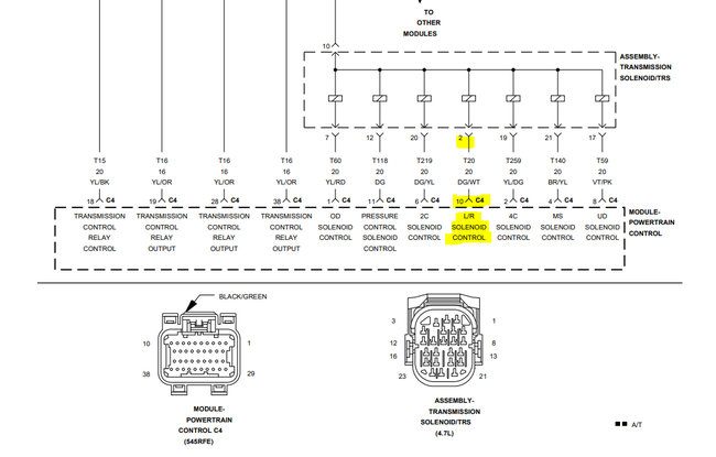

The transmission fault code only concerns me in the respect the computer may not be able to figure out if the transmission is in "park" or "reverse". That, as with the older neutral safety switch, would inhibit the starter system.

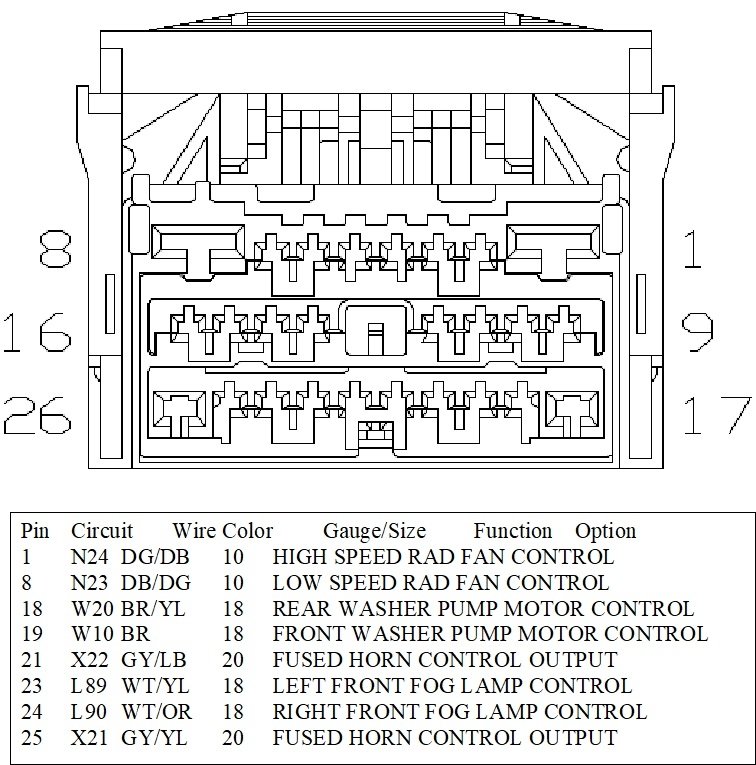

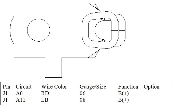

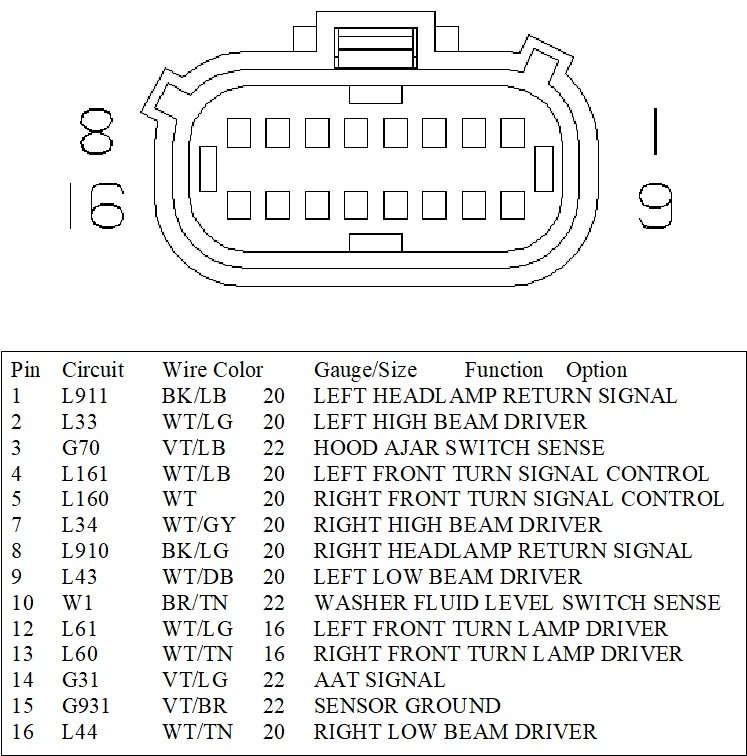

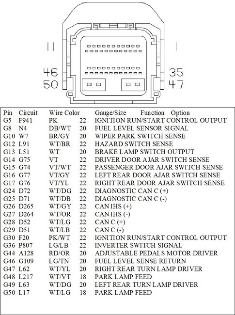

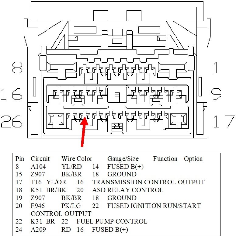

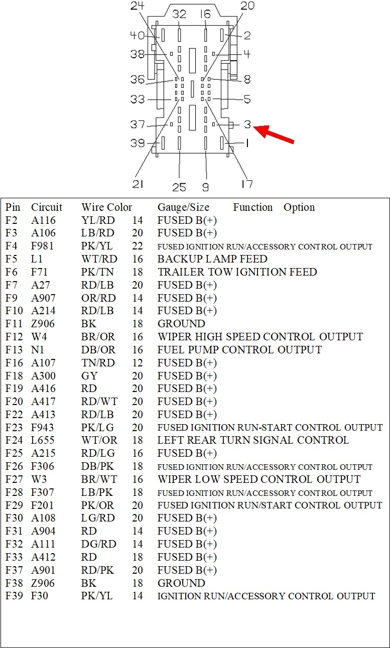

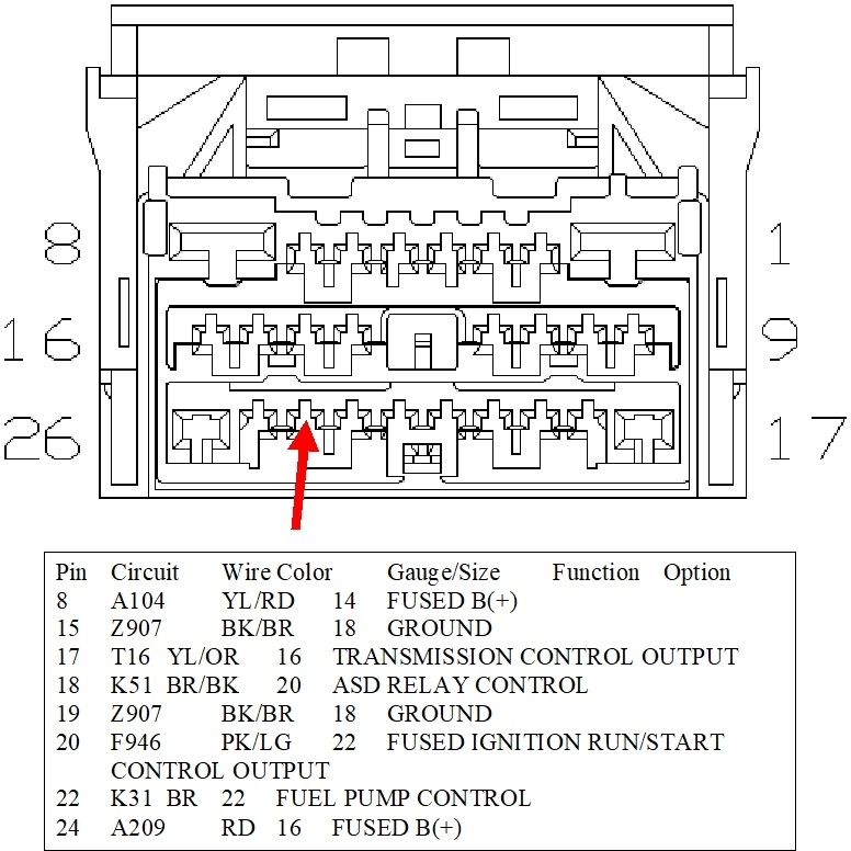

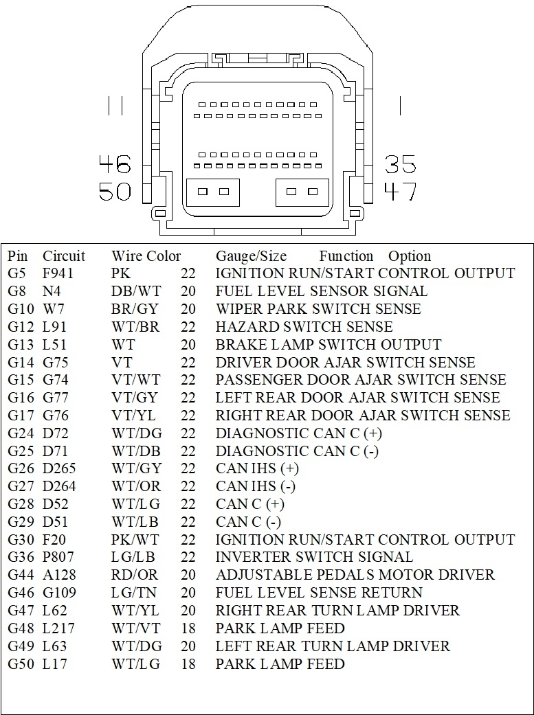

Now I'm going to try to confuse you even more by trying to relate this to the 2015 I was helping with a couple of months ago, then I'll finish up with the plugs you asked about. Remember I found the TIPM's name changed, but they were all listed as being the same from 2010 through 2022, so the operation should be similar too. In that system, the "transmission range sensor" takes the place of the neutral safety switch, and is an input to the Engine Computer. When the Engine Computer sees the transmission is in "park", and the ignition switch is in "run" or "crank", it puts 12 volts out on the dark green / orange wire to the starter relay in the TIPM. Next, the "starter relay control" is just a tiny relay inside the TIPM that turns on when the ignition switch is turned to "crank". That grounds terminal 85 of the starter relay. With 12 volts and ground, the starter relay energizes to send 12 volts down to the starter solenoid. The ignition switch and the starter relay control, (neutral safety switch), have changed places compared to the older systems. That might adjust your thinking as you work through this.

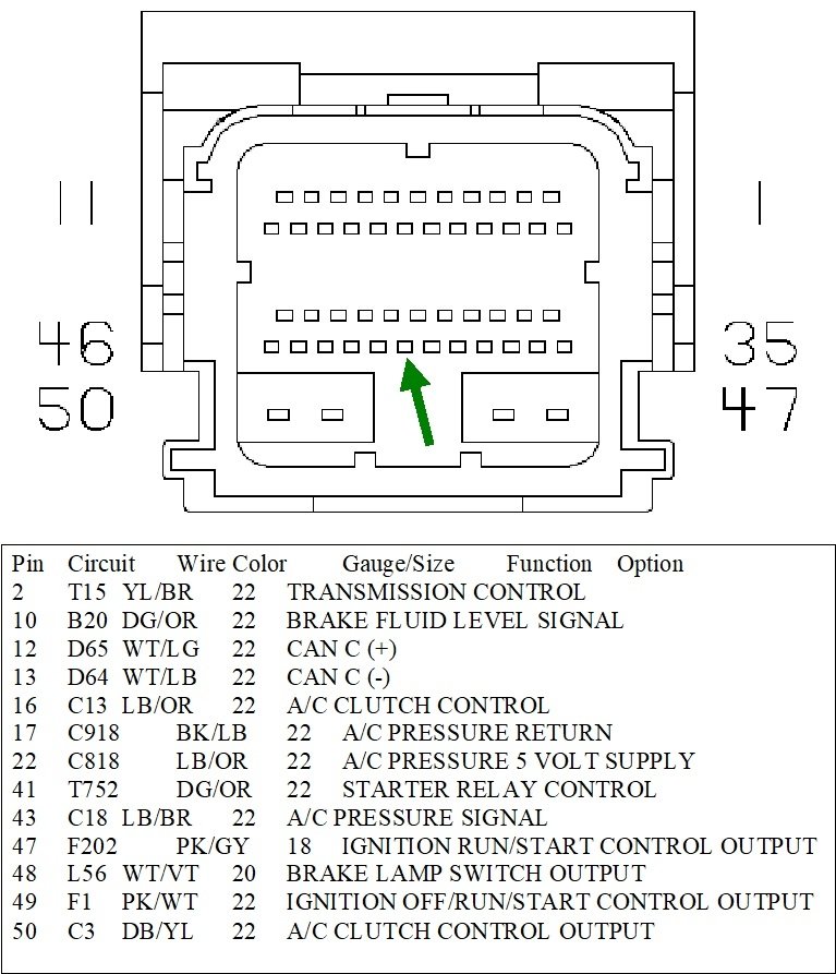

Here's the plugs. I forgot to copy their numbers with the line drawings. They're in order, connectors C1 through C7, and C9. There is no plug C8.

Randy-
Thanks for the connector diagrams. Im an expert at camouflage and M60 machine guns, but this is new to me. Im looking at the first image (green arrow) and I should probably test pin 41 to see if power is getting to the relay, which I assume is, since pin 30 reads almost 12 volts. The second image (red arrow) pin 24 should be battery power because it says "Fused B+", but Im not sure what it powers. The fifth image (orange arrow) pin 1 says "starter relay output", so this is probably a signal to the PCM? Dont know? The sixth image (red arrow) pin 3 says "Fused B+", telling me it is power, but Im not sure for what? All of these connectors tell me that they are used for power, input, output or signals. Yeah, you confused me with all this, but its a learning curve. Shit, and their are a lot of them that are specifically for the ignition and Fused B+? Do you think I should start with pin 41 (Starter Relay Control) on the first image connector at the green arrow? What would be your test method of this?

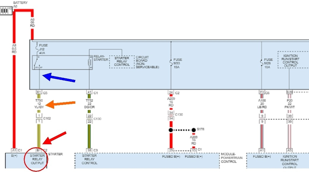

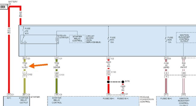

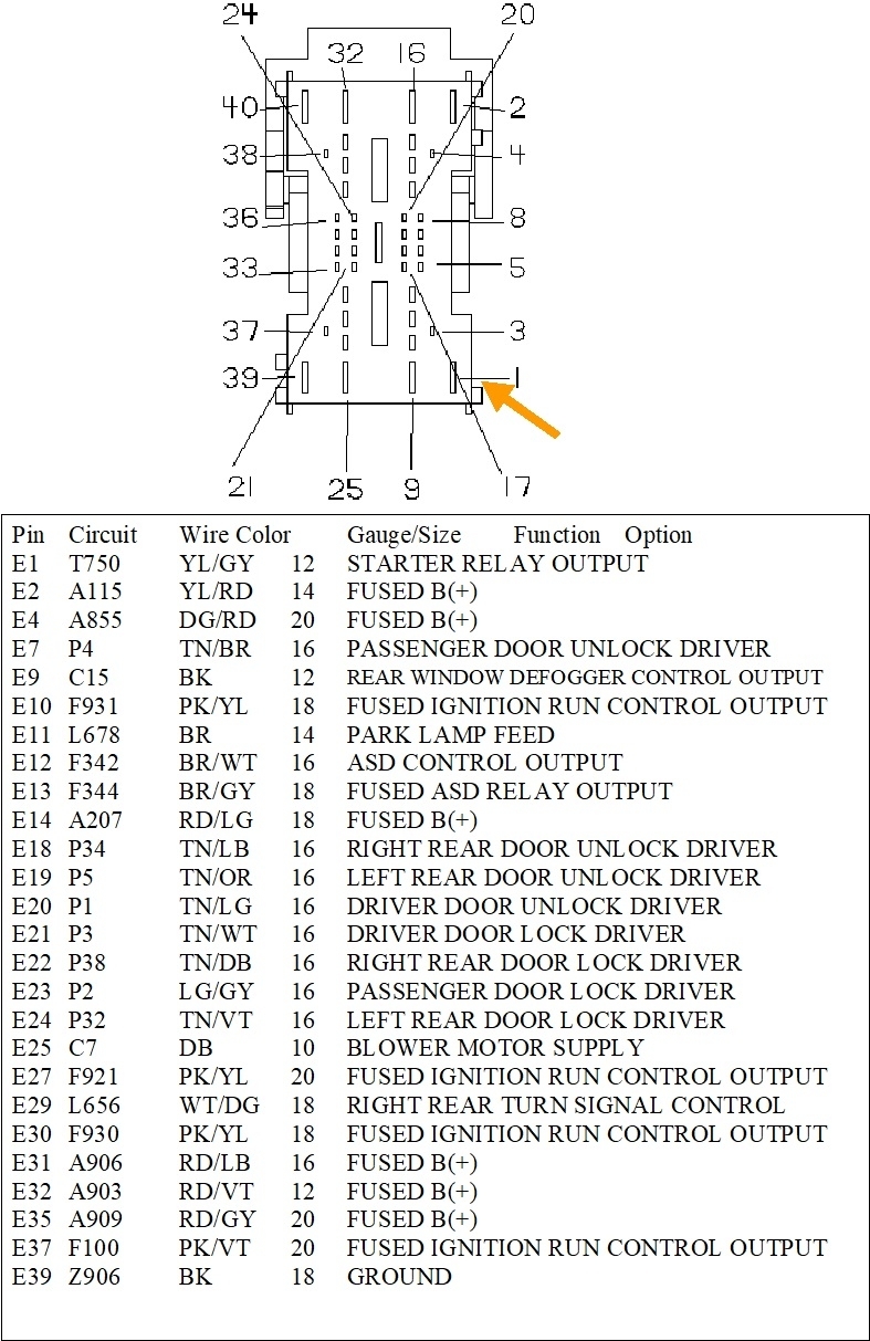

You're being confused by something that confused me for a long time after Chrysler retired the old geezers who knew how to draw diagrams and hired the over-educated college idiots to take their places. All the rest of us see the term, "output" and know it's a signal or voltage going "out" to something else. Chrysler lists the something else as GETTING the output from whatever it came from. Once you understand this, the diagrams become somewhat easier to follow. Here's a perfect example.
When the starter relay activates, it switches 12 volts onto the "starter relay output" terminal, (blue arrow). All of us normal people call that the output terminal from the TIPM, but here that designation is placed inside the starter motor where we would normally label it as an "input", (red circle and arrow).
Terminal 41 gets 12 volts switched onto it when the starter relay activates. We know that's not happening because that's why we're here. You can prove the rest of that circuit is okay by removing the relay, then jumping terminals 30 and 87 together with a piece of wire or a stretched-out paper clip. That will cause the starter solenoid to engage. That also tells us we have to look at the other half of the relay and its control circuits.
Terminal 24, "Fused B+, is the circuit that sends 12 volts to one of the three or four supplies to the Engine Computer. That circuit comes through the TIPM because that's where the fuses live. Engine Computers, aka Powertrain Control Module, (PCM), commonly have four 12-volt supplies. One is always live to maintain diagnostic fault codes and fuel trim data in memory when the engine is off. One gets 12 volts through the ignition switch when that switch is turned to "run". That turns the computer on. When the engine is rotating, (cranking or running), sensor signals tell the Engine Computer to turn on the automatic shutdown, (ASD) relay which sends 12 volts to the ignition coils, injectors, and many other places. One of those other places is a third 12-volt input to the PCM itself to verify the ASD relay did indeed turn on. One of those 12-volt inputs, or a fourth one, is the line the voltage regulator looks at to monitor system voltage.
As a point of interest, (you won't be tested on this later), is the designation "12 volt B+". When portable radios first came out, they used three batteries. The "A" battery ran the filaments in the tubes. Those were very low voltage. The "C" battery ran other circuitry. The "B" battery was the high voltage battery that was needed by the tubes to operate. That could have been over a 100-volt battery. Ever since, the B+ has been used to designate a power supply voltage that runs the main circuitry. In tv repair, we typically said, "we need B+ and ground for the circuit to work".
You're right that a wire can test good for continuity but be shorted to ground or something else. It's more common to find, as I mentioned previously, the entire wire except for one or two strands can be corroded away. That's like thinking there's good water flow from your kitchen sink faucet, so the plumbing is good for fighting a forest fire.

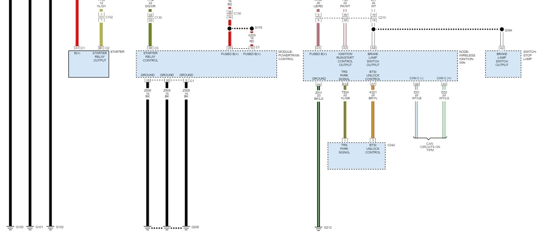

As for how I would approach this, that's the same question we had on the 2015 a few months ago. We started with the scanner to view live data. It showed the ignition switch was sending a digital signal to the Radio Frequency Hub". That module was found to be sending a signal to the Body Computer. The Body Computer sent 12 volts to the TIPM to the "starter relay control" circuitry to tell it to ground terminal 85 of the starter relay. From here the chain of events differs on your model. Part of our problem was in understanding all the abbreviations and icons on the scanner. Another part was in not having the factory training on how the system works.
Another part of the problem is in years past, all switching was done by turning voltages on and off. Today, with all the computers, they communicate with digital signals that we can't read. The only way to know which signals are showing up is to add another computer to the vehicle, (that's the scanner), that can take those digital signals and translate them into messages we can read and understand. Without the scanner, there's really no way to know which circuits are working and which ones aren't.
The only other method, which we don't normally support, is to substitute known good modules to see if one solves the problem. That's fine for my friend who always has a dozen smashed Chrysler products in his yard to rebuild, but often those modules are programmed to just that vehicle and won't work in a different one. For the rest of us, substituting parts is the most costly and least efficient way of diagnosing a problem.
Once we figured out as much as we could, it appeared our problem was caused by the TIPM. In fact, we read quite often people solved their problems with a new TIPM. A good used one seems to have solved the very intermittent problem. Those, by the way, do not have to be programmed to the vehicle's ID number.

Okay, I've been reading up on stuff for a few months now about this generation 4 Rams and have read numerous issues with TIPM's and electrical gremlins. In fact, many have found that on some, the fuel pump relay is built internally in the TIPM and when it takes a shit, they have to make of buy a bypass fused wiring to make it work? Why would someone design it that way to have the fuel pump fuse inside is completely not user friendly? I hope it's not the TIPM- I would not know how much a refurbished one costs. I think this is one of 3 areas:
1. Ignition Switch or WIN (wireless ignition node)
2. Ground from neutral safety switch/trans shift solenoid
3. Connection between PCM and start relay
I'm not sure how and which to check first. What would happen if I spiced into the relay ground wire and ran a separate wire to a good ground?

My experience has been a failure shows up in multiple places, and bypassing one of those places won't solve anything. When ours would not crank, bypassing the starter relay would get the starter to crank the engine, but the engine would not start or run. After sitting a few minutes, the starter system worked normally and the engine would run. At the same time, when the engine would not crank with the key, it still would crank and run normally with the remote start on the key fob. Multiple systems were shutting down intermittently.
If you could find the starter relay control circuit inside the TIPM, and ground that terminal on the relay, the computer is going to see that 0 volts there when it shouldn't be. Knowing there's a defect, it will shut down or disable some circuits.
All three things you listed can be seen on the scanner. You can watch the items change state as you turn various switches on and off or shift gears. There's really no other way to know what's working and what isn't.

I have a cheap Autel Maxisys scanner that is not too bad. When i view "live data" on it, what parameters should i be looking at on the scanner in "live mode"? I've already verified that the starter relay is receiving power at pin socket 30 which is supposed to happen. I've also verified that the ignition switch- (wireless ignition node) has power getting to it. When the key is held in the start/run position, the ignition switch should send battery voltage to relay terminal pin 86. Since I'm only getting 4.11 volts to pin 86 when key is in start/run, this is nowhere close to battery voltage and points in the direction of the ignition switch itself and/or the wiring from ignition switch to pin 86. With regards to most iso relays, this is the sequence-
1. Pin 30 is connected to battery voltage at all times.
2. Normally open terminal (87) is connected to terminal (30) in the energized position, this supplies battery voltage to the starter solenoid field coils.
3. Terminal (86) is energized when the key is held in start/run position which should have battery voltage, and no voltage when key is released.
4. Ground terminal (85) is grounded through the park/neutral/trs (only) when gear selector is in park or neutral position. Continuity should be present from a good ground to relay cavity 85 (ground terminal). If there is no continuity, most likely there is an open or short to the park/neutral/trs from terminal 85.

WIRELESS IGNITION NODE
1- Light Blue/Red- Power (From fuse M26)
2- Empty
3- Pink/White- Ign Run/Start Control Output
4- Black/Lt Green- Ground
5- White/Tan- Can C Bus +
6- White/Lt Blue- Can C Bus -
7- Brown/Yellow- BTSI (Brake Trans Shift Interlock) Control
8- White- Brake Lamp Switch Output
9- Empty
10- Empty
11- Empty
12- Yellow/Dk Blue- TRS Park Signal
Well, at Pin 3 (Ign Run/Start control output) was a reading of 5.98Kohms from the node connector to the TIPM connector pin? BIG RED FLAG
Next- Pin 4 (Ground) was reading 20 Ohms from the node connector to the TIPM connector pin? ANOTHER RED FLAG
These wires travel from the back of the ign switch to the TIPM- the problem is what route they take? It looks like all the wires from the back of the switch get routed up and to the right way up in the dash behind the center console and I'm not sure if they come out the right side engine bay or the left side. What I'm trying to say is that it is going to be a cluster if I got to tear apart the whole dash just to try and do a leap frog testing of 2 small 18 gauge wires. Fun, Fun-
Jun 5, 2022 at 9:24 PM
BORIS K
  • 836 POSTS
Hello
I seem to have confused terminals 85+86.
Terminal 86 is the 12V activation from the PCM, dark/green/orange wire from connector C3 pin 38 at the PCM. The TIPM is switching a ground at terminal 85 when cranking.
The voltage from the PCM at pin 38 is not enough.
I would suggest to check directly at the PCM, pin 38, when cranking/key on if 12V is given there. See image below
If it is then we know that the PCM is outputting the correct voltage.
Next check if 12V is given at the TIPM, connector C1 pin 41. Image 2 below
If 12 v is given at this terminal then this proves that the wire is intact.
If the voltage at the TIPM pin 41 is only 4V then this shows that the wire has a high resistance and needs replacing.
If 12V is given at pin 41 and only 4V given at terminal 86 then this shows that the TIPM is bad
Cheers, Boris

Thanks for getting back to me. Today, I took off the PCM C3 connector and did a voltage reading directly to pin 38 with key turned to run/start- No volts? I'm thinking this has something to do with the P0750 code? What are your thoughts?
Jun 9, 2022 at 6:16 PM
BORIS K
  • 836 POSTS
The PCM connector will have to be connected to the PCM as the PCM will not power up. You will need to back probe the connector at pin 38.
I suggest you use a thin metal pin to gain access and then use the voltmeter and check voltage at the pin while cranking.
Do not pierce the wire, back probe into the connector.
See image below.
Hope this helps.
Cheers, Boris
Jun 10, 2022 at 9:33 AM
HAGMAN
  • 23 POSTS
Yes, okay. I was not sure. I have some probes I can use. I'll check that 38 wire with the harness connected and get back to you. Thanks
Jun 10, 2022 at 11:34 AM
HAGMAN
  • 23 POSTS
Greetings Boris,
Today, I back-probed wire 38 and with key turned to run/start I got .001 volts? So, I started thinking about the P0750 code and took off the PCM C4 connector and started doing ohm on shift solenoids- I forgot which ones, but the first test showed OL. I thought, okay and tested another and got OL and the third one, again OL? I then went underneath and disconnected the TSS harness on side of transmission (very tight space). Took it off and was thinking to hook up the air compressor and try to shoot some air in the pin area of the TSS. I applied air and noticed a few small bits of rock or road debris come flying out. When I went to plug the connector back in, it for some reason was not wanting to go in completely? I pulled the harness side back out and tried again, same resistance, so after the fourth time, I went looking for my inspection mirror and of course, could not find it. Ended up using the wife's small make-up bad mirror and looks like a small plastic piece (which there were a few) that I'm assuming is just a guide to align the pins to the sockets of the harness side was bent? So, I got out from under the truck as other things had to be done around the house. Is it possible that the small plastic piece could have been causing a weak connection? What are your thoughts?
Jun 11, 2022 at 10:22 PM
BORIS K
  • 836 POSTS
I sounds like that the pin you used to back probe the wire at pin 38 did not make proper contact. You had a reading of 4V+ at the starter solenoid terminal 86 before. Have you tried to bridge terminals 30+87 at the starter solenoid socket? With ignition on this should start the motor. Ensure that transmission is in park/neutral before trying this
Code P0750 will not cause a starting issue, it will put the transmission in limp home mode.
Did disconnecting, cleaning and then reconnecting the transmission connector fix P0750?
A good discussion regarding P0750 can be found here:
https://www.ramforumz.com/threads/limp-mode-with-p0750.174265/
Testing for P0750 is done at PCM connector C4(black/green), pin 10, and transmission connector pin 2. Test wire pin to pin for possible open circuit or high resistance, more than 5 ohm.
This DTC is strictly an electrical fault and cannot be caused by any internal transmission failure other than an open in the Transmission Solenoid/TRS Assembly. If the Transmission Solenoid/TRS assembly is in need of replacement — do not replace the Valve Body.
Cheers, Boris
Jun 13, 2022 at 1:44 AM
HAGMAN
  • 23 POSTS
Hello Boris,
The weather here has been hit and miss the past few days. When I tested pin 38 at C4 connector, I could not figure out how to disassemble the harness body, so I pierced the wire as close to the PCM as I could and tested it and got the 0 Volts. I did in fact, jump the relay sockets 30 to 87 and the starter did turn, so I know the starter works fine and the yellow/grey starter solenoid wire is good. I have not tried to re-connect the TSS connector back on due to the weather. Since it is still disconnected, before I re-connect, I'll do what you mentioned above and check ohms from C4 pin 10 to TSS pin 2 and see what I get. I will let you know as soon as this is completed. I again appreciate the help and the diagram you sent. Thanks again Boris.
Jun 13, 2022 at 8:06 AM
HAGMAN
  • 23 POSTS
I did ohm check from PCM C4 Pin 10 to TSS Pin 2 and got 00.5 Ohms. So, that tells me the wire has integrity.
Jun 13, 2022 at 9:18 PM
BORIS K
  • 836 POSTS
Theory of operation to set P0750
The Transmission Control System uses six electronically controlled solenoids that allow hydraulic fluid to be applied to various friction elements (clutches), which enables the gear requested. The continuity of each solenoid circuit is periodically tested. Each inactive solenoid is turned on for a few milliseconds, then off. Each active solenoid is turned
off for a few milliseconds, then on. This pulsing of voltage to the solenoid causes an inductive spike which can be sensed by the Transmission Control System. If an inductive spike is not sensed by the Transmission Control System during the
continuity check, it is tested again. If the test fails three consecutive times, the appropriate Diagnostic Trouble Code (DTC) is set. If the solenoid test is run in response to a gear ratio or pressure switch error, one failure will result in setting the appropriate DTC.
Possible causes:
Related TCM Power Input DTCs Present.
(T20) L/R Solenoid Control Circuit Shorted to other Circuits.
(T20) L/R Solenoid Control Circuit Open.
(T20) L/R Solenoid Control Circuit Shorted to Ground.
Powertrain Control Module (PCM).
Next test at the transmission connector would be to check if any of the other pins has continuity (short circuit) to pin 2. Also test the pins for a possible short to ground or positive.
Test pin 2 to pins 12, 17, 19, 20 and 21.
If no short to any other pin can be seen, then you most likely have a failed transmission solenoid pack.
This will still not cause the non-start.
Cheers, Boris
