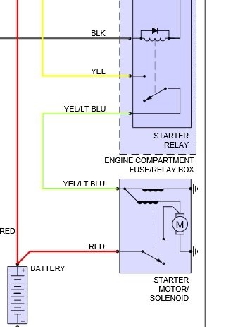

Note the partial starter wiring diagram. There is a starter enable relay for your security system, I didn't think to check location of that relay. I'll have to check.

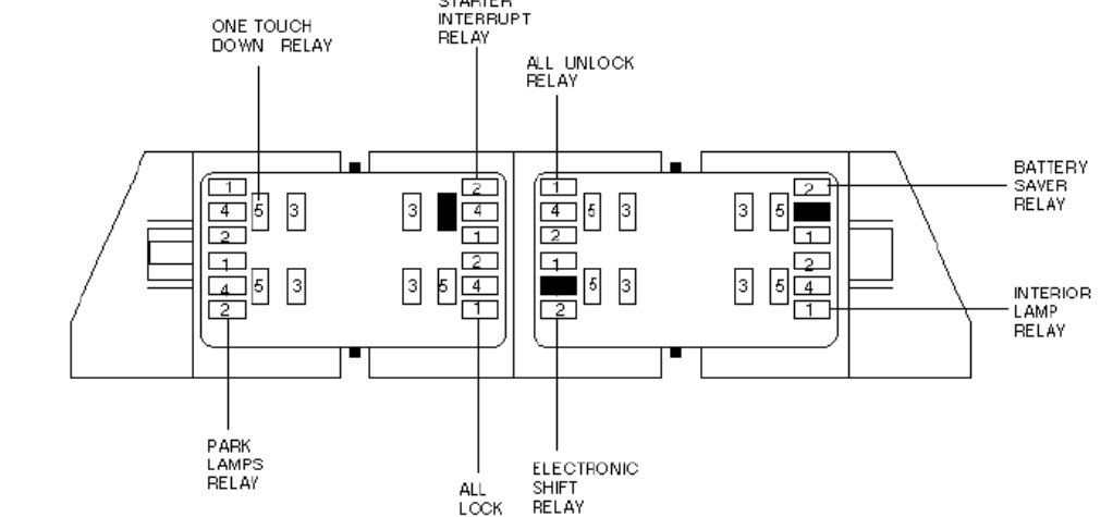

Just to add, there is a relay box under dash, to right of steering column, I believe. That is where the starter interrupt relay for the security system is located.

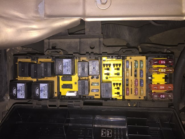

Here is a picture of the fuse box under the hood
Dec 19, 2015 at 1:34 AM
JDL
  • 16,098 POSTS

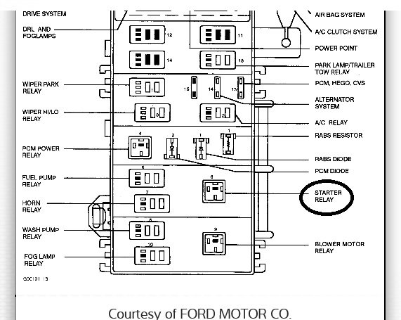

That's a nice picture. Click on the link for location of starter relay in under hood fuse box.
I doubt the problem is the relay, but, you never know. Look at the starter relay and blower relay, if both are the same, swap-em, see if it changes anything?

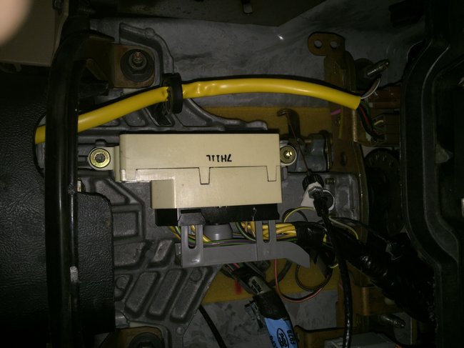

Starter checks out good, you said in a previous post, "Just to add, there is a relay box under dash, to right of steering column, I believe. That is where the starter interrupt relay for the security system is located." would this be it, see picture
Dec 21, 2015 at 3:33 AM
JDL
  • 16,098 POSTS
I don't know? My info shows this.
Dec 21, 2015 at 5:38 AM
KWDAYE
  • 10 POSTS
Thank for all your help but I finally figured out what the problem was. It was the switch on the steering column for the shifter, that tell it that it's in park, that's why it wouldn't do anything.
