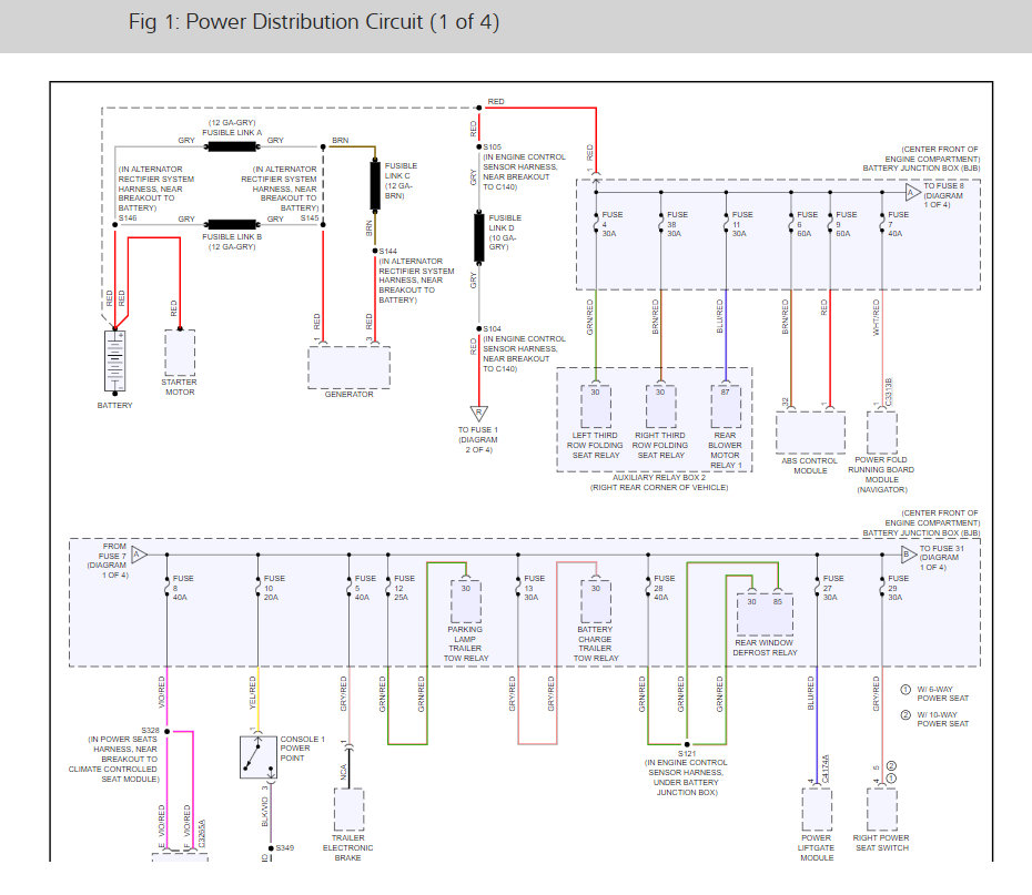

No power to some fuse panel fuses
2007 LINCOLN MARK LT
95,000 MILES • 5.3L • V8 • 2WD • AUTOMATIC
LARESNACHO
The fuses are not blown but they have no power to them fuse #7,8,36,35,42.

There is a main battery feed that must be off or shorted. here is the power distribution wiring diagrams so you can see how it works and where to look for the failure. this guide will help as well:
