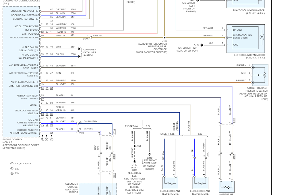

No power to low pressure switch?
2017 GMC SIERRA
100,000 MILES • 5.3L • V8 • 2WD • AUTOMATIC
ROY JR MARTINEZ
All fuses and relays good. Controls all light up, three wires at pressure switch. Checked each with a test light none lit it up.
Apr 29, 2023 at 11:14 AM
  • 55,224 POSTS
There is no 12-volt power that goes to the A/C pressure switch, there is a 5-volt reference, a pressure signal and a low sensor reference. Here are the wiring diagrams for the pressure sensor so you can see for yourself. Check out the images (below). What kind of problem are you having?
