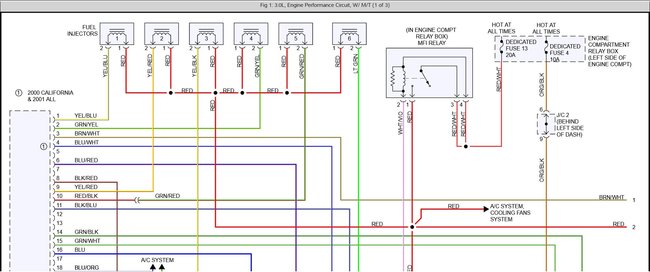

I have a Spyder gt and It’s the 3.0 6g72 SOHC. It randomly stalled out in my driveway about two weeks ago and I cannot figure out what’s wrong with it. It’s not getting spark or fuel. I first replaced the fuel pump, Then distributor cap and rotor and almost every relay, and then replaced the crank sensor. Yesterday I just discovered I have no power going to my ignition switch but I do to my alarm system. I’m stumped.

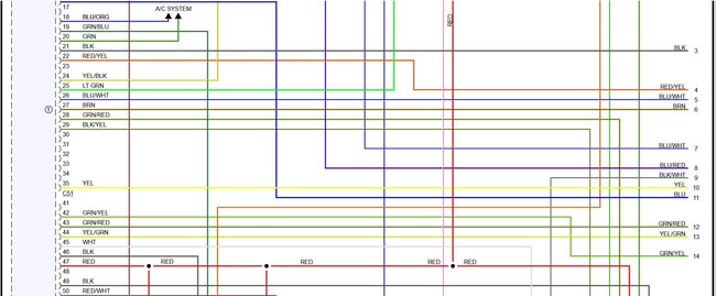

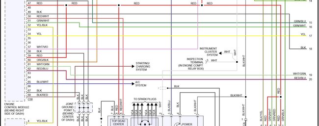

Here is the complete wiring diagram for the ignition system. You will need the first and last page for testing.
On first page test the following.
Fuse #13 and fuse #4.
On last page test.

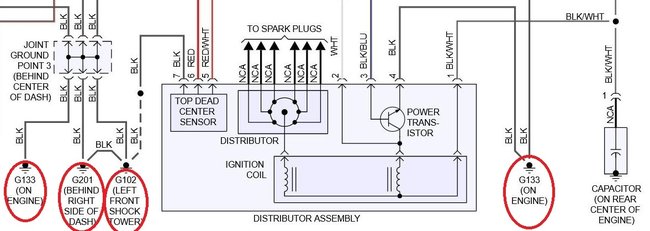

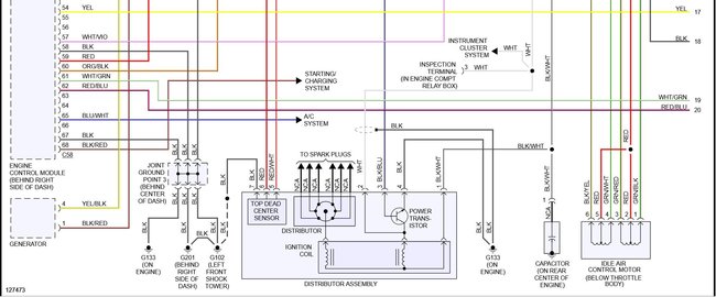

G133, G201, G102. Test these to the battery, to the body, to the motor and to the frame. You should read 0.04 ohms to each location. Anything over that is a bad ground.
TDC sensor should have 12 volts at the red wire.
Power transistor should have 12 volts on black/blue wire.
Replace the capacitor coming off the power transistor.
If all this checks out I would say the power transistor or the coil has failed.

Sorry to take so long to reply had a hiccup with family health. but I have yet to test these yet. but I did a cam sensor test and it may be useful information but I got 12v from the hot wire on the distributor plug and then I did the ground which was supposed to be around a 2ohmns and it read around 15. I do not know what would cause that other than a bad ground and I cannot figure out where to look for it.
Feb 21, 2020 at 6:23 PM
94 TRANSAM
  • 680 POSTS
See diagram below. Ground locations are circled in red.
