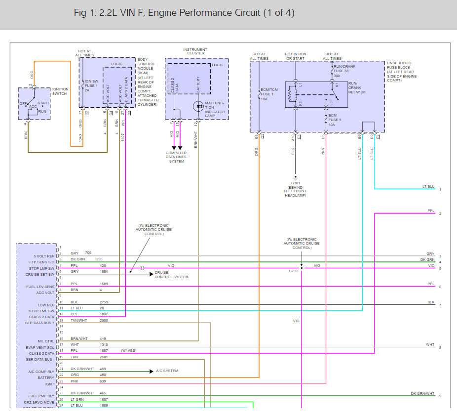

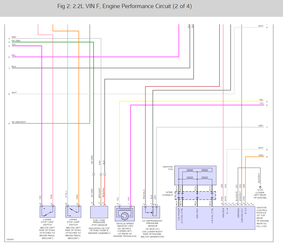

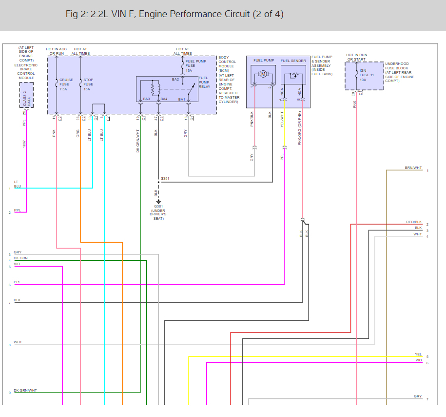

Getting no power to fire spark plugs. Got the constant twelve volt power going to ICM but not to spark plugs. Cranks over and has fuel. All fuses are good. Just has no to fire spark plugs. Changed ICM and coil pack.

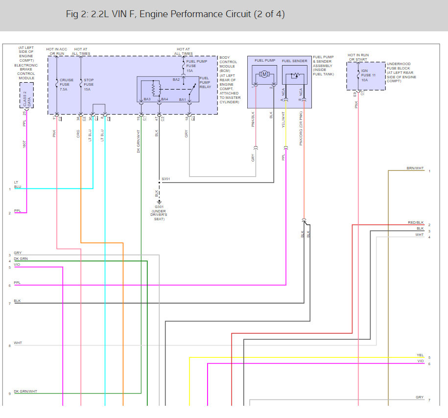

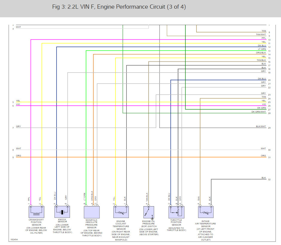

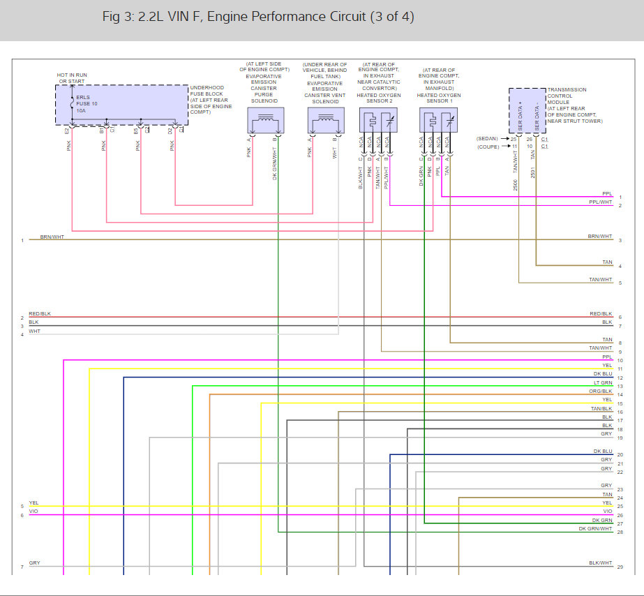

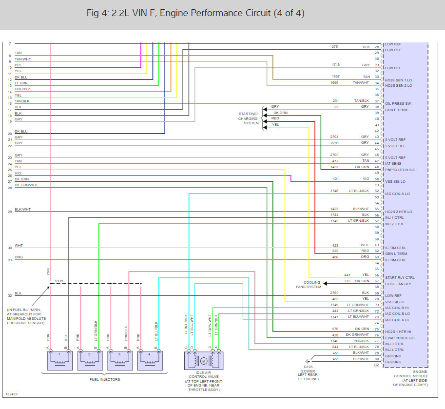

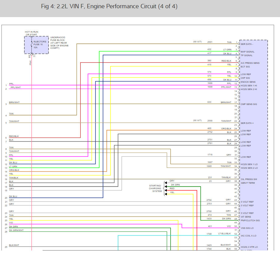

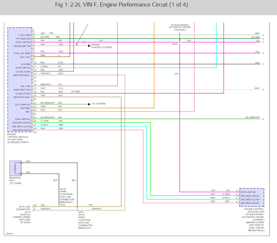

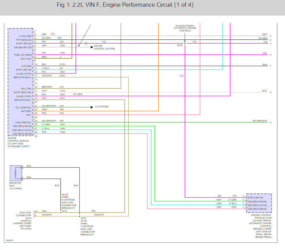

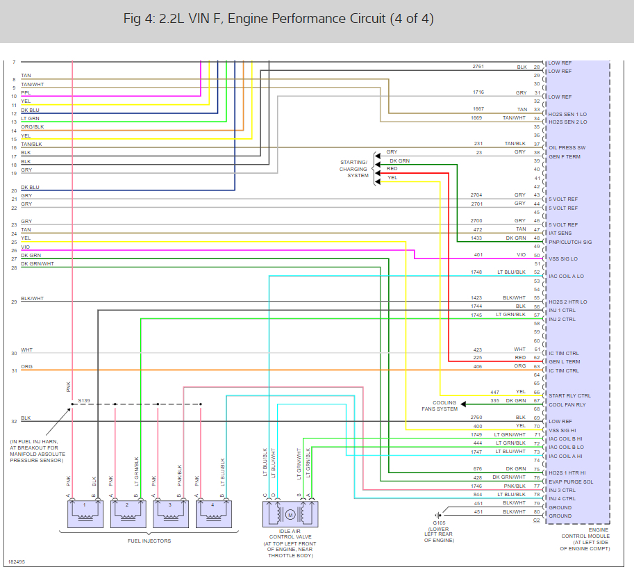

Lets check the wiring for the system to confirm and if okay I believe the PCM has gone out. Here is a guide and the engine wiring diagrams to confirm the issue. Check power and grounds for the PCM.
