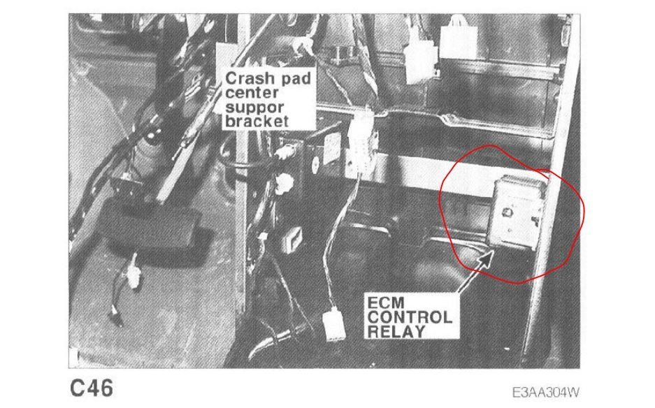

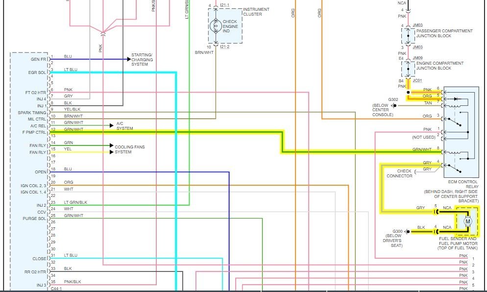

I overheated the engine. Removed cylinder head and had milled flat. Put back together with a new crankshaft position indicator, and camshaft position indicator. I do not get any power now to fuel pump. I towed the car home after it overheated, 800 mile tow. And ran over some pretty bumpy ground. Could I have activated the Inertia Fuel Pump Shut Off switch on the bumpy roads? Does this 1999 sonata have such a Fuel Pump cut off switch and if it does, where is it located? I cannot not find it.
Aug 23, 2020 at 7:11 AM
Good afternoon,
There is no fuel shut off switch for the fuel system
I attached a wiring diagram for you to view.
Can you do some testing with a voltmeter or test light?
