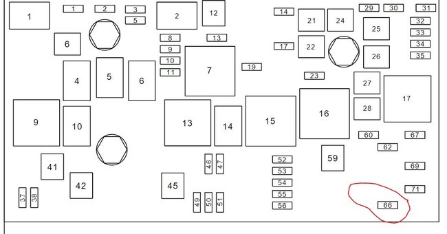

Trunk not opening with remote, or button on dash. Keyless entry for trunk as well. Relay clicks . Used dmm to test fuse and the 10 amp fuse is not getting power (fuse is good).
Aug 9, 2020 at 6:02 AM

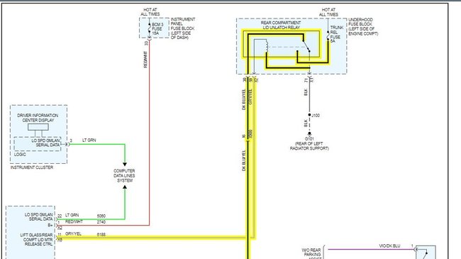

Good afternoon,
The trunk release is controlled by a different fuse. I attached the diagram for you to view.
Is this the fuse you tested for power?
Aug 9, 2020 at 7:59 AM
EVANGONZALES89
  • 5 POSTS
It didn't let me specify that it was a limited edition. Old body style. The fuse pattern is not the same....

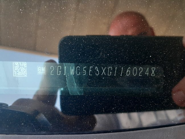

Can I have the complete VIN number?
Aug 9, 2020 at 8:47 AM
EVANGONZALES89
  • 5 POSTS
Here is the VIN. Thanks in advance for trying to help me.

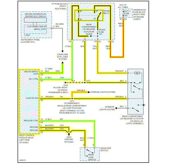

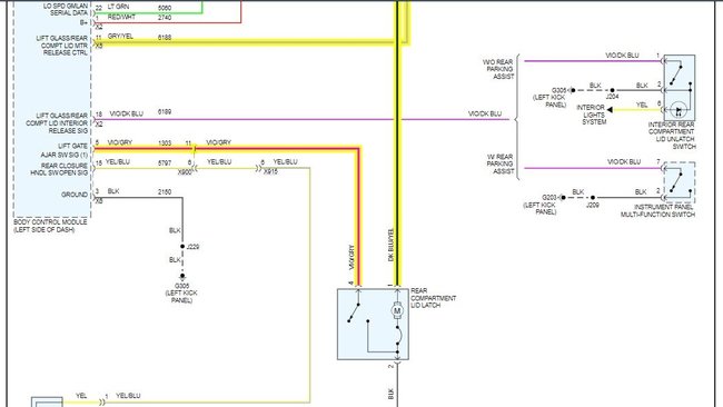

I attached a diagram for the trunk release based on your VIN. The body control module is what controls the operation based on the input from the switch or the remote.
Aug 9, 2020 at 11:50 PM
EVANGONZALES89
  • 5 POSTS
So you think there might be a issue with the BCM itself?
Aug 10, 2020 at 12:09 AM
Correct. You would need a scan tool that can read live data from the BCM to be sure it see the signals from the switch and the remote.
