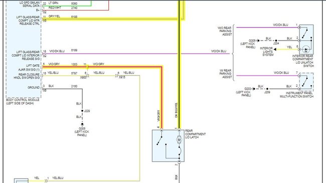

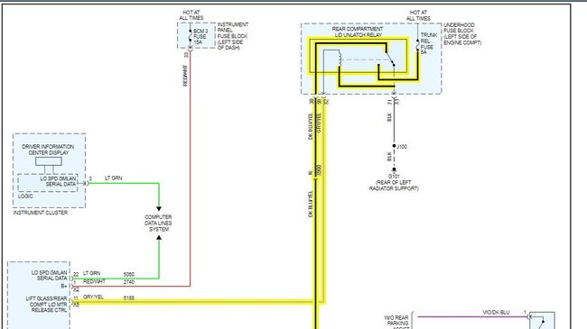

The trunk release is controlled by a different fuse. I attached the diagram for you to view.
Is this the fuse you tested for power?

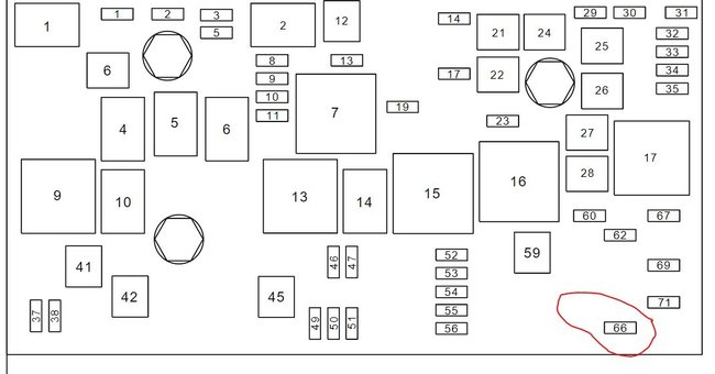

It didn't let me specify that it was a limited edition. Old body style. The fuse pattern is not the same....

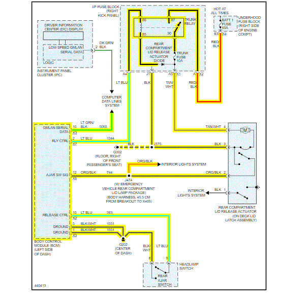

I attached a diagram for the trunk release based on your VIN. The body control module is what controls the operation based on the input from the switch or the remote.
Aug 9, 2020 at 11:50 PM
EVANGONZALES89
  • 5 POSTS
So you think there might be a issue with the BCM itself?
Aug 10, 2020 at 12:09 AM
Correct. You would need a scan tool that can read live data from the BCM to be sure it see the signals from the switch and the remote.
