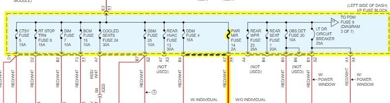

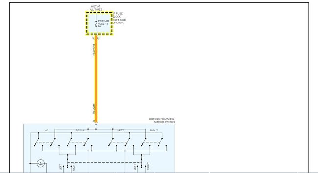

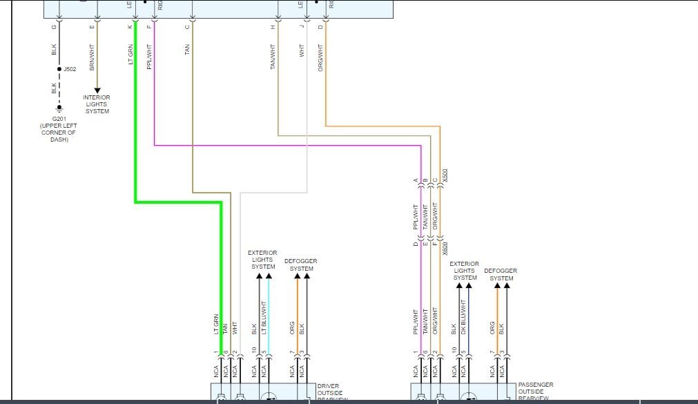

Both of my outside mirrors have no power at the fuse inside the truck.I have installed new switch inside door panel,to no avail.Everything else works.Got any suggestions? Is there a relay in fuse block under hood?
Feb 25, 2020 at 11:07 PM
Good morning.
If you have no power to the fuse, you may have a bad fuse block. I attached a diagram for you to view. Check any of the other fuses for power at the fuse block.
