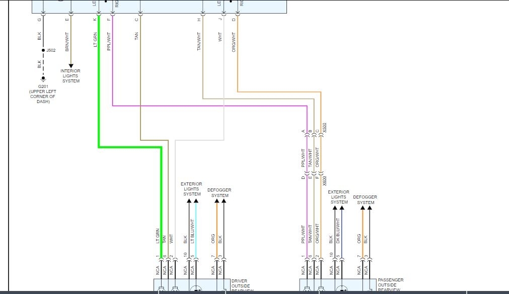

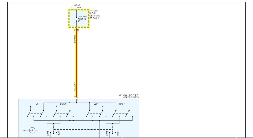

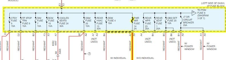

Both of my outside mirrors have no power at the fuse inside the truck.I have installed new switch inside door panel,to no avail.Everything else works.Got any suggestions? Is there a relay in fuse block under hood?

If you have no power to the fuse, you may have a bad fuse block. I attached a diagram for you to view. Check any of the other fuses for power at the fuse block.
