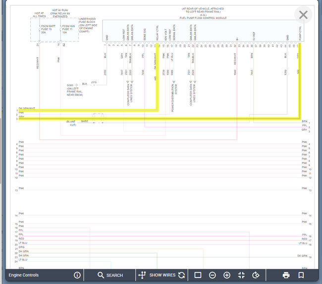

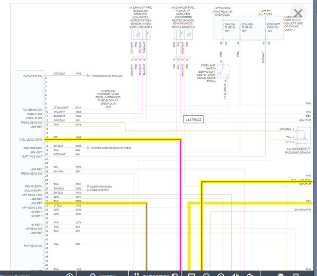

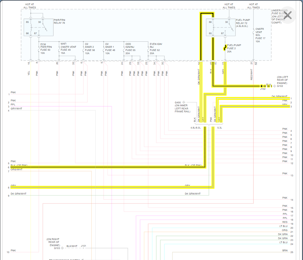

Got some weirdness. Everything pointed to a fuel pump. No pressure at the schrader valve on the fuel rail. 12v at the relay, 0 ohms over to the 20a fuse. The other terminals of the relay get 5vdc when the key is turned to crank.
Cut hole in floor of van (i have no lift), replaced pump. Same issue. Checked wiring at pump, no voltage at the pump!
Digging deeper, changed with known good relay, same result, confirmed the 30 spade gets 12vdc. Jumped 30 and 87, confirmed 12vdc at the fuse, and fuse good.
Here's the weirdness: When the key is off and out, both terminals of that fuse are seeing 4-5vdc. When the relay is back in and the key is turned im only getting 7-8vdc. I don't know if it is related or not. When I am trying to take apart the fuse box with the 3 10mm bolts, when they are all loose, nothing works, dash dead, key gets nothing. Should those bolts control the power flow of that whole fuse box? How does that box come apart?
I'm thinking corrosion in the box. What else can I test?
Friday, August 6th, 2021 AT 8:22 AM
14 Replies

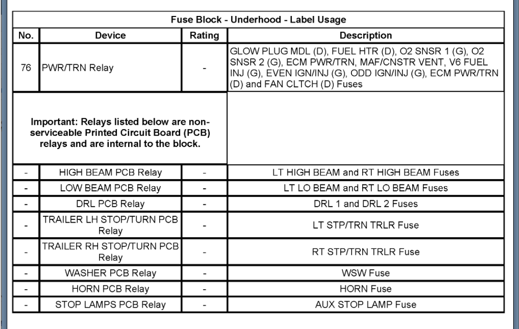

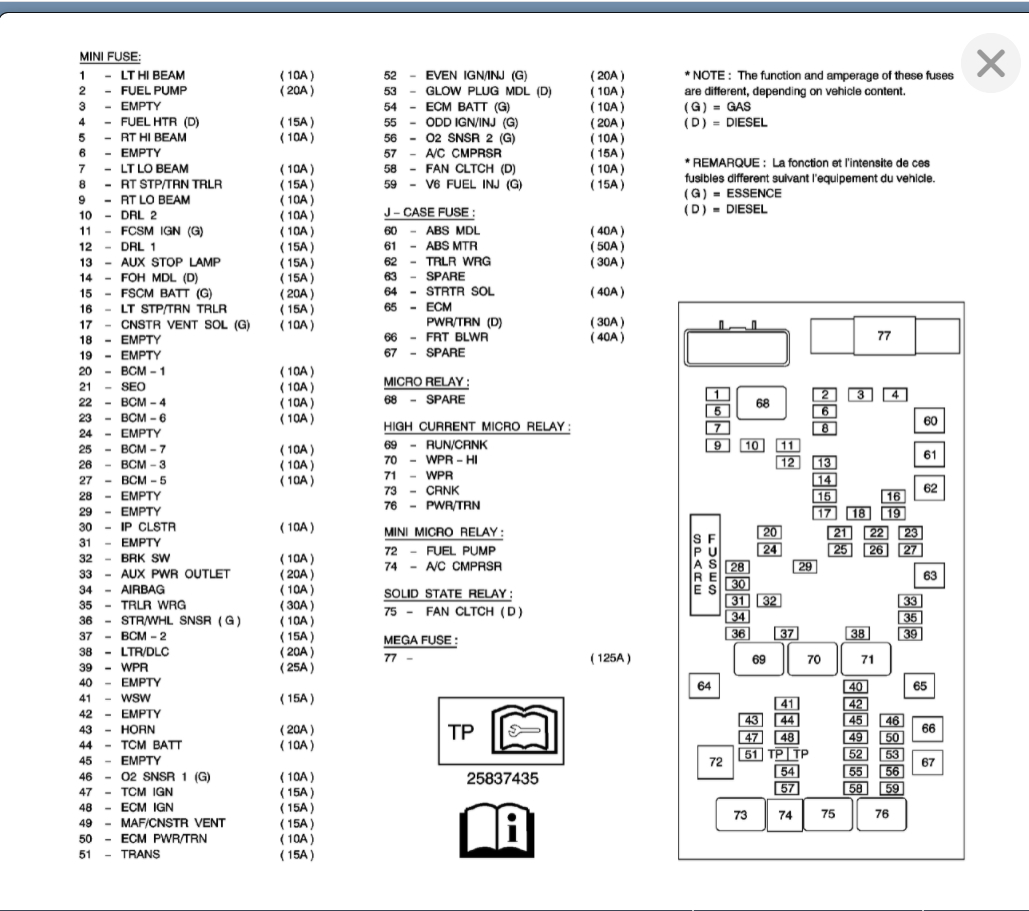

I think you are exactly correct. There is resistance in either the wiring or the control panel/circuit board.

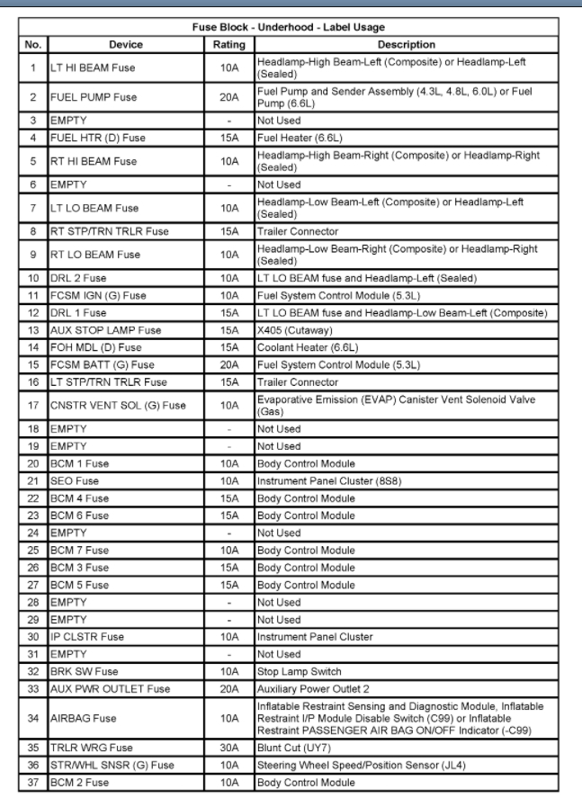

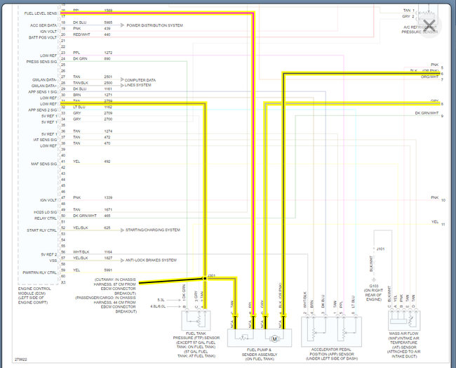

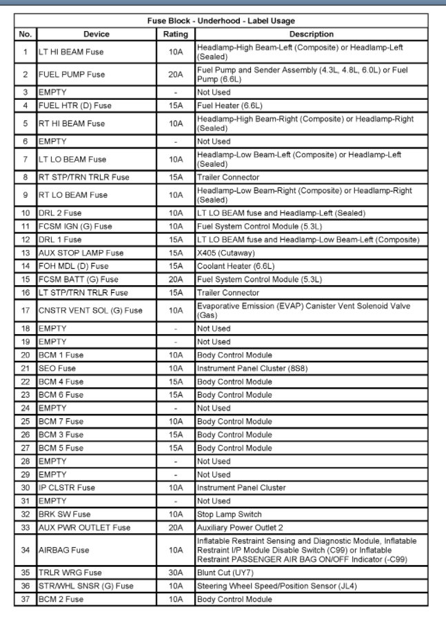

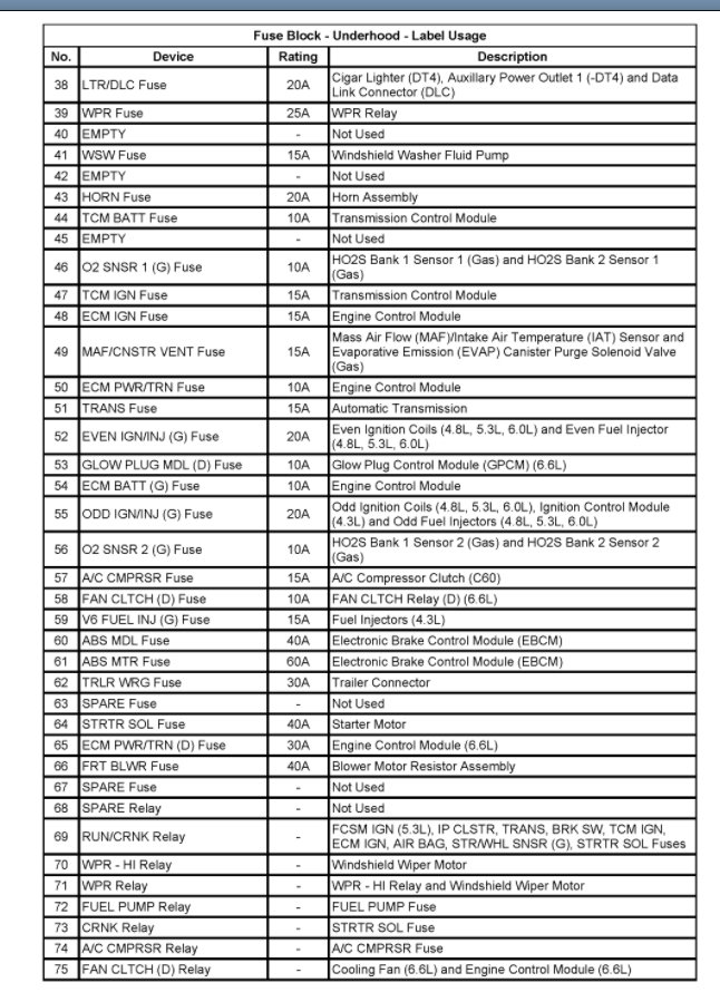

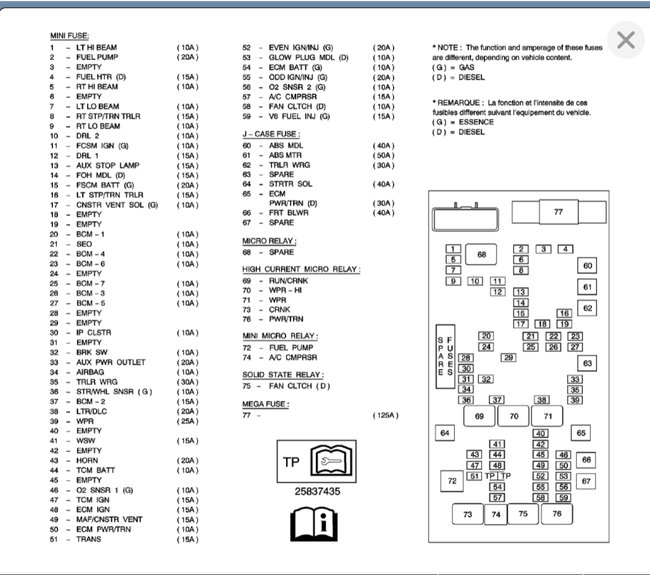

I am attaching the wiring diagram below and the fuse layout if you need (appears you don't).
Unfortunately the manual does not include a process on how to disassemble the fuse box as that is not a common repair. The OEM just recommends replacing it if there is an issue.
However, if you are removing the relay and still have voltage on the fuse 2 then you have a short on the circuit board that is allowing voltage through even though the connection is supposed to be remove.

What I would do in this case is just wire in an external relay. Basically if there is an issue with this board then you don't need the relay to run through it. You can just take each of these wires and cut them going in and out of the fuse block and wire in your own relay and fuse so that it avoids the issue.
If you are interested in doing this, let me know and we can help with questions. However, there are many kits out there. I included a picture of one below.

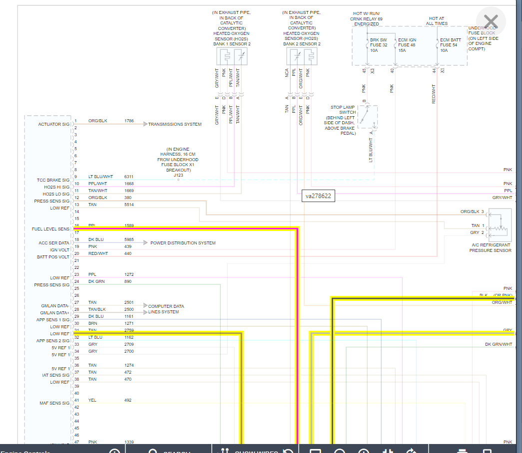

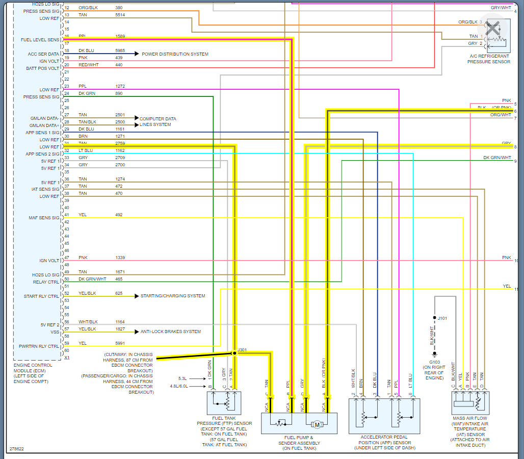

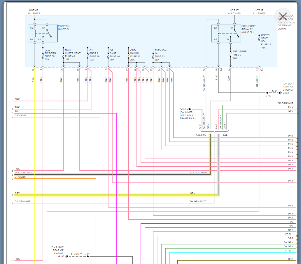

That is interesting. Where exactly did you find the corrosion?

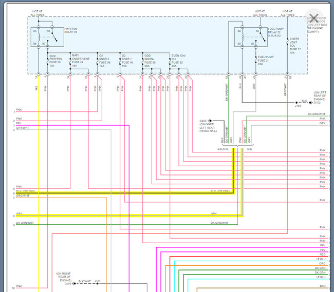

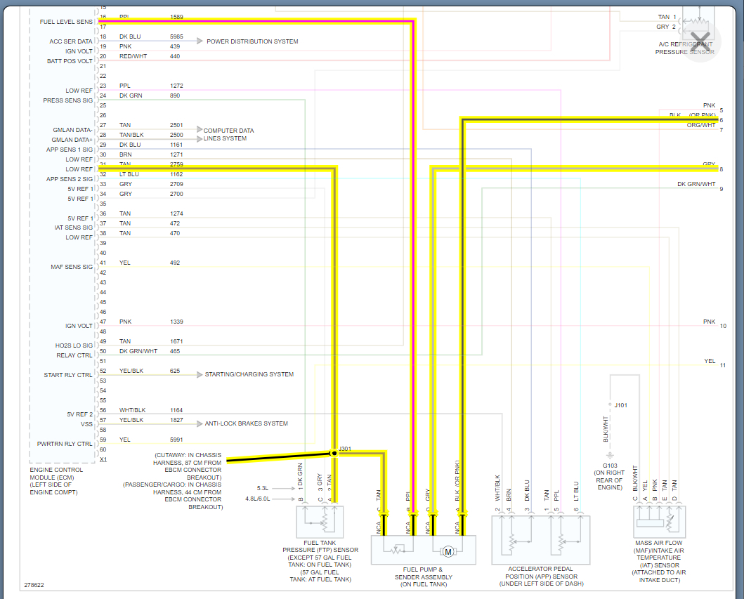

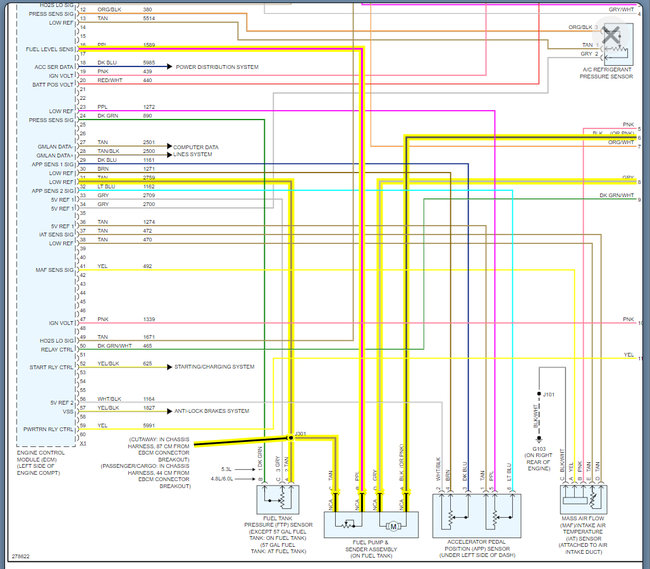

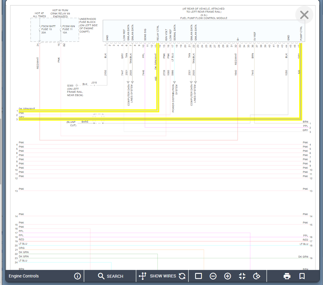

I suspect that is still the issue. I bet if you check the fuel pressure it will be low. Then if you check the voltage at the pump, that will be low as well. Which points to more corrosion or the connections are just not salvable.
I attached the wiring diagram below but try using starter fluid in the intake. It may fire without the jump box on it and if it does then that is the issue.

So, here's the update: The customer contacted GM. They got a new fuse box assy. Still did not fix it. He shelled out a lot of money for the dealership to throw their hands up.
He then somehow found an automotive electrical whiz near him that chased down (from what I'm told) three bad grounds and things work great now.
So, that. Well, I'm happy I did not spend more time on it.
