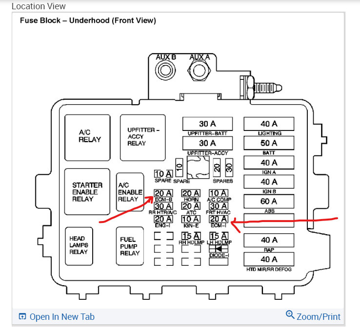

I'm looking for a wiring diagram for the vehicle listed above. I am dealing with crank runs then like 2 seconds later. I thought it was probably a pass lock issue, but I tried the 30 minutes relearn and didn't change. Fires right up then seems like fuel pump isn't working. So, I was trying to jump the relay but like a rookie I accidently jumped 86 to 30 and it sparked not no power. To the relay not constant or when turn the key. So, I'm assuming I blown something, hopefully a fuse. But all the simple fuses look fine. Where should I start to look?

All of the power leads for the fuel pump relay come from the PCM I would check the fuses ECM -B and ECM -1 for power on both sides here is a guide to help. The fuses are under the hood in the main fuse panel.

Thank you! Okay, so, I did what you said and found blown fuse replaced it. Got power back to fuel pump relay, I jumped it correctly with in fuse wire this time (should of the first time lol) pump turns on and stays running. Tried to start it while bypassing relay but still just shuts off right after startup. To me sounds like it's the stupid pass lock system. Because with everything else working fine it must be shutting off injectors due to the pass lock, right? I haven't tested the power to the injectors yet but even if one or more was not working the van wouldn't just shut off it would run badly, right? I don't want to have to text info if not necessary, it looks like there kind of hard to reach and probe. I have tried the pass lock relearn but maybe I missed something? Any ideas?
