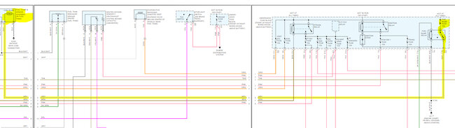

Conducted a continuity test from pump harness to wires at back of junction box in floor positive side ground side all beep and pump runs strong with power connected from a battery test light fuse 1 under hood good probed relay pin87 has power jumped pin87&30 no power at pump but when do the continuity test from ground side of junction pin the frame it beeps swapped relays and also Replaced with a new one still no power to pump.

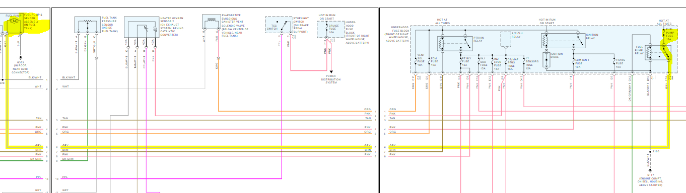

Pins 87 and 30 are the secondary side of the relay. If you have power at 87 and jump power to pin 30, the pump should have power. If it doesn't, you have an open circuit between the relay and the pump. See pic below.
What do you mean when you say the ground side to the frame has continuity? If you are checking pin 30 to the frame, you could simply have a broken wire that is shorted to ground.
If you run 12v from the battery to connector pin 30, does the pump run?
See pic below.
