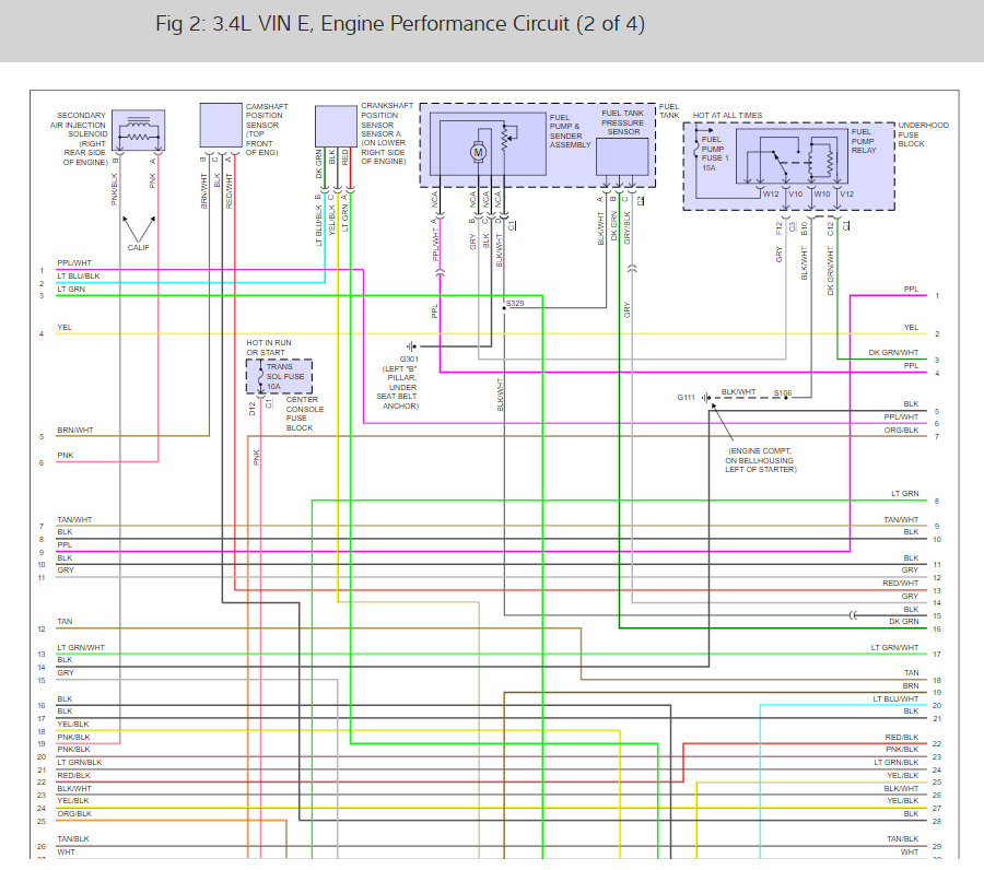

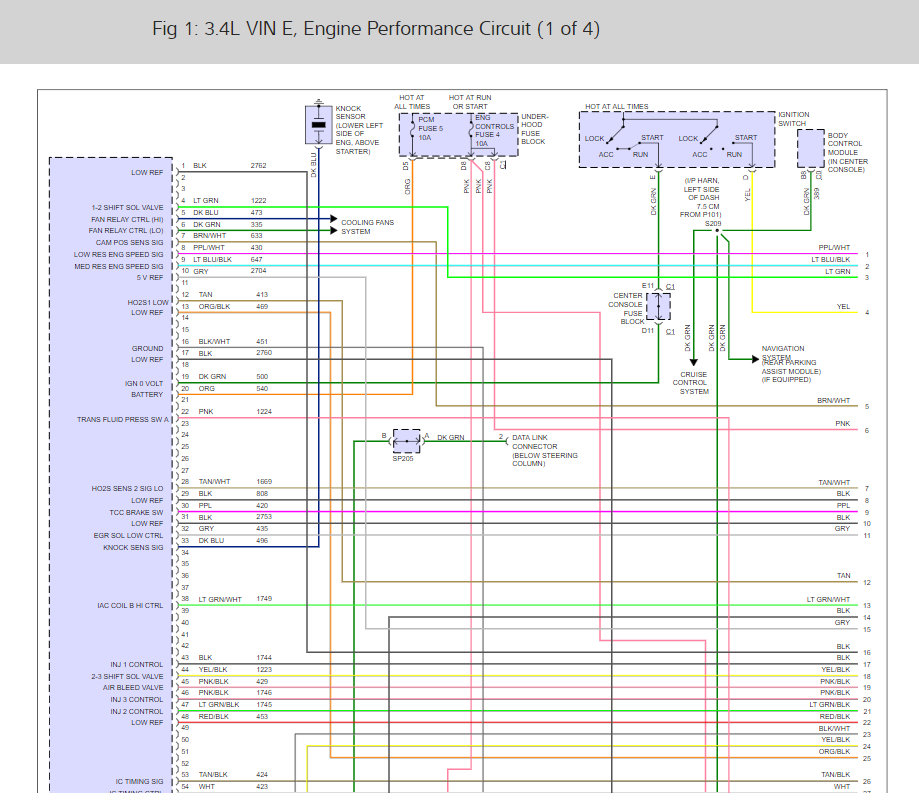

No power to fuel pump. Pump does work, wiring harness is good. Replaced fuse and relay. Cleaned connectors at main harness connector. Replacing connector would mean splicing wires. How or what else can I do?
