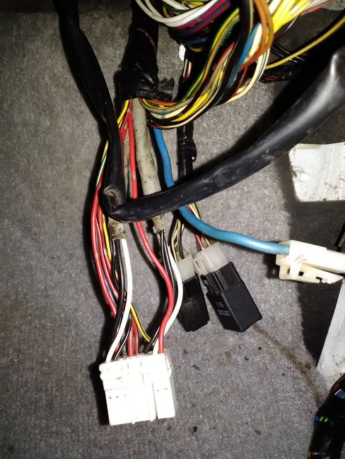

Okay. So I got under the passenger side of the dash and checked out the wires were the MFI and fuel pump relay are so there is no plug for the fuel pump control module only this plug, I unloaded pics of the plug in question, van you identify this plug? Its right there by where the fuel pump control module plug should be, everything else is there and plugs in and fits. thanks for your help.

Okay, great thank you. any ideas on the electrical connector I sent you pictures of?
Thank you
Dec 19, 2018 at 11:38 PM
DANNY L
  • 5,648 POSTS
Hello again.
Did you check to see if it might be a harness to connect to the HVAC box or blower motor? I've attached a photo with harness/connector information.Hope this helps and thanks again for using 2CarPros.

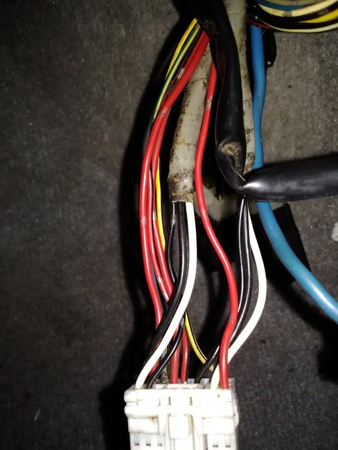

The picture is kind of dark. Can you take another picture showing the wire colors on the undetermined plugs? If you upload another picture I'll trace the colors on a wiring diagram. Hope this helps and thanks again for using 2CarPros.

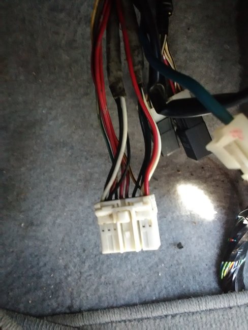

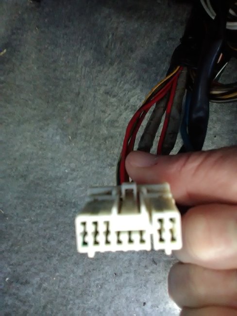

Danny,
Here are better pictures:

Hello again.
Another question. Does this have an aftermarket or stock radio? After looking at the radio wiring diagram it looks like the factory radio amplifier harness.. I've attached a picture of the diagram. See if the wire colors match.Otherwise I'll keep looking.Hope this helps and thanks again for using 2CarPros.Happy Holidays!

Hi Danny,
Okay yes, it has a factory radio, CD player and an AM/FM radio, I will check.
Dec 30, 2018 at 7:03 PM
DANNY L
  • 5,648 POSTS
Hello again.
It sort of looks like the factory amplifier connector. Hope this helps and get back to me.Thanks again for using 2CarPros.

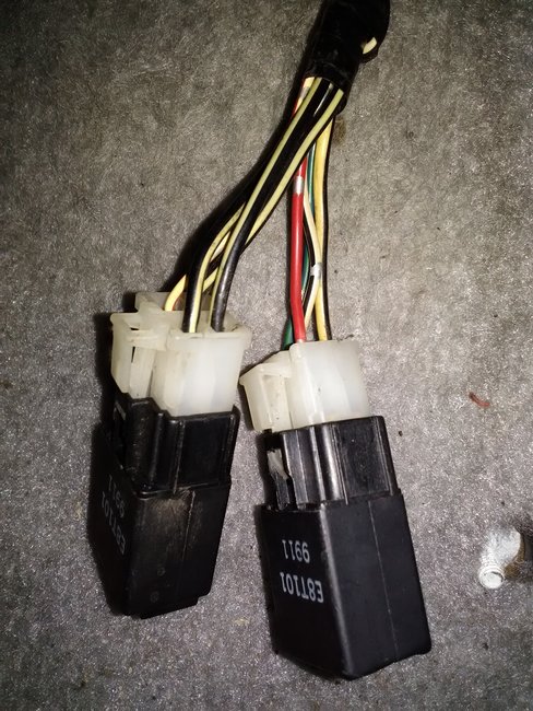

Okay, thanks my Monty doesn't have a amplifier I don't think. Okay, so this harness does not have a circuit for the Fuel Pump Control Module then so it should work?
Dec 31, 2018 at 6:02 AM
DANNY L
  • 5,648 POSTS
It only shows having both fuel pump relay and fuel pump module. Both behind right kick panel. Pictures with wire colors below.

Hello again.
I looked at a Montero Sport and they come with a 3.0 liter motor and a 3.5L. Couldn't find a fuel pump control module on the 3.0L application. That might be what that harness is far.Will look more into it tomorrow. Again thanks for using 2CarPros. Happy 2019.

Hello again.
The thing I've noticed looking through the wiring diagrams on a 3.0L the fuel pump control module only has four wires and on the 3.5L it's five wires.I'm still looking to find where this harness goes.
