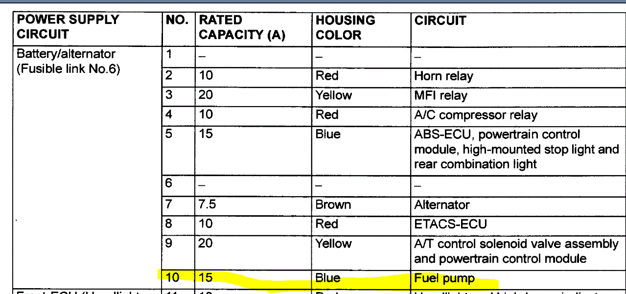

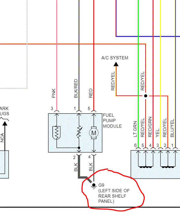

So I replaced the fuel pump to my car and come to find out there is no power to it. so I replaced the relays with ones I had off a parts same model car. I have and I still have no power to my fuel pump. So I’m wondering what can be causing the problem and if it can be a ground wire problem where would that be located?
Jun 24, 2020 at 2:47 PM
  • 110,248 POSTS

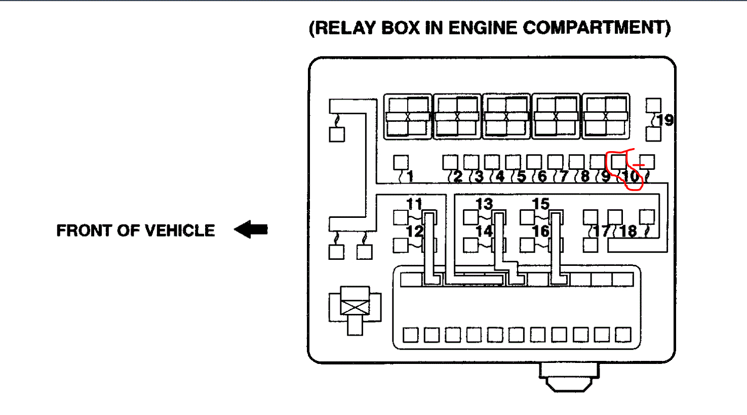

First, have you checked the fuel pump fuse under the hood in the fuse box? See pics 1 and 2. If you haven't check that fuse. In addition to checking the fuse, confirm there is power to it and out from it.
Also, if you look at pic 3, it shows the ground and location.
Let me know what you find.
