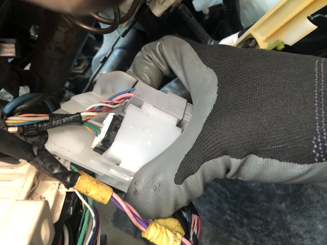

My fuel pump is not getting any power, neither with ignition on or when I’m trying to start my car. If I got wire the grey wire to the fuel pump the car starts perfectly..I need help restoring power to my fuel pump the right way. I am not comfortable with jumping the the fuel pump.

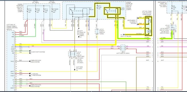

Good afternoon,
I attached a wiring diagram for you to view.
Do you have a test light or voltmeter to do some testing?
We need to some tests to see why there is no power.

Hey, I managed to check my car and the EFI fuse has power, ignition fuse have power, the yellow wire has a ground signal when I’m cranking. but the light green wire does not have any power.
May 14, 2020 at 6:47 AM
Okay, did you check the ignition fuse for power on both sides? This is a power test, not visual.
If there is not power to the light green, then either the fuse is bad or wiring between the fuse box and the relay.

Hey, I just want to update you. I had put this project on a pause. last week I manage to get the problem sorted out, and I would like to thank you very much. The connection at this plug was corroded under the dash near the steering column.
