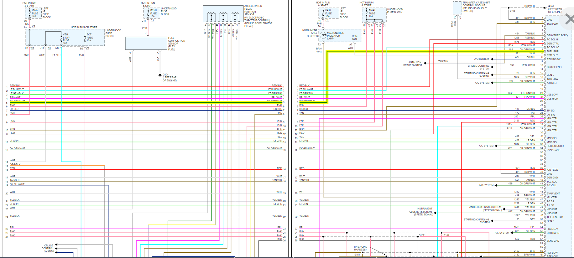

Can I just hotwire the fuel pump? I want to run a toggle switch to the fuel pump so I can turn it off and on with the toggle switch. can I do that?
Nov 2, 2020 at 6:41 AM
Good evening,

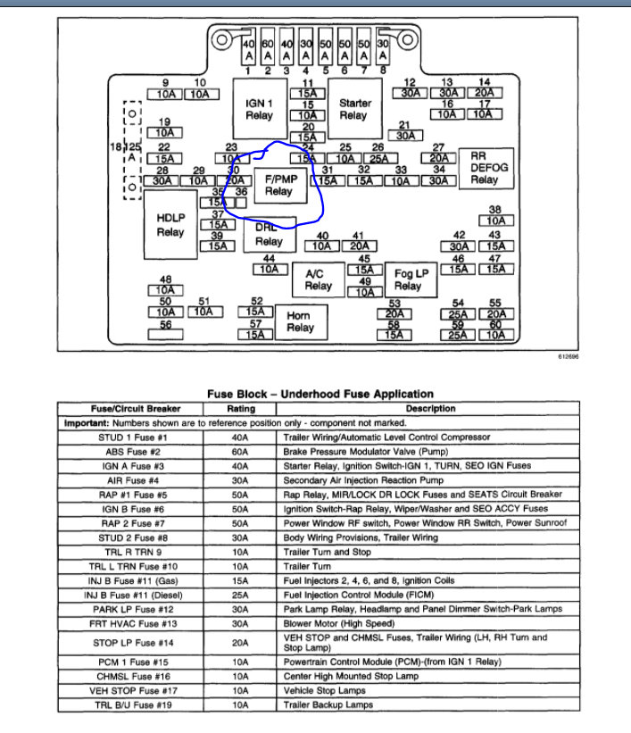

Yes, you could do it, but before you do that can you do a couple quick checks?

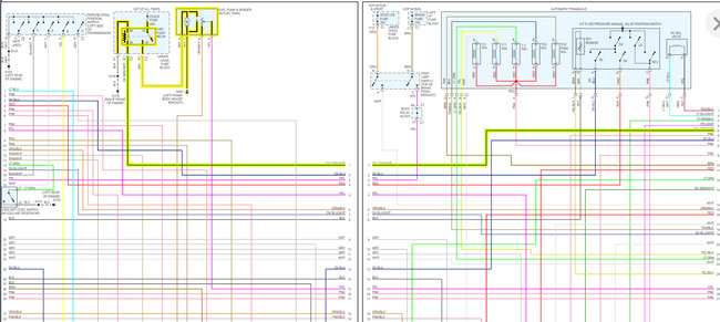

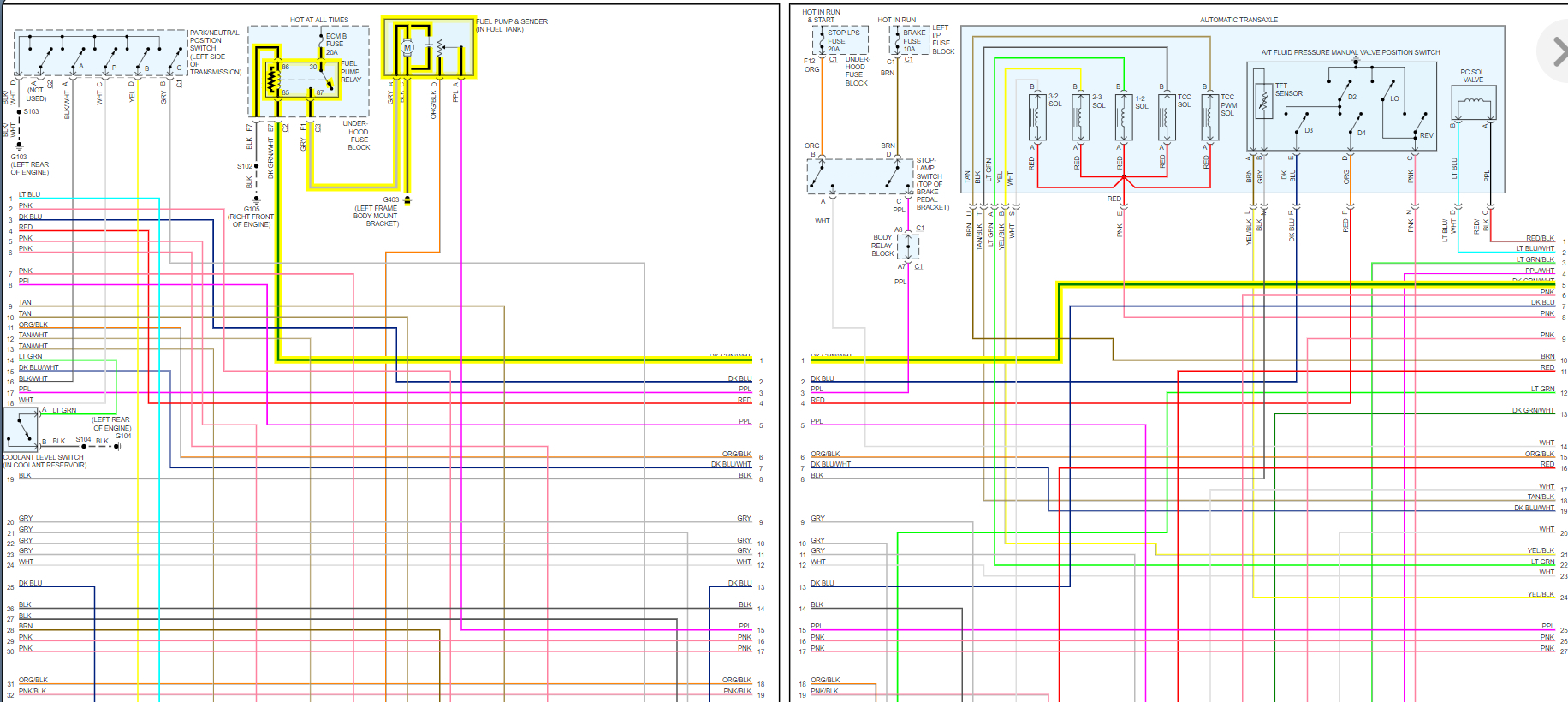

I attached the diagram for you to view of the fuel pump circuit. You need to go to the relay and do some testing. You need to verify voltage to the relay for operation.
Check for one terminal with voltage all the time. Then there should be another one that needs voltage only for 2 seconds when you turn on the key.
