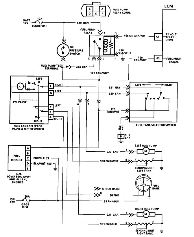

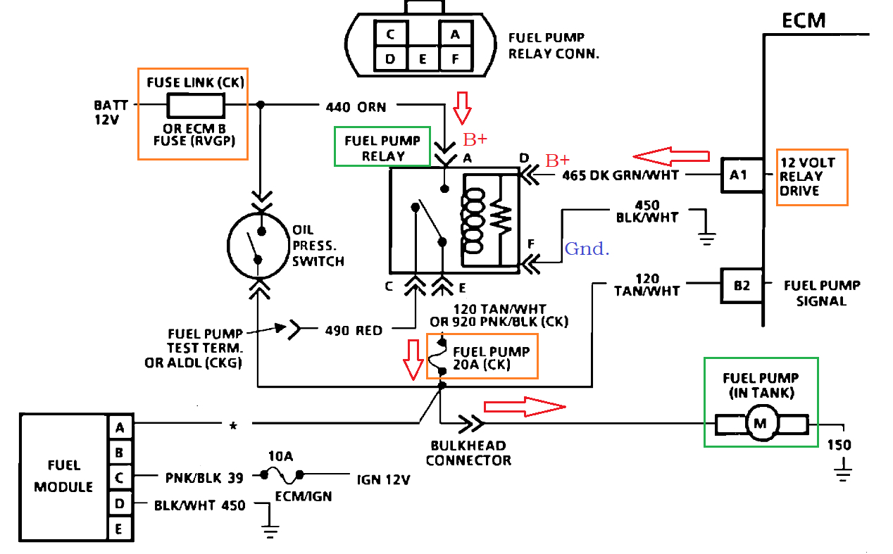

Hello, is there a reason you took out the Fusible links? And at the Fuel pump relay location if you take the relay out, you should have power to 2 of the pins when you crank the truck over. This system has the ECM sending 12volts to the relay control side which activates it. For the other relay pins, one goes to ground which is on the control side, so the ECM sends out 12volts and the other pin for that side is always grounded. You can check the ground by hooking at 12v test light to Batter positive and touching that pin with the relay out and it should light up bright, Ill post a diagram of the fuel pump relay circuit.
On these older trucks, the relay pins on the underside of the fuse/relay box tend to corrode and break off, and you will lose ground or power, but verify first that there is power (12v) coming from the ECM to the relay location with it out.

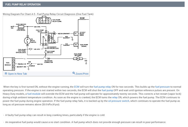

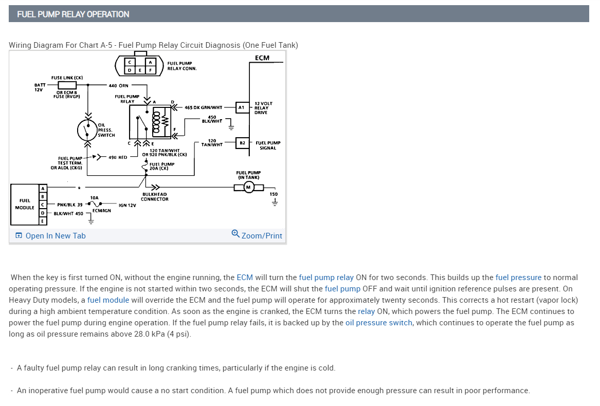

Here is some service info on the fuel pump relay operation. It looks like there is a 20Amp Fuel Pump fuse after the relay. Did you run direct wires when you took out the Fusible Links?

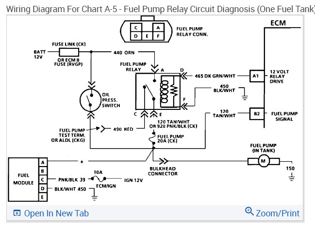

So, this truck has an oil pressure cut out switch to help save the engine if there is no oil pressure I would make sure the engine oil is clean and full and if so try to jump the connector at the switch to see if it starts, if so replace the sensor and also check the oil pressure of the engine. Here is the location of the switch and the fuel pump system wiring diagrams so you can see how it works. Please go over this guide as well:
https://www.2carpros.com/articles/how-to-manually-check-engine-oil-pressure-step-by-step-guide
Check out the images (below). Please let us know how it goes.
