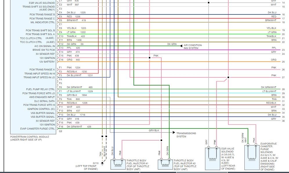

I have a the truck listed above 5.7 tbi. I can't get the injectors to spray. I have replaced ECM distributor ICM and still nothing. I can unplug the wire from the back of the distributor and ground one of those wires out and they spray. Yesterday I unplugged the wires to injector to see if i get power and put a test light in each end of wire and it lit up. So I plugged it back in and it ran do about 10 seconds and stopped spraying now no flash from injectors. I'm stumped. Before yesterday no fuses were blown but i didn't check them after it stopped.

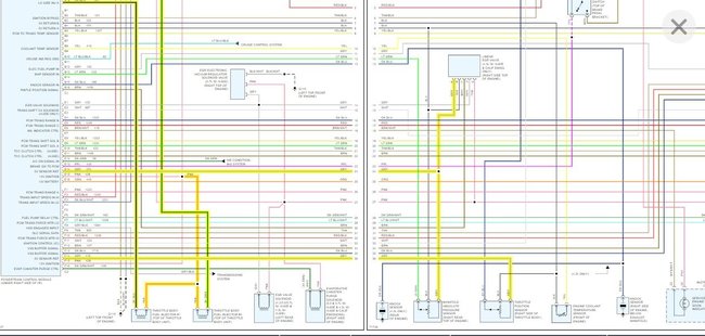

Good afternoon,
I thought I would help out as well.
The ECM should only provide 5 volts to the MAP sensor, TPS, and the EGR valve grey wire. If you have 12 volts, it is either a short in the harness to the 5-volt circuit or a bad ECM.
I attached a wire diagram for you to view the system.
Oct 25, 2019 at 1:36 AM

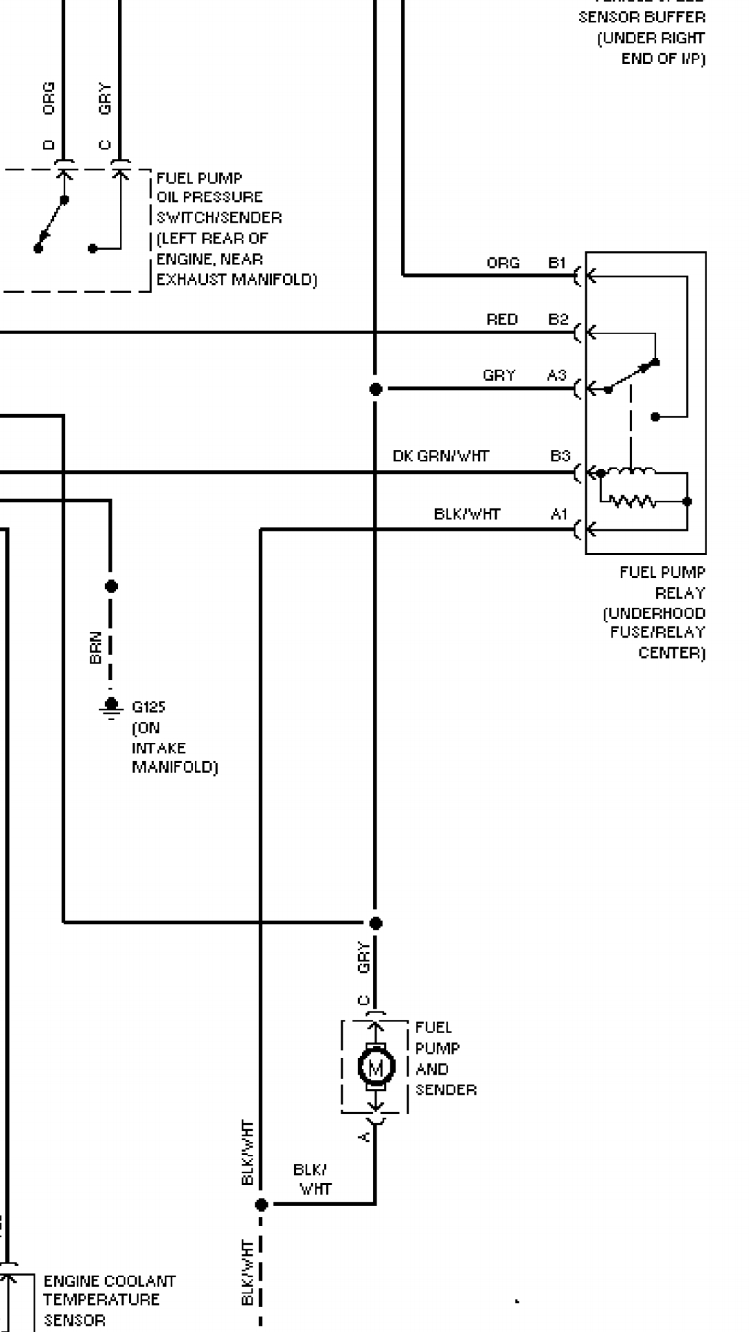

Okay, are you getting 12v to the fuel pump while cranking? Here's some diagrams to check it correctly: https://www.2carpros.com/articles/how-to-check-fuel-system-pressure-and-regulator
Oct 27, 2019 at 4:49 AM

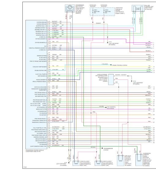

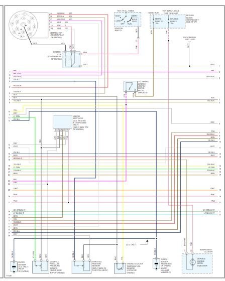

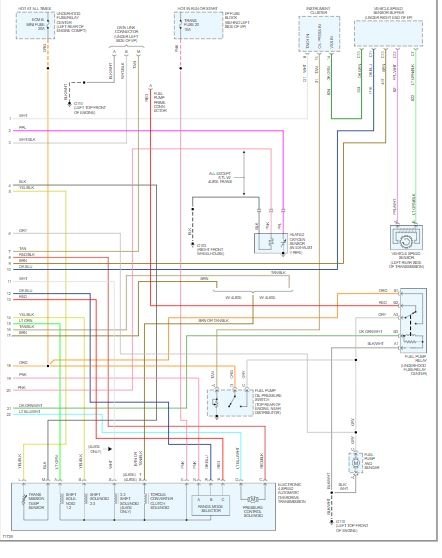

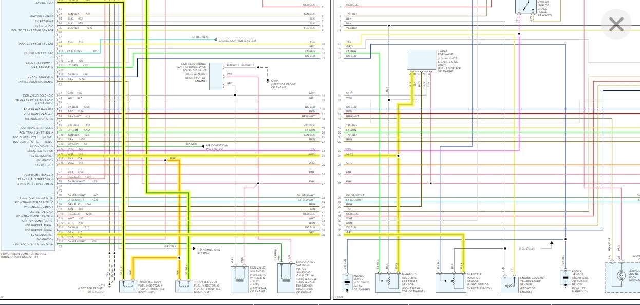

Also, check the end wire on the EGR. I sent you a diagram that included the EGR. It should be 5 volts as well.
Oct 27, 2019 at 5:04 AM

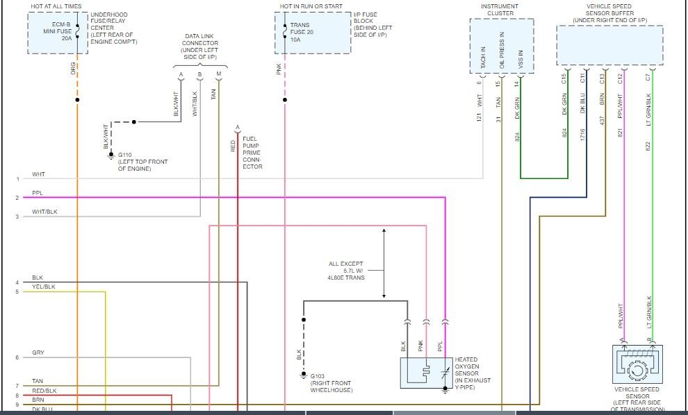

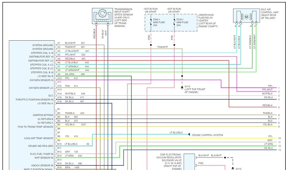

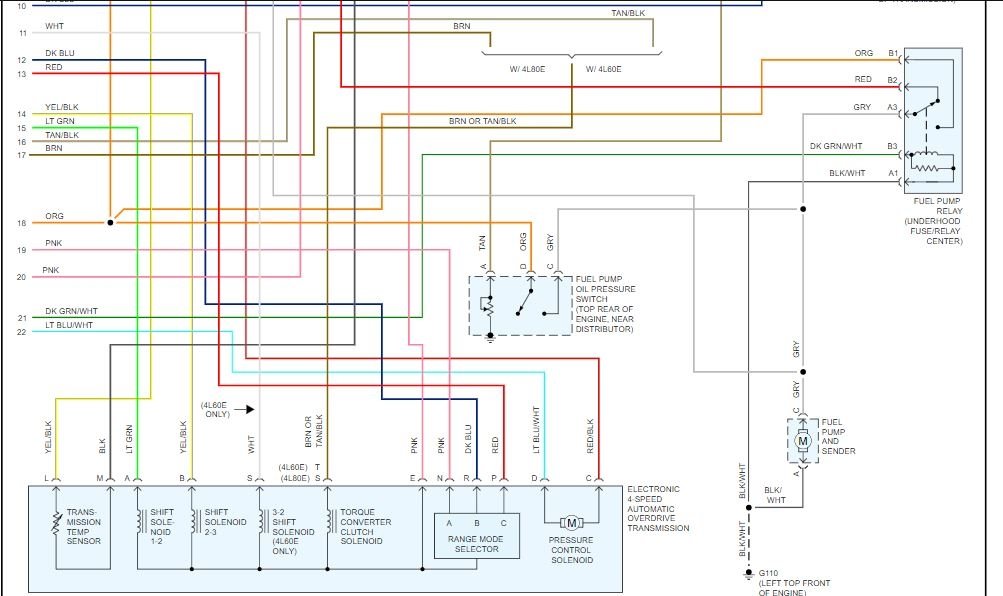

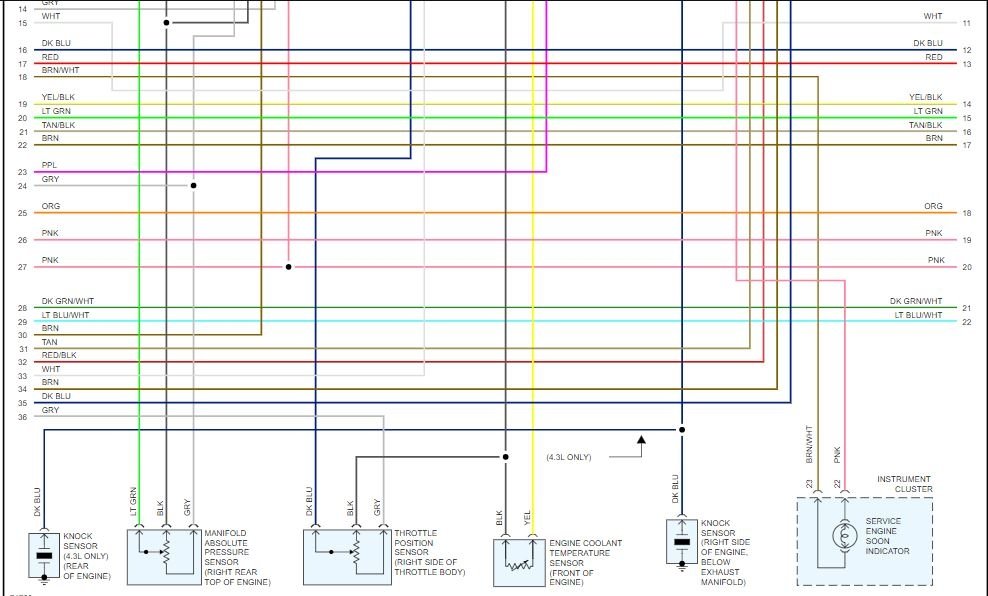

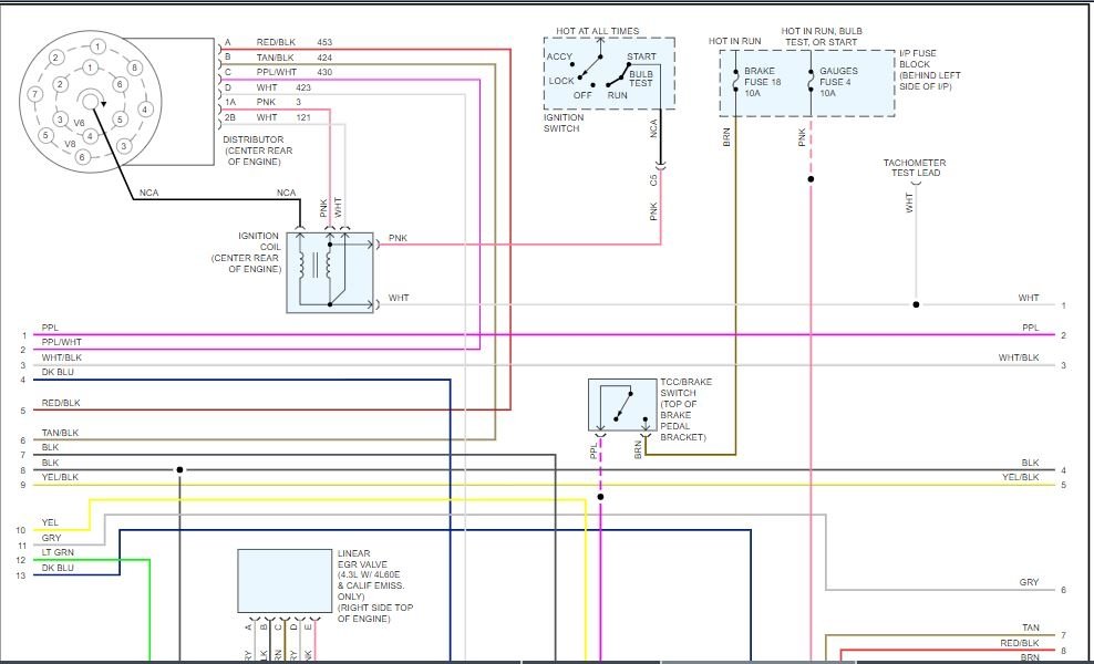

I sent you the complete diagram for the power train management system. There are 3 parts.
Let me know if you have an issue reading them.
Oct 28, 2019 at 1:22 PM
I blew up the diagrams for you so you can see better.
Oct 29, 2019 at 9:39 AM

Yes, I have 12 volts to fuel pump and no voltage at a4 where EGR comes from computer.
Nov 2, 2019 at 5:07 AM
That should be 5 volts and comes from the ECM.
Can you check the map sensor gray wire and see if that has power?
Nov 2, 2019 at 5:23 AM
DIRTY_95
  • 12 POSTS
Yes 5 volts on grey wire on map sensor.
Nov 2, 2019 at 5:31 AM
AL514
  • 5,668 POSTS
Are you getting a pulse with your test light on the purple/white wire at the distributor while cranking? It's the reference high signal to the ECM. Needed for injector pulse.
You have a wiring issue. The gray wire at the map sensor is the same wire. There is an issue in the harness where they come together. I would check the harness carefully for any damage. You may have a break inside the harness.
