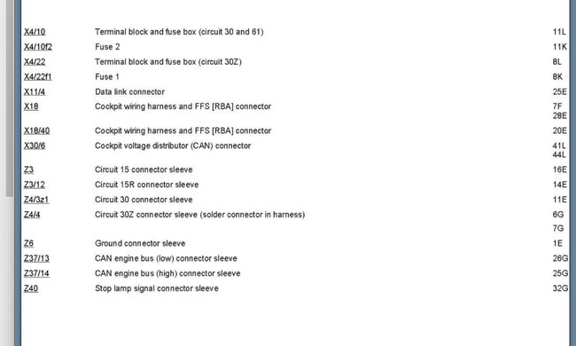

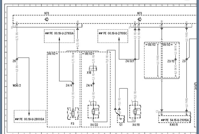

no crank no start no power to EIS my scan tool get power but i get error message not connected also cigar lighter no power.going to autozone test battery b4 i buy one tric

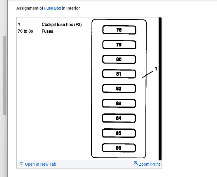

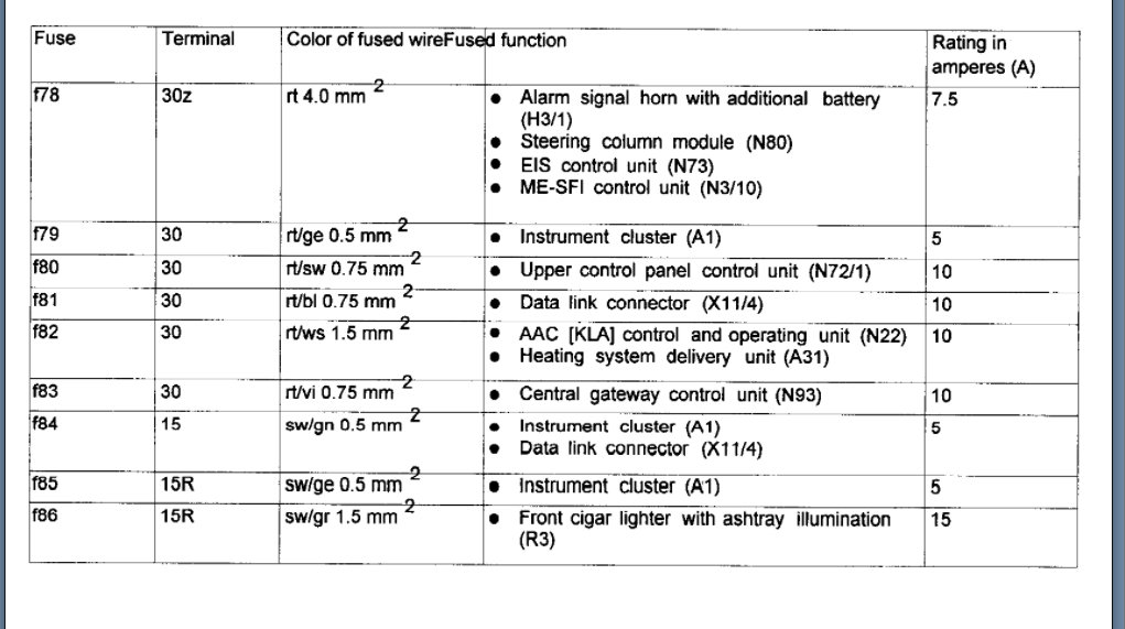

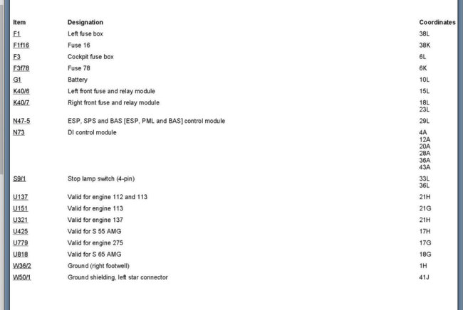

We need to start with checking fuses in all fuse boxes but focus on the interior fuse box and fuse 78.
If the fuses checkout, then we need to start with jumping power to the EIS and find out if it is able to power up. If it can then this may solve all the issues however, this really sounds like a fuse issue so let's run through these and see what turns up.

Hello again. So, this past weekend a friend and I well he had applied 12 v (he couldn't remember which fuse he did) that have no power 78,79,80.at both sides of fuse no power. When he applied 12 v then i turned the key to start the fuse blew. it was a 5 amp and a 15 amp do you think the EIS has an internal short at the start position? also need to verify if there is a constant 12 v going in EIS. Can there be something turned around (polarities) so when i turn the key to start it causes a short? just a thought.
