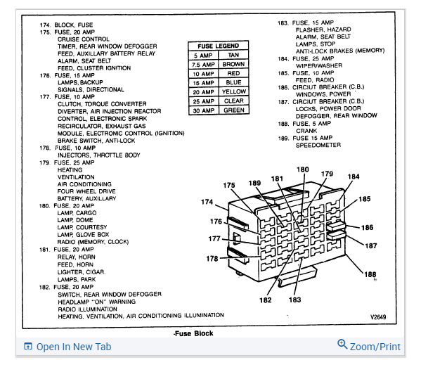

My truck will not start due to electrical issues. All of my fuses under the dash appear to be good but I'm not getting voltage to the ECM-IGN fuse and a couple of others. I had just fixed a wiring issue with my headlights and now those work, but my truck won't start. Did I maybe blow the main fuse that's for ignition? Looking for a wiring diagram from the battery to the fuse block for the ECM fuse.

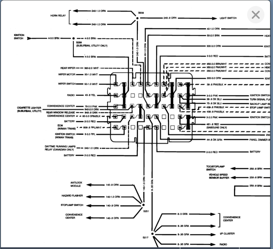

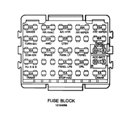

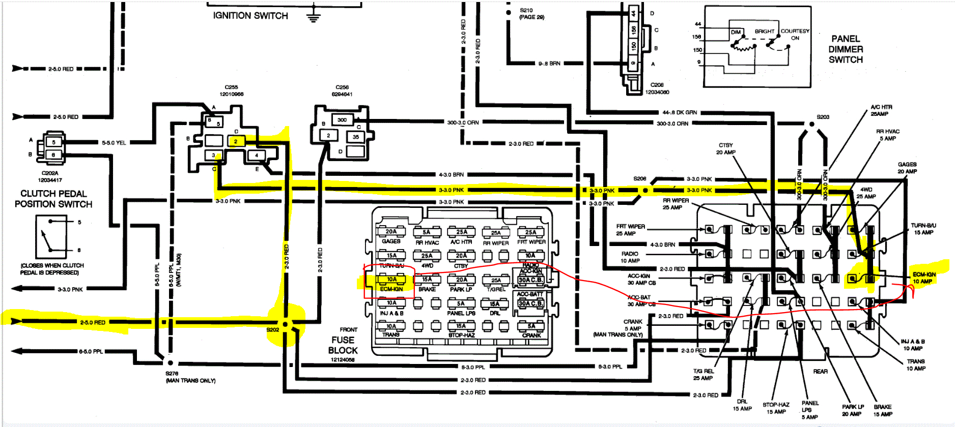

That is interesting.

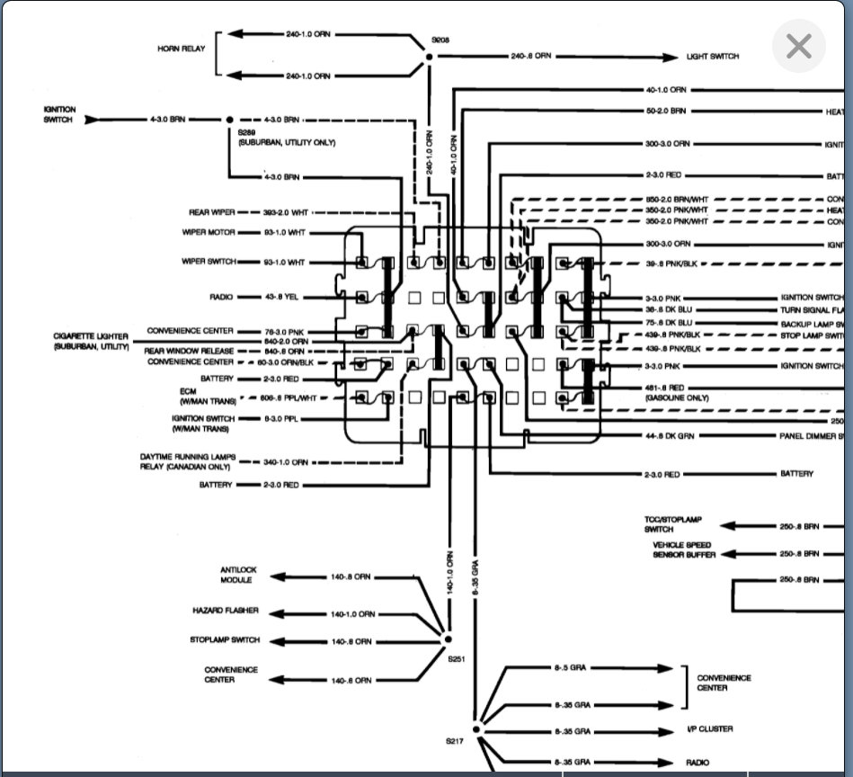

Take a look at the info below. I am wondering if the 3 fuses above the ignition fuse have power.
If not, then we may have an issue with the power feed coming into the fuse block for those fuses.
Basically, this is fed from the ignition switch so does anything else work when you turn the ignition on? Meaning does the radio work when you turn the ignition to the on position?
If it does then we must have an issue with the fuse block itself. As you can see from the last diagram the three fuses are tied together so there must be a break in the link between the fuses.
Run through this and let us know what you find. Thanks

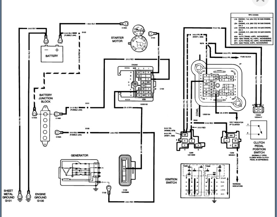

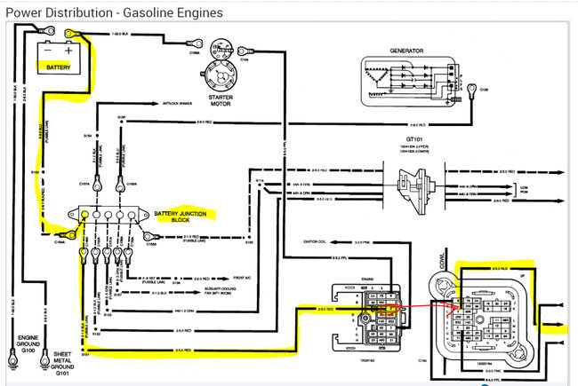

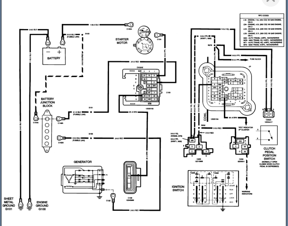

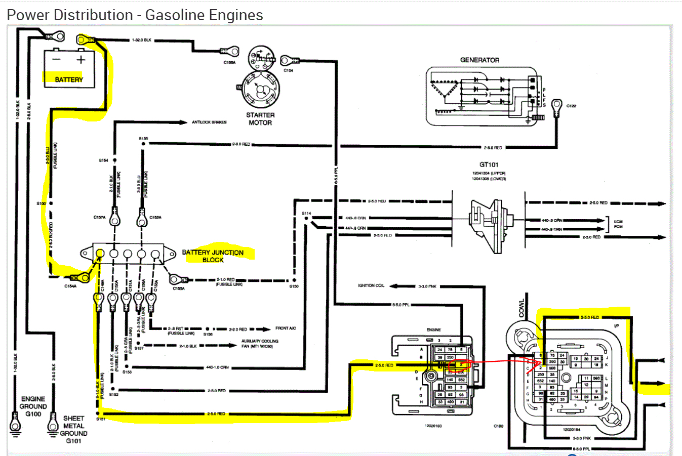

I was able to find an OEM schematic and highlight it for you. Power from the battery goes to the battery junction block. If you have power to other things, the fusible link between the battery and junction block is good.
Next, it goes from the junction block to the main connector in the engine compartment pin 2. This is another fusible link. Check for power at pin 2 in the connector. If you have no power, suspect the link.
From that point, power runs into the cab via the large connector on the cowl in a few different directions, including the ECM-IGN fuse. Note: The same power supply is for the turn signals, backup lights, and gauges. Do they work? They take power from different fuses, but they receive power from the same initial point. If they work, it sounds like the fuse box may be bad.
Take a look at the pics below. I did highlight the wiring for you. Also, here is a link you may find helpful:
Feb 3, 2022 at 10:16 AM

Only have power to CTSY and Park-LPS fuses. I have power to the junction block. What's weird is that I tested continuity to see if the fuse was good and it was. Then I hooked up an m18 battery, + to just the fusible link and - on my multimeter and got voltage. I'm very confused because the wire appears to be intact but also doesn't get voltage from the battery even though it is a complete circuit. I am out of ideas at this point.

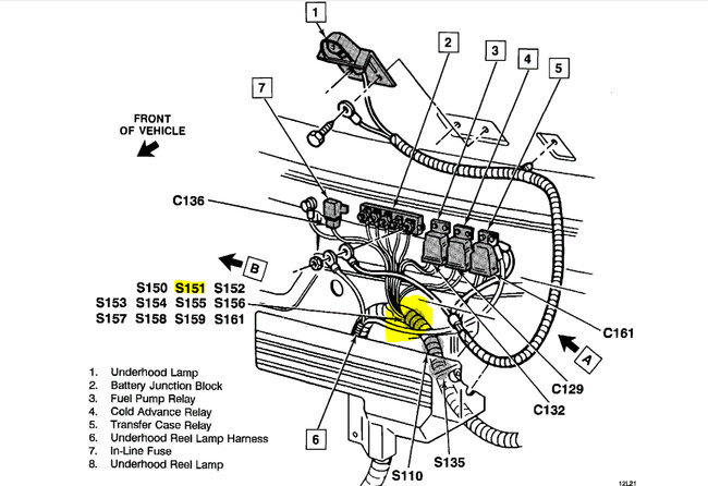

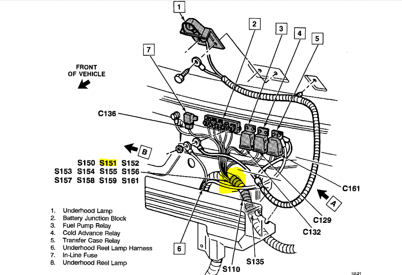

If the fusible link is good and there is power through it that doesn't make it to the fuse box, there is an open between the two locations. Have you checked the splice right after the battery junction box? Splice (S151) is one last place to check, and the bulkhead connector at the firewall could be open. Have you checked there to make sure there is power from the fusible link?
See pic 1 below for the splice I'm referring to. If the splice is good and the bulkhead is good, the last thing to do is disconnect the fusible link from power. Check for continuity in the wire starting at where the link gets power to the bulkhead. If there is little resistance and you have continuity, go to the inside of the truck, and do the same from the bulkhead connector to the fuse.
Let me know what you find or if you have any questions.
See pic below.
