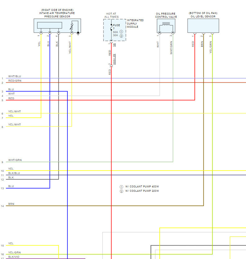

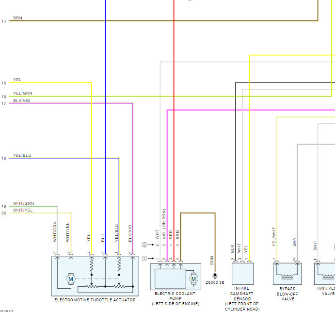

I bought this car with 90,000 on it. Keeps giving a message when run for a while that its overheating. No leaks, full coolant, fan comes on. Only code is cd9010, not much info online other than it could be the pump or wiring. I removed the coolant pump connector, whether car on or off thick brown has ground. Thick red has nothing. 2 small wires have some readings, one i think was 14.3 and the other 10.2 i think those are data and signal. Where does this power wire go to? I pinched it from up where it runs and still no power.

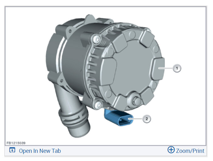

I am almost sure the alternator wire is shared but since there are no battery or charging issues not sure.

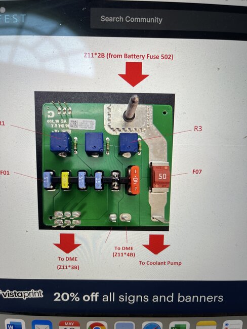

I followed the red wire and it goes to a distribution box on rear of engine compartment on passenger side, even though its sealed I opened it and connected it back, checked the fuses all good, but the 50 amp weird looking fuse only has power on one side, not the other, not sure if this is how it is. Some people said online that the 40-amp fuse is for coolant pump, but it has power.

Here are pics and video.

Thank you, yep, that 50-amp fuse should have power all the time, I would test the red wire at the coolant pump here is a guide to help, and if it has power check the ground at the brown wire. If you have both I suggest replacing the coolant pump with a new unit.
Here are the wiring diagrams for the pump so you can see how the system works. Check out the images (below). Please let us know what happens.

Hi, I indicated in my first post that the red wire at pump has no power. I am sure it is not the pump. And the brown has ground. That is why I am tracing the red one back to the fuse.

Does the power come from the back of the 50-amp fuse or its front?
May 17, 2024 at 5:18 AM
  • 110,248 POSTS
When you check the 50a fuse, it should have power at both sides. If it doesn't, the fuse is likely the problem. I couldn't tell in the video what you were pointing at.

A new power fuse box solved it. Thanks
