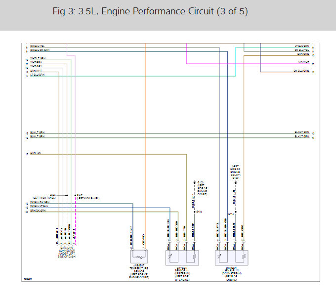

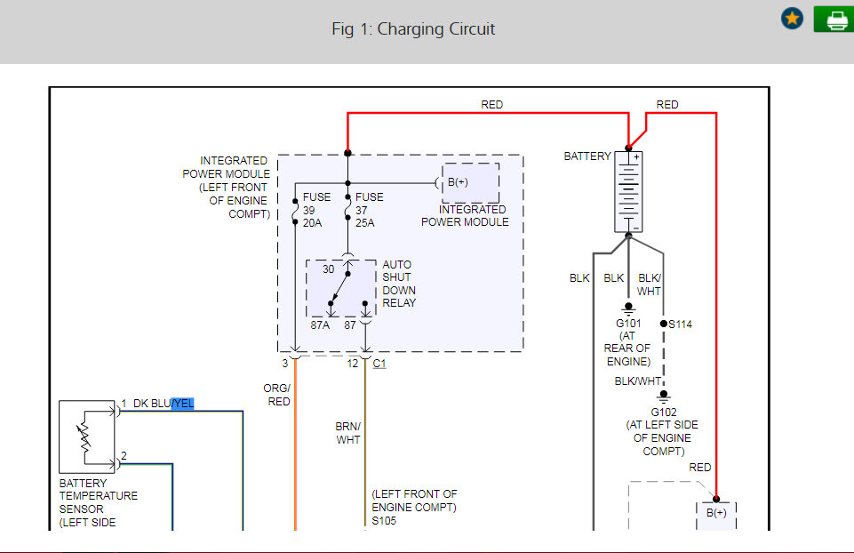

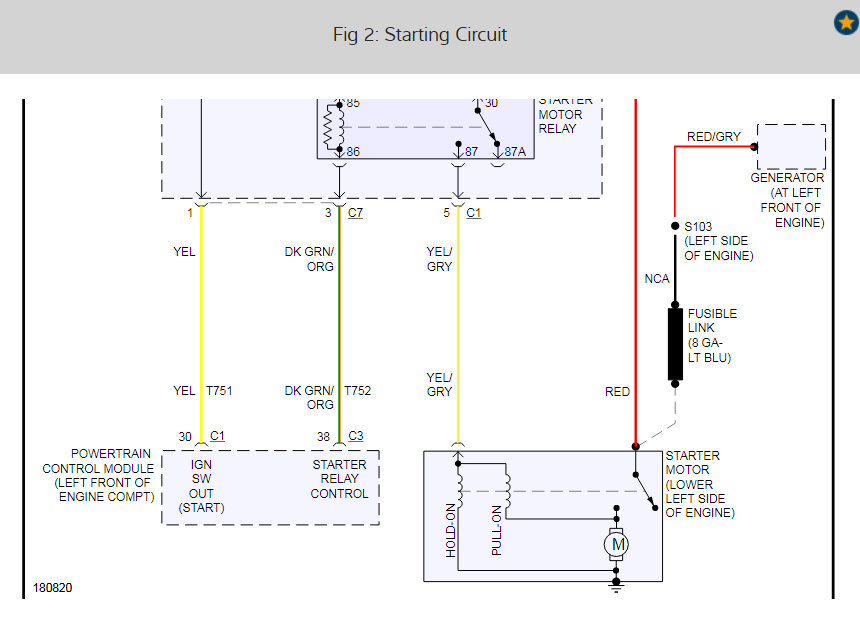

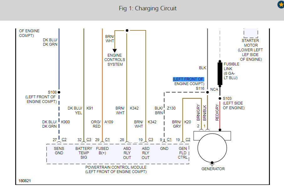

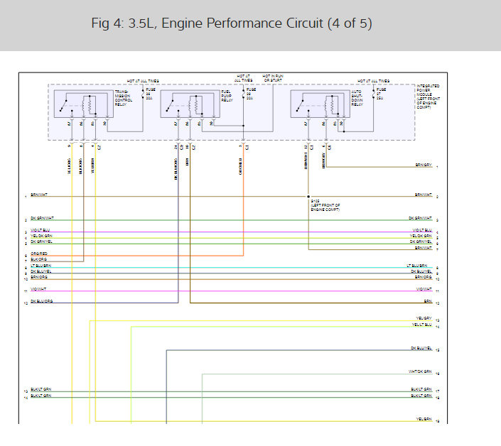

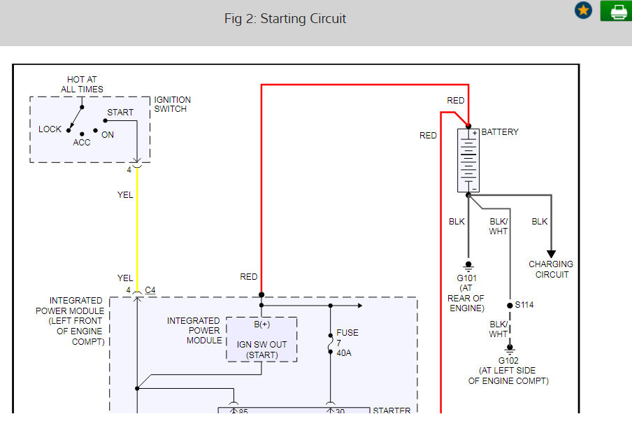

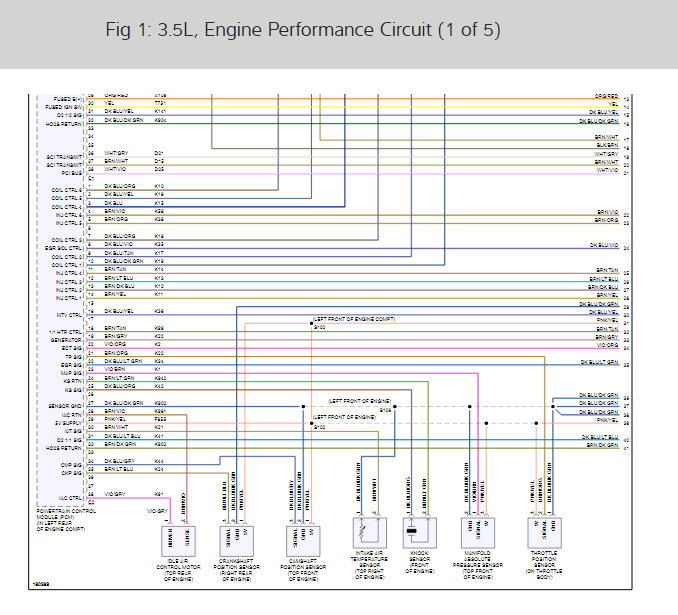

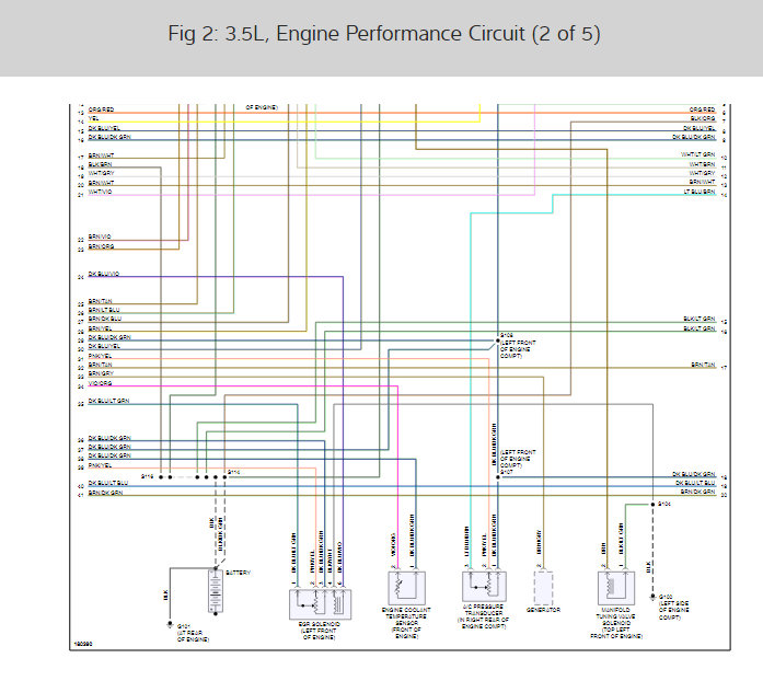

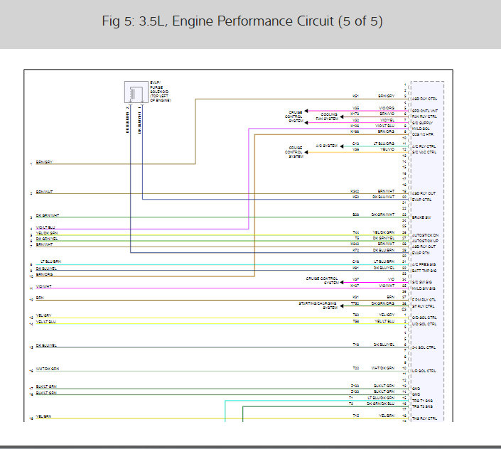

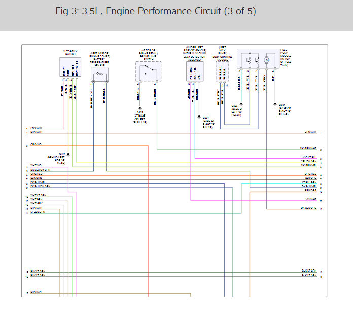

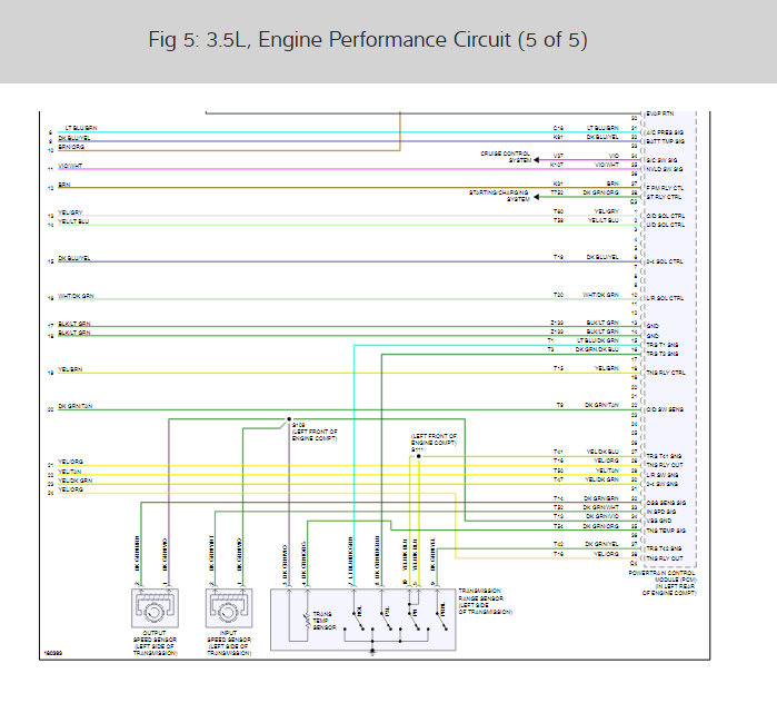

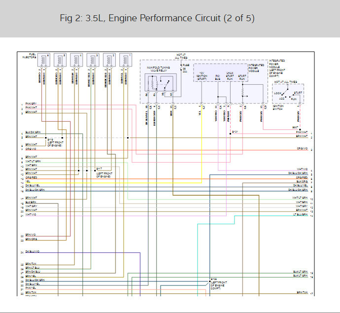

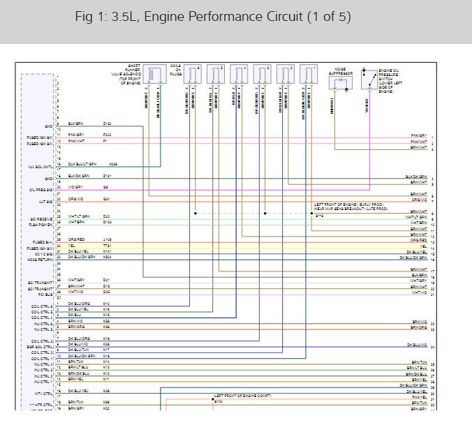

The reason the ASD fuse keeps blowing is because there is a short to ground in the circuit that the ASD fuse is protecting. Replacing the fuse will not the problem, it will just blow again when the ignition key is turned to "on" again. In the diagrams down below I have included the wiring diagrams for the charging/starting circuits as well as the engine performance wiring diagrams for you. I have also included a guide for you on how to find short to grounds in an automotive electrical circuit. Please go through these guides and get back to us with what you are able to find out.

Thanks Alex. Those color coded diagrams do help a lot. I suppose i will start unplugging things and do a process of elimination. I will update you on my progress. Thank you again!

So far I have not been able to locate the short. I pulled the plugs from the fuse box and ohms tested the circuit from the hot side of the ASD fuse to the pin output.. 88 ohms of resistance. Am i on to something? It seems there should be almost zero resistance. My thought is, can i put a jumper wire to the brown/white wire and bypass the actual plug to avoid the fuse box if there is a problem with it?
Aug 8, 2019 at 5:50 AM
SCGRANTURISMO
  • 4,897 POSTS
It would just be easier to replace the ASD Relay. If you pull the relay out and look it will either be a 4 Pin or 5 Pin Relay. Either one is available at any auto parts store for $15.00 to $20.00. If you are referring to bypassing the fuse, I would not recommend this in the least. The fuse is put there as a circuit protection device. If you have a short to ground without fuse protection you can damage/destroy the component in the circuit, do spot welding where ground occurs, and risk an electrical fire that can destroy your whole vehicle. Please get back to us with what you are able to find out.

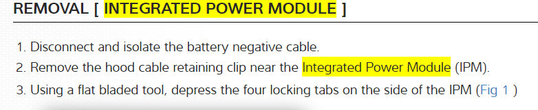

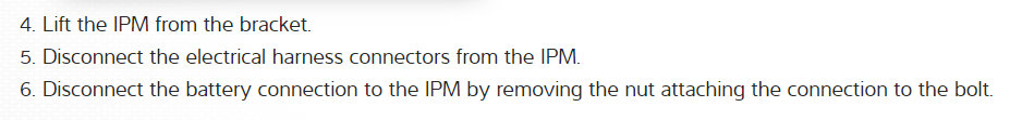

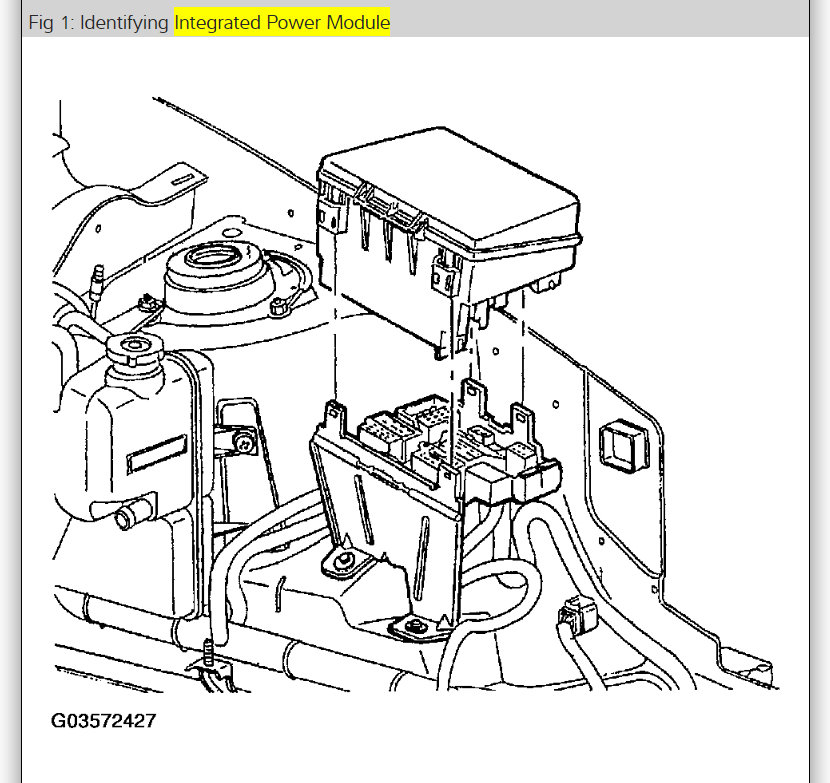

All grounds must be connected from the battery to the engine and to the frame/body of the car. This sounds like the TIPM is bad which is common. here is a guide to help replace it which is easy because it self initiates. Check out the diagrams (below). Please let us know what happens.

A straight circuit should have no resistance, it sounds like you found the problem. can you circle the circuit on the wiring diagrams and post it so we can see?
