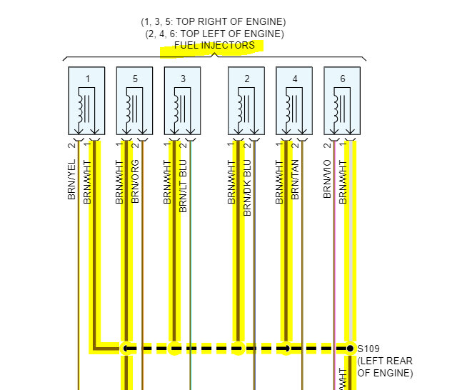

For the injectors to spray, they must be getting power and a ground path from the PCM.
When you turn the key to the run or start position, power should be present at each injector. To complete the circuit and actuate an injector, the powertrain control module (PCM) provides a brief ground path. If they are spraying all the time, power is present and it sounds like the PCM has failed and providing that ground at all times.
If you look at the pic below, it shows the injectors. Note that each injector has a brown wire with a white tracer. Once the key is on, there should be 12v present at each injector via those wires.
Let me know if that is what you have.
joe
See pic below.

So, they do have power at the brown/white wire for about 2 seconds when I turn the key on. Injectors 2, 3, and 4 spray as soon as you turn the key to on then shut off after 2 seconds. I found a couple of possible shorts which I fixed. Injector 3 stopped spraying now it's just 2 and 4. Also someone replaced the transmission and now it won't start because of the open injectors.

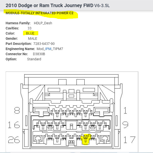

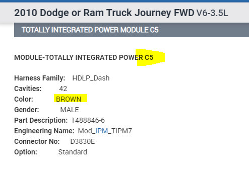

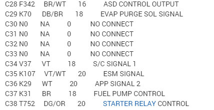

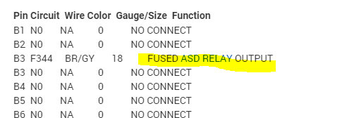

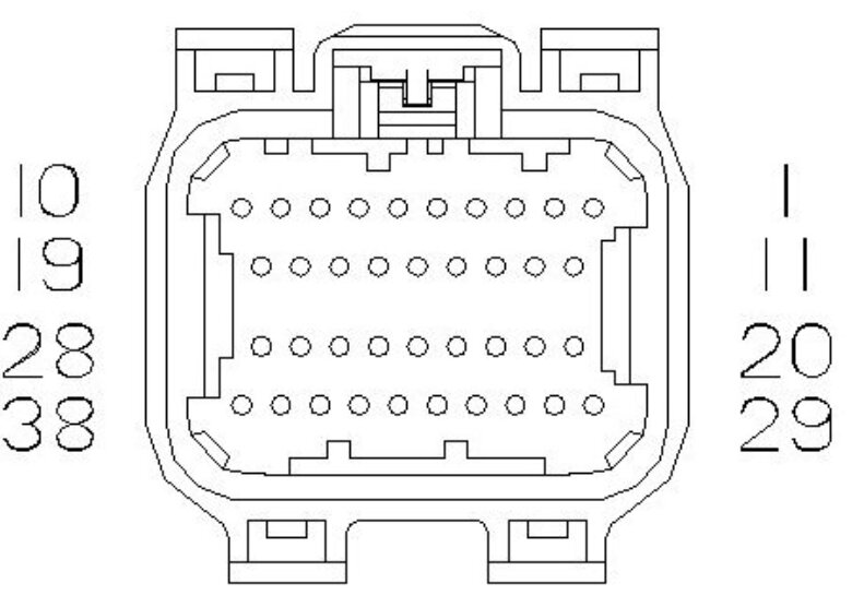

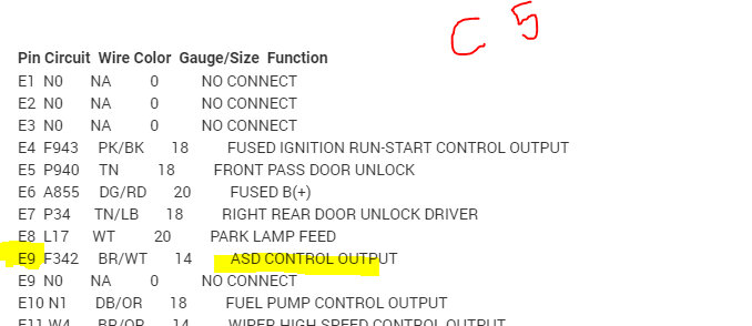

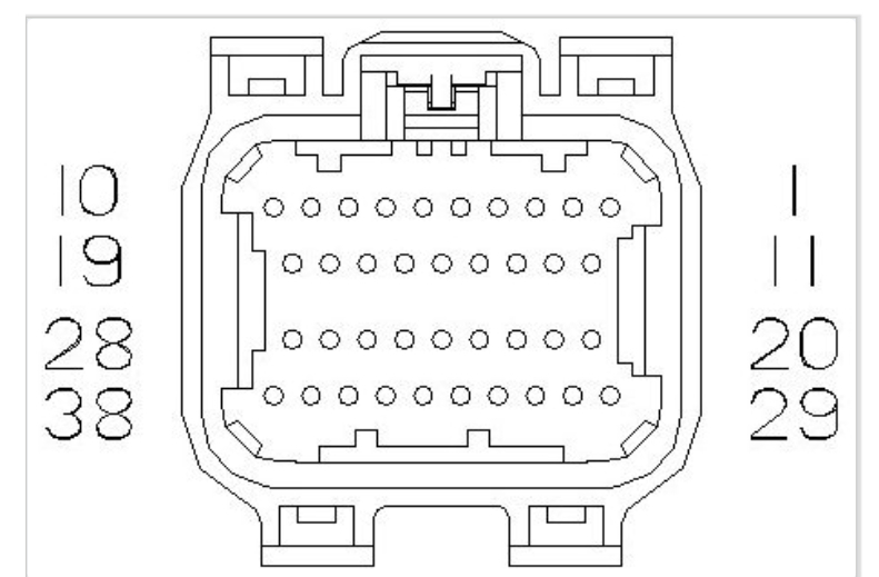

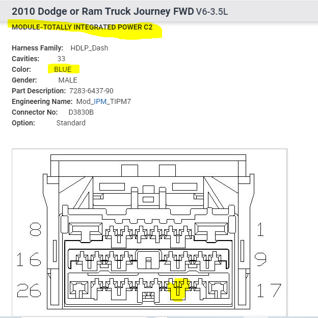

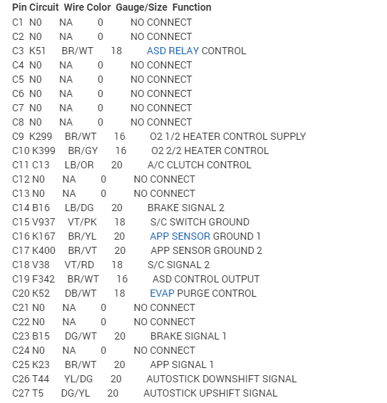

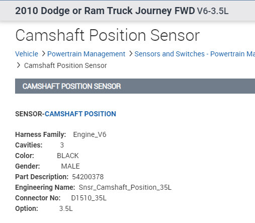

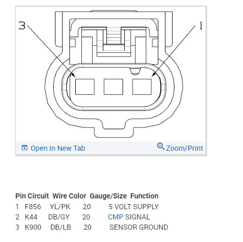

I have a feeling I know what is happening. This vehicle has a totally integrated power module (TIPM). They have connectors that have (as far as I'm concerned) too many pins. As a result, the pins are small and prone to damage, corrosion, and breakage. I suspect that is where the short is.
The idea that you get power for a couple seconds and then lose it to the ASD is likely being caused by a poor connection that can't handle a load.
So, the TIPM is basically the power distribution box under the hood. Under the fuses are the modules. We need to check the connectors for damage or corrosion.
Before you start, disconnect the negative battery terminal. There are several different connectors. I attached several pics below. Primarily, we are looking for the connectors related to the ASD. I highlighted the connector numbers, the pin locations in the connectors, and a legend showing the purpose of the pin.
I suspect the TIPM is going to need to be replaced. A power supply that drops off is a common symptom with these when they fail. But the best thing to do is confirm there is an issue. It isn't a cheap part.
Let me know what you find.
Monday, September 11th, 2023 AT 8:23 PM

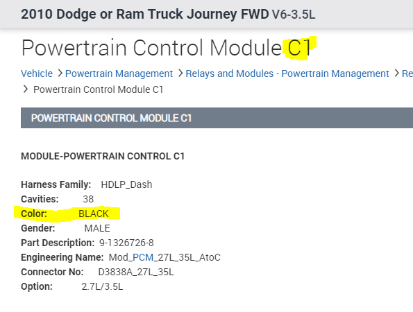

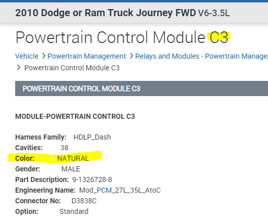

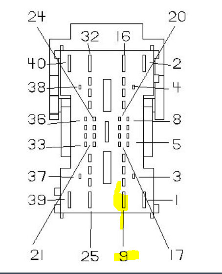

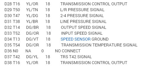

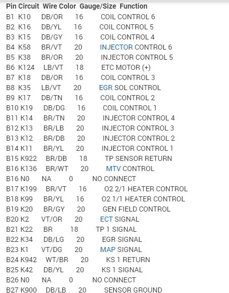

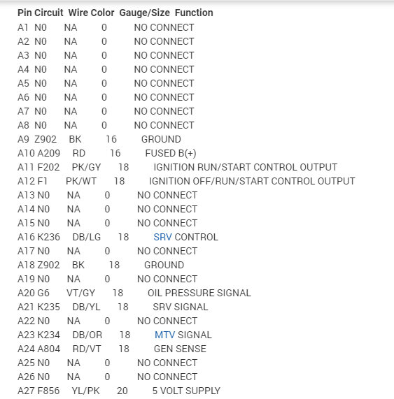

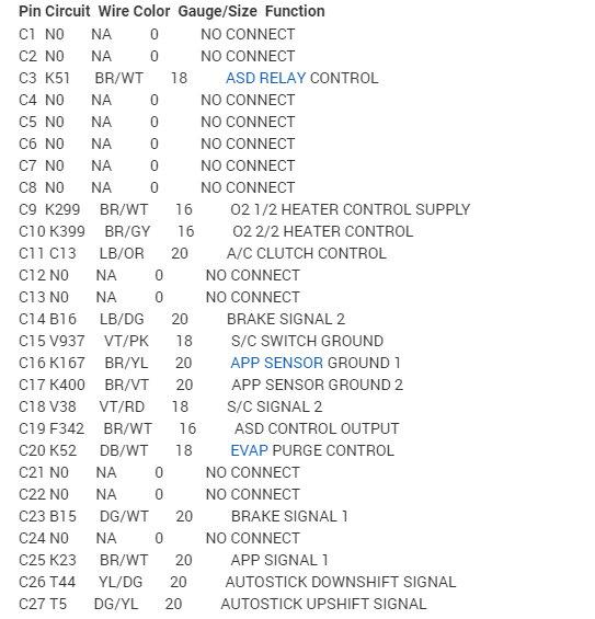

Okay, I will do that. Is there a diagram for the PCM connector to find the grounds? Thank you
Tuesday, September 12th, 2023 AT 5:24 PM

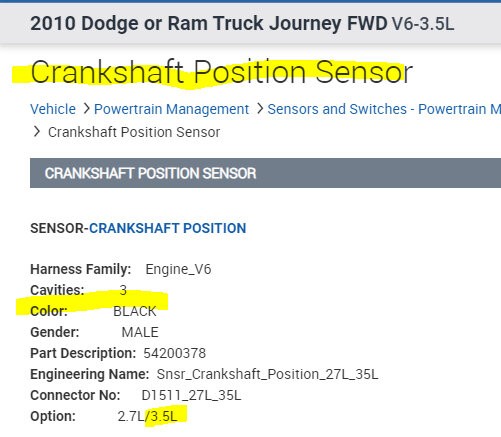

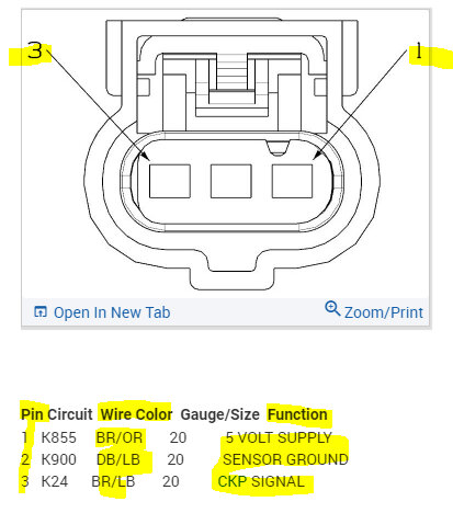

And also, a diagram for the CKS connector someone replaced the connector and I just want to make sure the wires are connected correctly. Thank you again.
Tuesday, September 12th, 2023 AT 5:33 PM

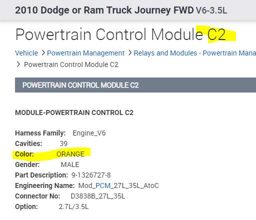

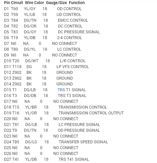

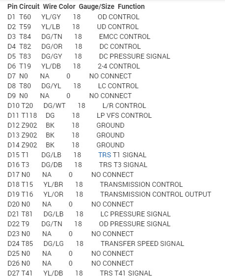

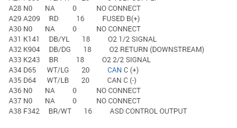

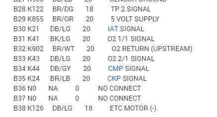

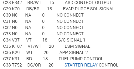

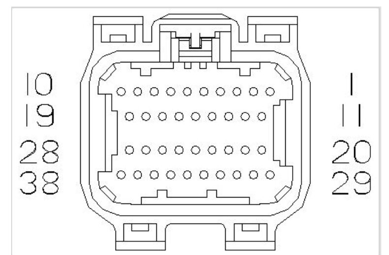

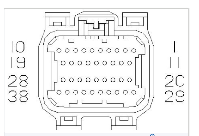

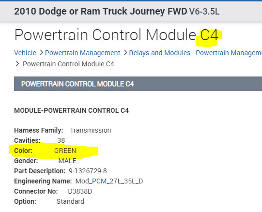

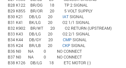

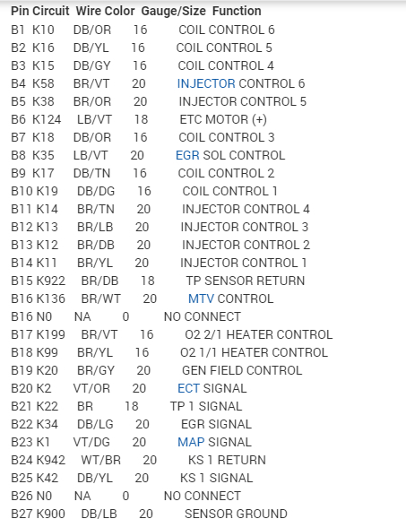

  • 109,772 POSTS

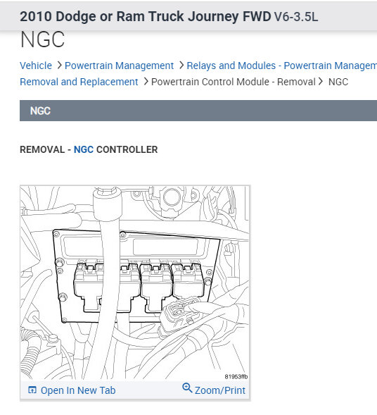

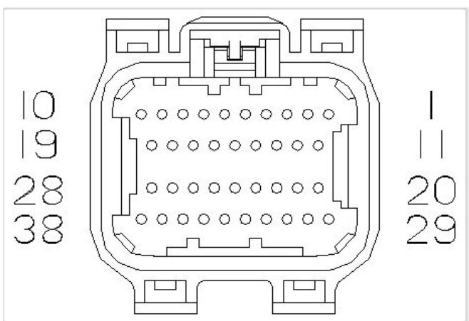

Absolutely! If you look below, the first two pics are for the crankshaft position sensor. The remaining pics are for the powertrain control module. (PCM)
There are 4 connectors at the PCM. Following the pics in order, I first attached the connector identification, the connector pinout, and then what each pin is for. Following them in order you will go each connector one at a time.
Let me know if this helps.
Tuesday, September 12th, 2023 AT 6:27 PM

So, I did I continuity test on all the injector wires and connectors and all of them are good but when I do it on the PCM pin out I get a reading on the multimeter, but it doesn't beep? Do you think it's the PCM then?
Wednesday, September 13th, 2023 AT 3:41 PM
  • 109,772 POSTS
If the PCM isn't providing a ground path when the engine is cranking, yes, it is likely the problem. However, if you are checking it without cranking the engine, there will not be a ground path.
Keep in mind that the connector at the PCM may be a problem, so make sure you check that as well.

  • 17 POSTS
I checked the continuity on the injector pinouts on the PCM and 3 of the 6 have continuity without cranking.
Thursday, September 14th, 2023 AT 1:26 PM

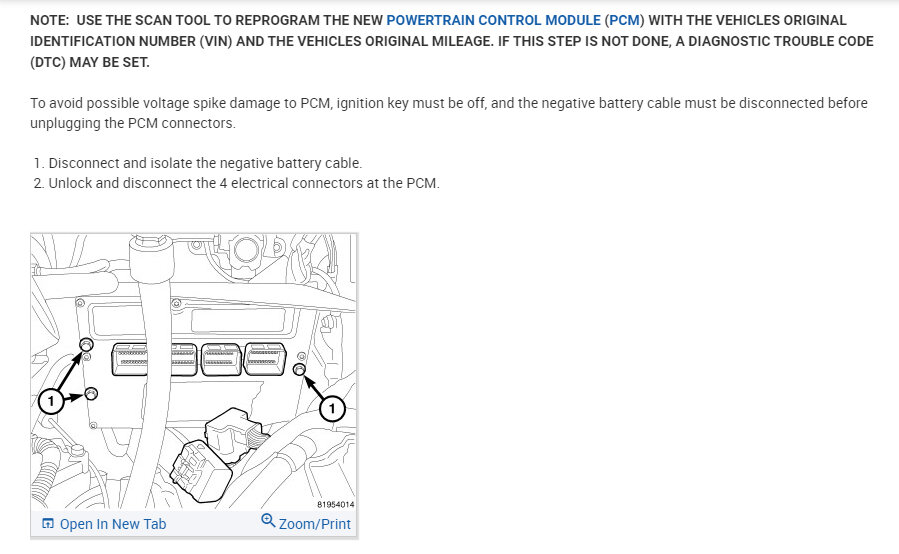

  • 109,772 POSTS

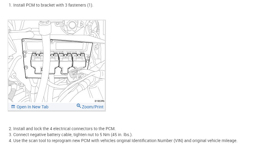

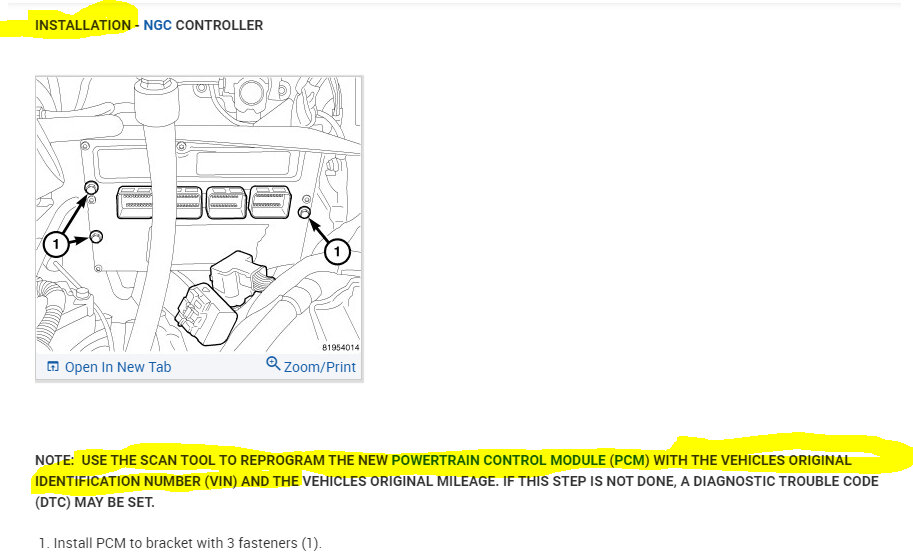

If you have a constant ground path at the PCM, it has an internal short. Just make sure the connector isn't the issue. If it isn't, replace the PCM.
If you look below, I provided the directions for the removal and replacement of the PCM.
Also, the new PCM will need to be programmed.
Thursday, September 14th, 2023 AT 6:57 PM

So, I got a new computer and that fixed the injector problem. The car starts now but the idle surges and jumps up and down. The lightning bolt light is on the dash and the throttle body starts clicking when I turn the key on. Could the throttle body be bad?

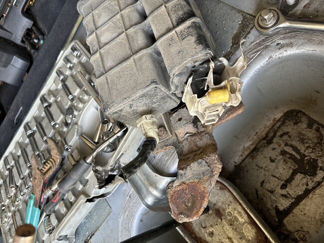

Where is the throttle position sensor located? And I have an obd2 scanner, but I don’t think it has the can option on it. The check engine light is on, but no codes are popping up on the scanner. And also, I found that the charcoal evap canister is completely melted and the lines going to it were melted off I’m assuming from the exhaust. Whoever owned it before cutting off the mufflers. Would that canister cause any issues? And thank you for responding.
Sunday, September 24th, 2023 AT 12:10 PM
  • 109,772 POSTS
The canister will cause evaporative emission system problems. Also, I suspect the vacuum hoses to it were melted as well, so that would have caused drivability issues as well.
The idea that the check engine light is on with no codes indicates either your scanner can't read the code type or there is a breakdown in communications between the modules and data link connector.
When the exhaust was modified, where was it cut? Are the catalytic converters still on the vehicle?
